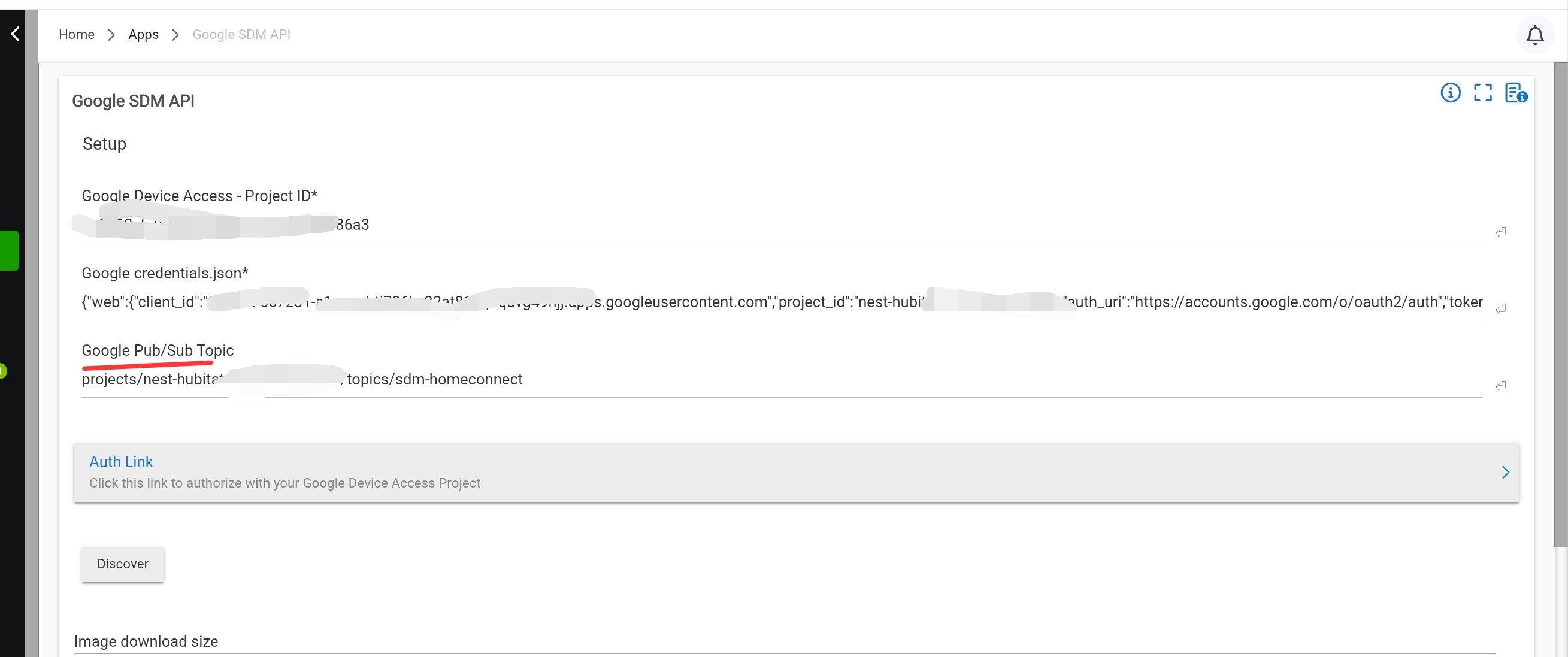

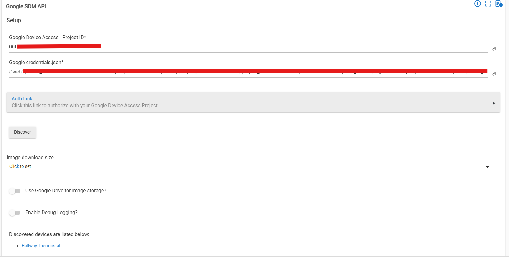

I don't if the cold meds or what. I can't find pub/auth on the Good SDM API page. It's been a while since I've installed this app. LOL
Yours looks different. Are you on the latest version?

It was the current version, but I reapplied the code and it popped up. Thanks! Everything updated with the new pub without issue!
