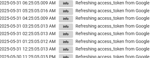

I believe that this integration should be safe from any such deactivation, as it uses the refresh token hourly to update the access token.
I don't think so mine say they will be deleted within 30 days and haven't had activity for over 6 months.
Mine refreshes hourly:

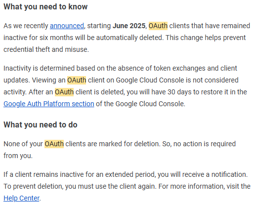

Did you get another email today on this? I never got one previously, but then received this one today mentioning they messed up sending the first email:
Ok, I see what you mean now. Clicking further, I see something similar for the Google Home Community OAuth in my portal.
Interesting... I got this email yesterday that indicated I was all good?
But I do see in my console that the "Last used date" is May 23, 2025... I'll dig in a bit more
Ok, I think I understand the insanity here. When the integration was creating in Hubitat, an OAuth token was created and shared with the Google portal to create the link. In the Google portal, another OAuth token was created, but was never used. That's the one that Google is flagging.
I deleted the one they ear marked for my Google Home Community integration, and it still just kept chugging fine.
Long story short, it seems you can just ignore their warning. They are removing dormant OAuth tokens that aren't being used.

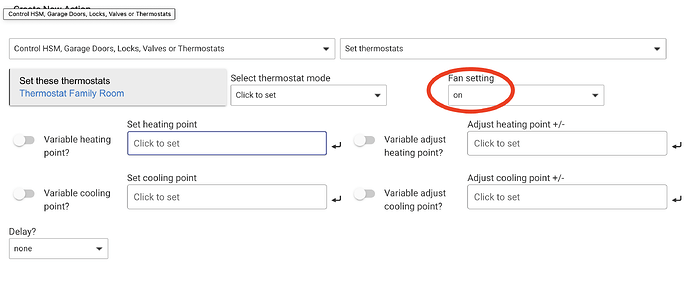

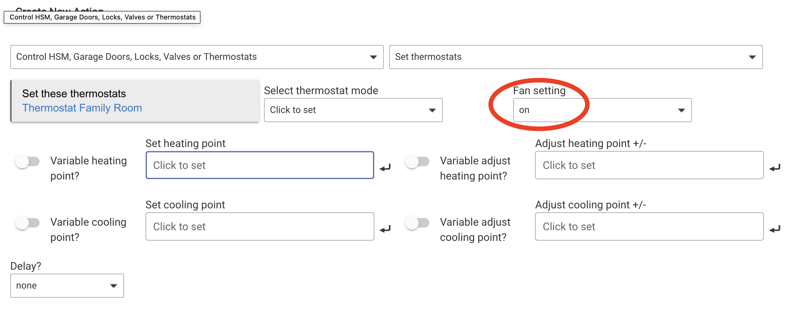

I've been trying to control fan on/auto on a cooling thermostat. While it seems I can do it from the device page, I cannot get it to work in rule maker, any ideas and why this may be happening?
This has been working for me in Rule Machine.

It seems that when the thermostat is completely off, RM won't send the fan on command ( I see it on the thermostat events page but doesn't actually turn the fan on) - I changed the rule to set mode to cool and fan on and that seems to work.
That might just be a Google thing (off means everything is off). Never tried it with the thermostat off, but great find on how to make it work!
