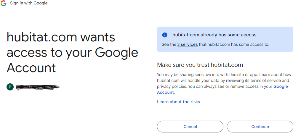

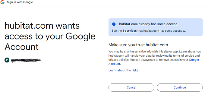

Yes, when I click on the Authorize button in the app, it comes with a "Google Next Permissions" screen. It shows both of my thermostats and I click on the sliders next to each to permit access.

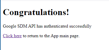

It then comes up with this screen:
I click ""Continue" and I get this:
It returns me to the app and I click the "Discover" button and nothing shows up.
