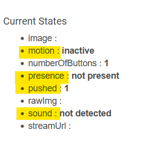

@dkilgore90 is the HE motion event triggered only by generic motion events in GH? Are animal and vehicle events excluded?
I'll experiment a bit but I don't want to have to get spammed with Google Home notifications just to trigger events in HE. It'd be easier to just get a dedicated motion sensor if that's the case...
So, I use the original wired Nest Hello. But, there should be separate triggers for motion and presence on the device. "Motion" is triggered any time there is any motion. "Presence" is triggered when it sees a face. But, it will not recognize the face outside of Google or Nest. These trigger regardless of whether they are on or off in the Nest app or Google zones. You can also trigger on sound and the button push if you want.
I use the "presence" for detecting motion events as I do not care about general motion unless there is a face involved.
Ya I get motion and presence events in HE. But it looks like vehicle and animal events don't cross over to HE even if notifications are turned on.
There is no specific mapping in the Google API for vehicle or animal events... But I would have hoped that these would at least be reported as a generic motion event...

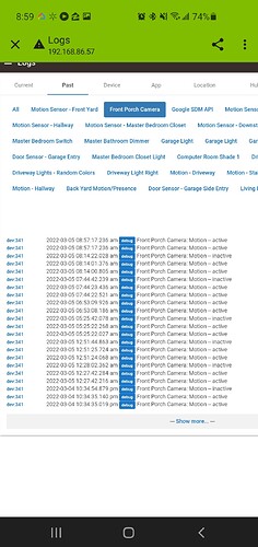

Sure. I'll turn all my notifications in GH back on. Can you confirm that HE events are based on GH notifications? That appeared to be the case when I was testing.
You need just the log from the camera in HE?

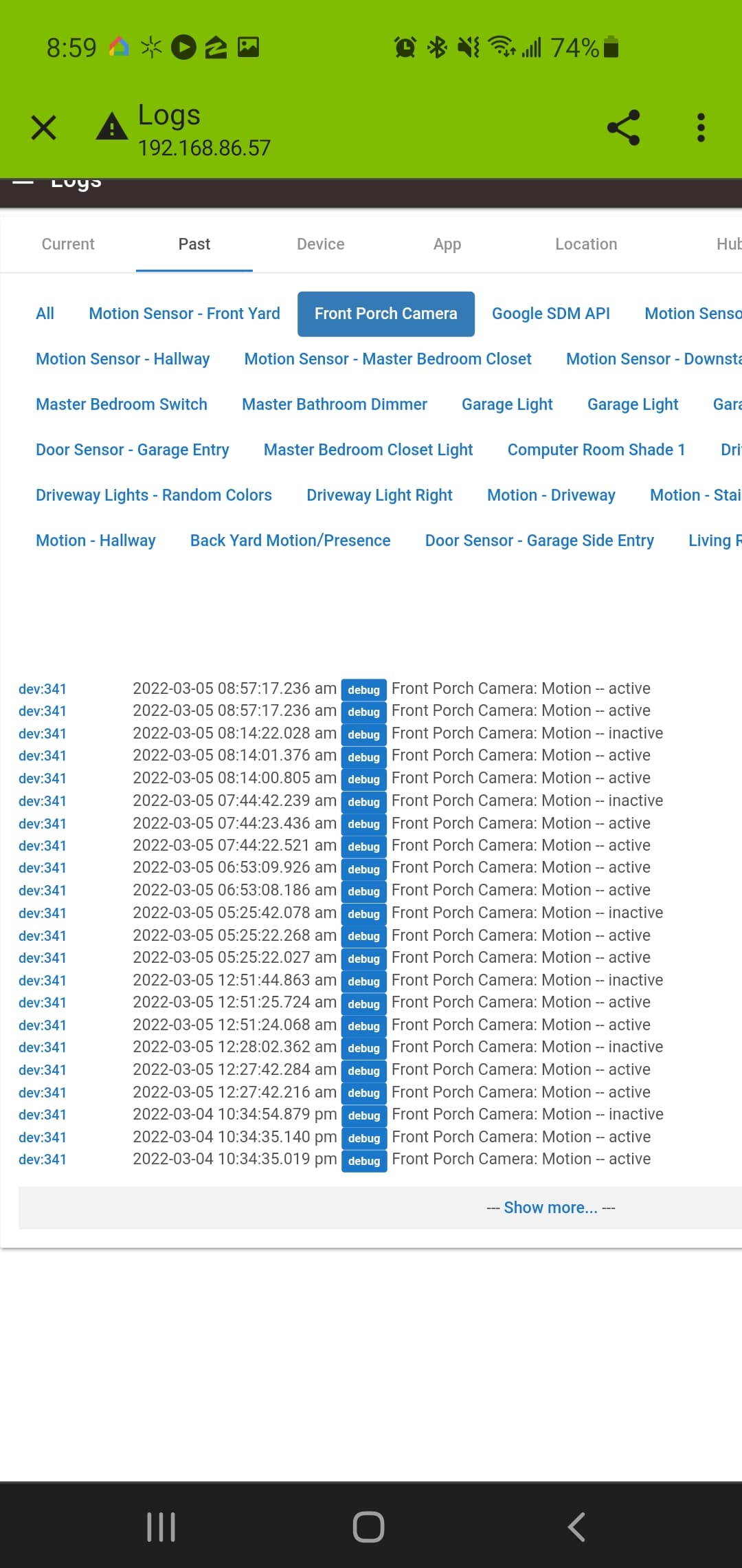

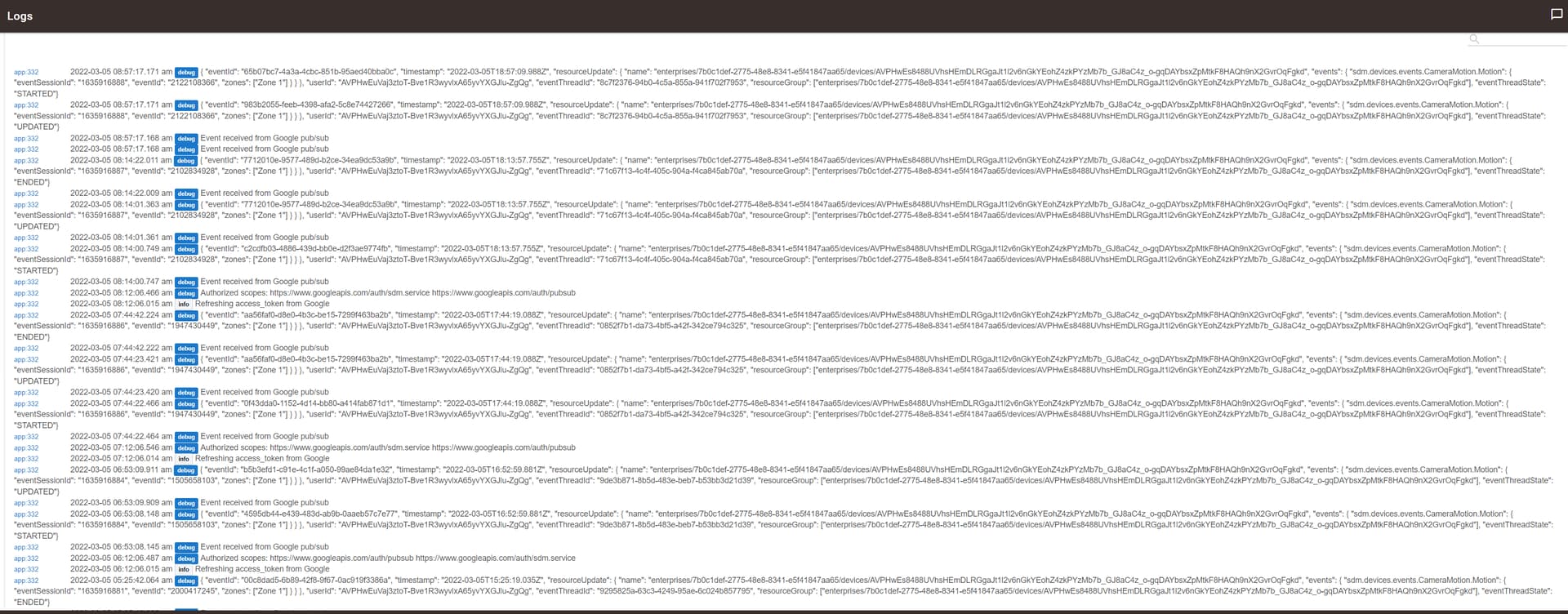

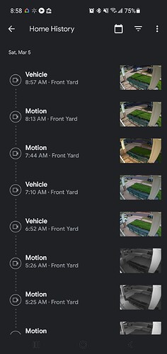

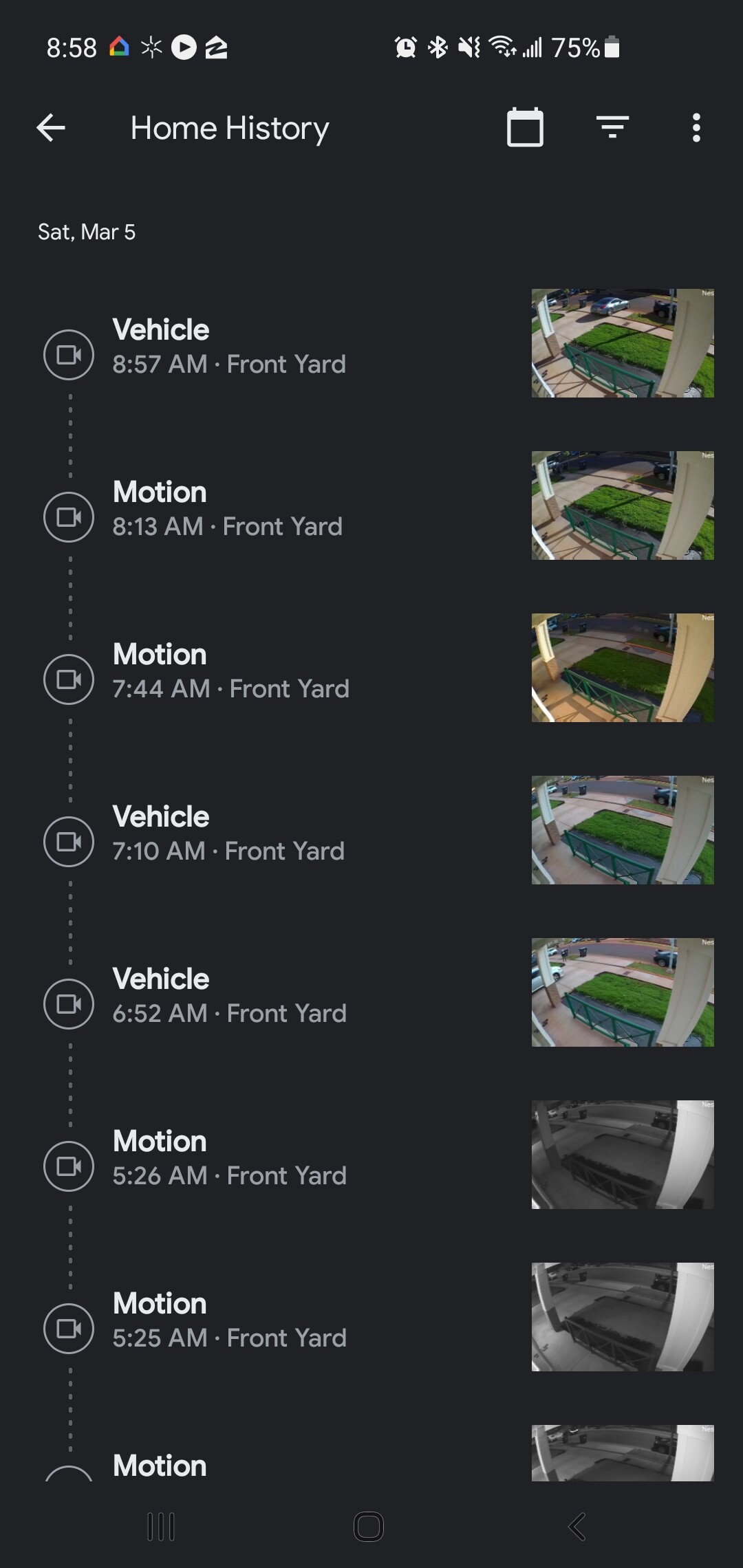

I was just comparing that with the GH event history to see what was and wasn't crossing over.

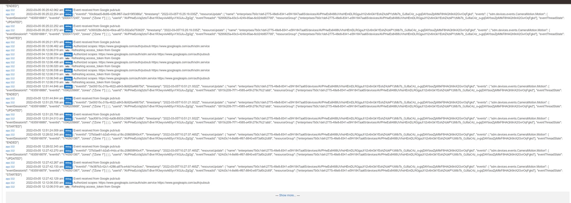

The bulk of logic lives in the SDM API app, so those logs (with debug enabled) would be of the most use.
It looks like some vehicle events crossed over while others didn't
