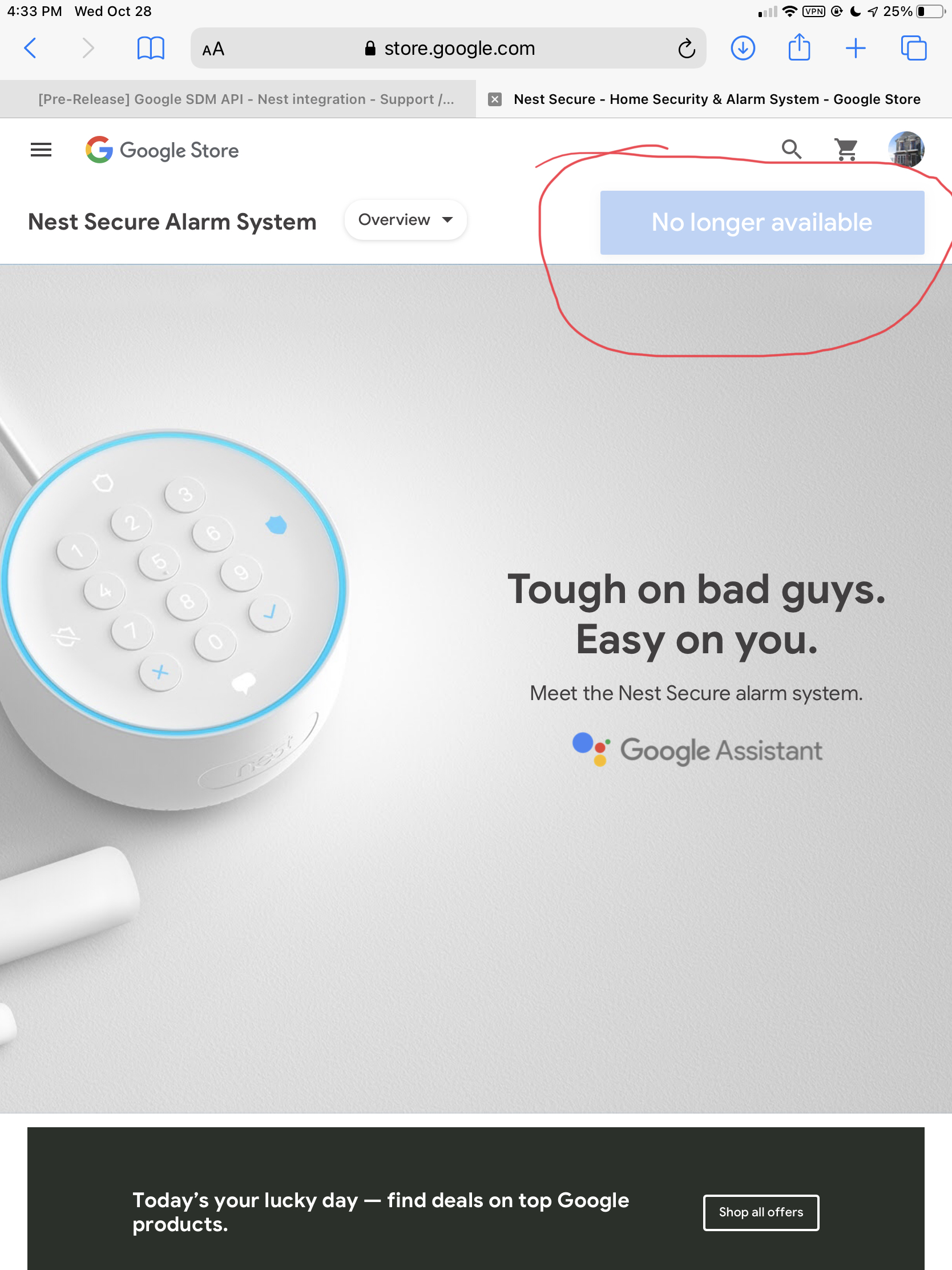

They might not continue to do any further development or integration, I received this e-mail today.
We’re reaching out to give you an update on your Nest Secure alarm system. We sold out of Nest Secure and won’t be making the full system available for sale any longer. We are committed to bringing you the same feature and software support you’ve always had with Nest Secure, including existing cross-product integrations within the Nest ecosystem. We will also continue to deliver critical security updates and software fixes. You shouldn’t notice any change with your Nest Secure experience.
I think he meant the nest protect, not the nest Secure?
Nope. Nest Secure:
I meant @rocketwiz, he said he wish he could use his nest protect with this.

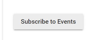

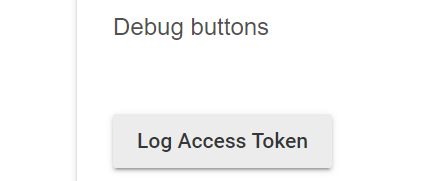

@dkilgore90 im still having a issue with this. The thermostat is working perfectly, its my nest hello that's the issue. It connects then never sends any more events. Any ideas where to start?
EDIT: been trying for a week, i post this and click another button and it springs to life!
Hmm, weird. The only thing I can think of is that there are some dependencies between the event stream and a subsequent device get/list to "start" it -- but can't think of why it would have events for one device and not another...
Regardless, I may tie the event stream and device discovery closer together, just to be sure.
from memory i deleted the one device and did a discover. That didn't work again so then went in and clicked this.
image #
then clicked this.
then it jumped to life.

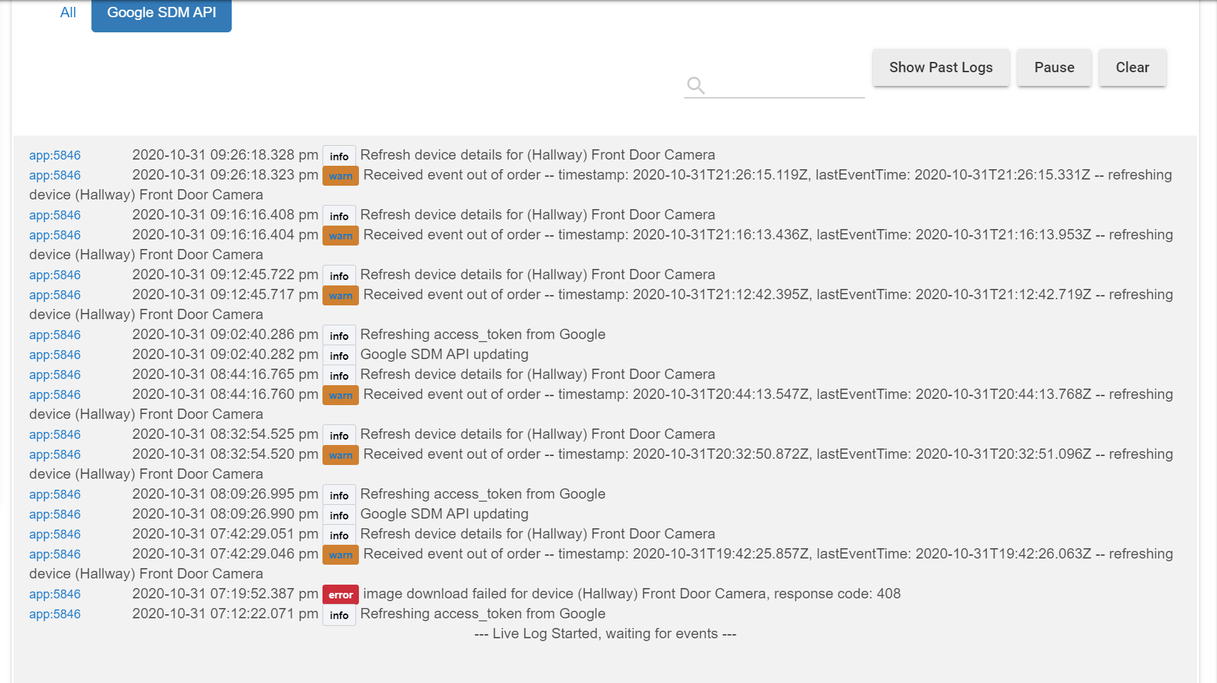

also getting this in the logs, what's it after?
You can use the attribute tile and select image, which will display the most recent event image (this only works for local dashboards, it seems like the cloud service blocked the response based on size when I tried coding that option).
The logs are essentially indicating that several events occurred for a device in a short period of time (generally less than a second}, and Google sent the later event first (each event has a timestamp) -- the api doesn't guarantee event ordering. Since we don't want to overwrite newer data, and might have missed something, we discard the "out of order" event and refresh the current state.
The only way around this is to maintain a sorted buffer to process the events -- but such an implementation adds complexity, and more importantly, a latency delay before anything gets processed, to make sure we don't get something else that should have been processed before.
