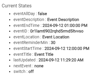

When a match is found several GCal Switch attributes are set with the details of the calendar event. These are then reset to a single space value when either the event completes or the event is not found on the next refresh.

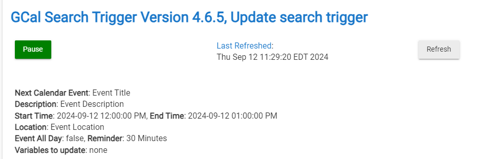

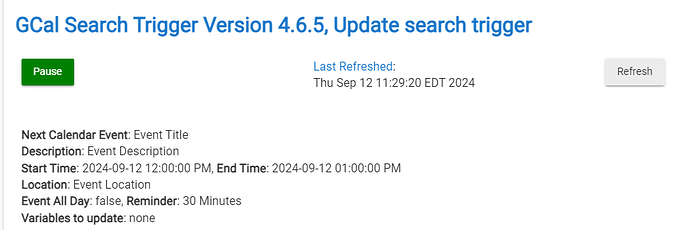

Yes the event title, location, start, end, etc are all stored as attributes and can be used for notifications. Within the search trigger you can send notifications including these attributes without the need of other apps but this said you can leverage Rule Machine to send notifications as well.
Edit: Pictures often help
At the top of the search trigger you will find the matched event details:

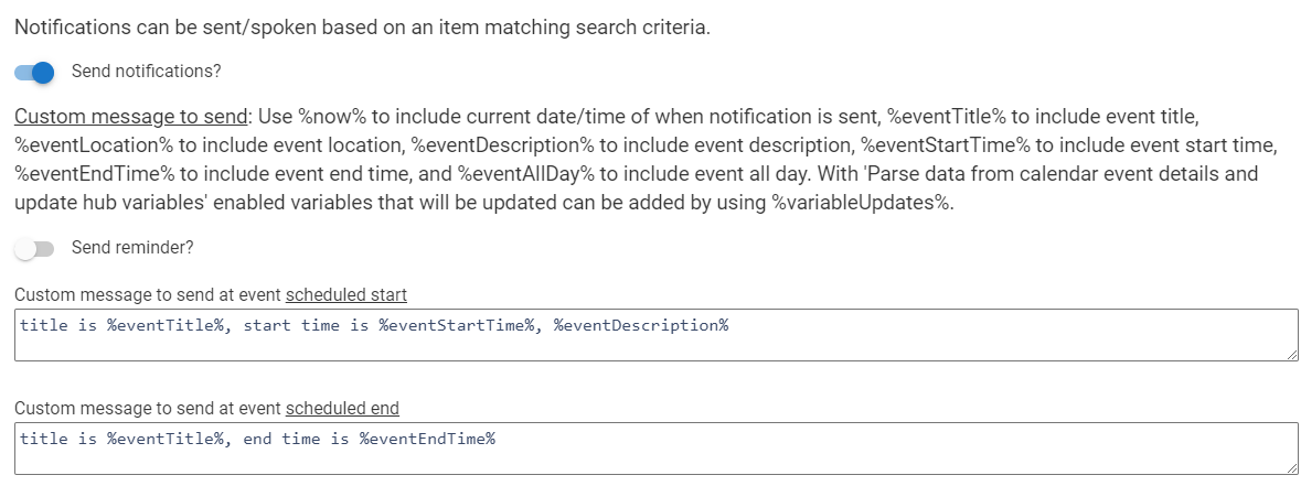

In the Additional Actions section of the Search Trigger app you can natively send notifications and details of the matched event:
You can optionally create a child GCal Switch (setting within the Search Trigger app) and it will also contain the event details so you can "listen" for events on the attributes for rules and apps:

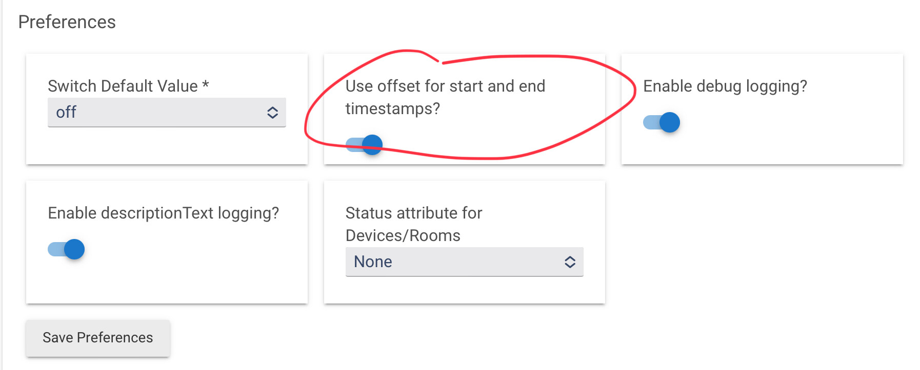

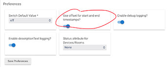

In the child switch there is a preference to use the offset for the switch times values. Is this what you are looking for?

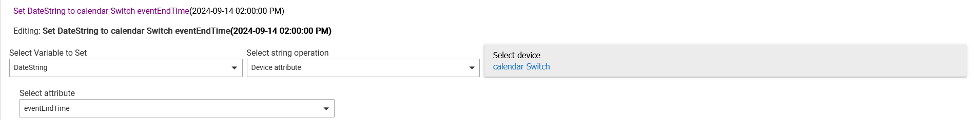

I am definitely no expert on Rule Machine and most of mine are simple and once things get too complex I write my own custom app. Device state attributes are all strings and there is not a notion of a date type state value unfortunately. Within a rule I was able to set a string variable to the value of my calendar switch:
Now from here is where I don't have the knowledge about RM to know if you can then turn the string into a date and then how to trigger things from a date variable. Now this said, could you explain more on how you are using the variables in your rules and the adjustments?
