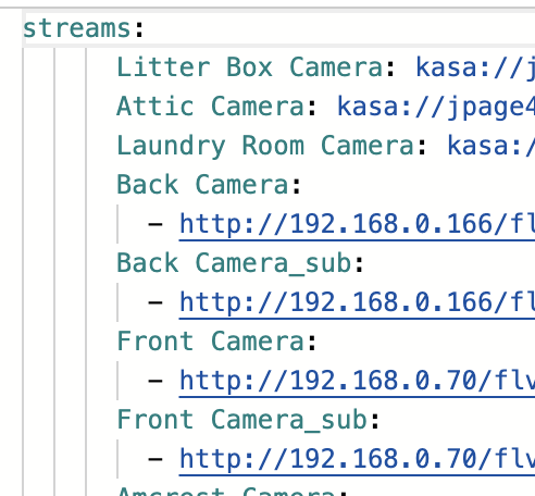

My apologies - I’ve never used go2rtc before. Apparently there is some sort of a “control program” on the LXC container that I used, which apparently takes preference before the actual go2rtc.yaml file. So, I just used that control program and got it working.
I wasn’t sure it’d work either but I wanted the Hubitat device names to look like this for display on the dashboard. Unfortunately I don’t believe you can change the device name/label in the child device itself. Anyway, it works for me.. I also tested the “_sub” extension which puts both video streams into a single device (see “Back Camera” entries below)
Can this work with the native Hubitat dashboard? I tried image and video without seeing anything on the dashboard but the same URL worked fine directly in my browser.
You may need to add the RTSP feed this way:
