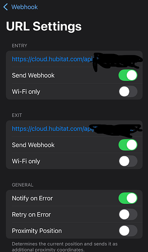

Here is my config for the location I am setting up.

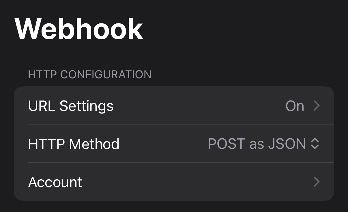

and the webhook config too:
Any insights on what I am doing incorrectly or how I can fix this?

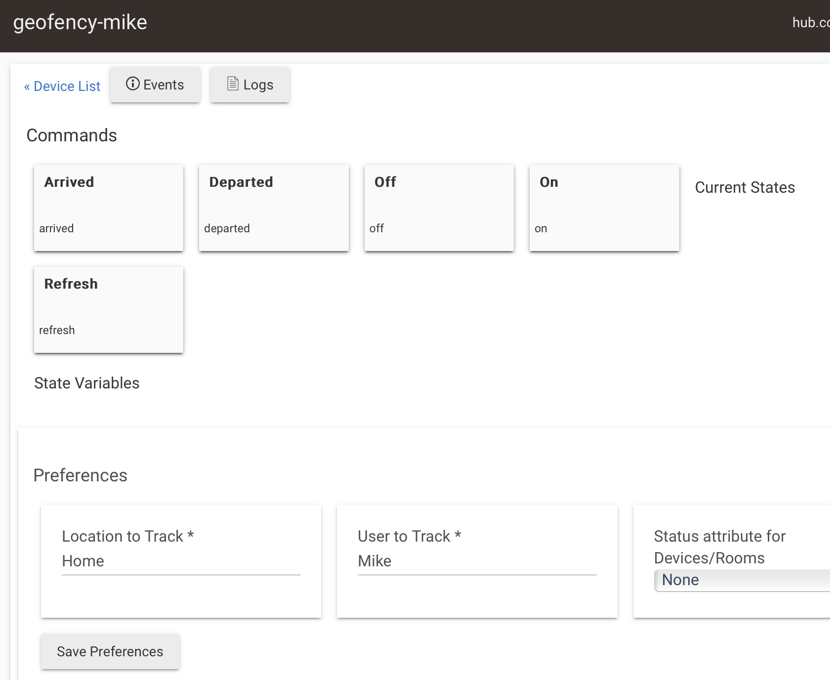

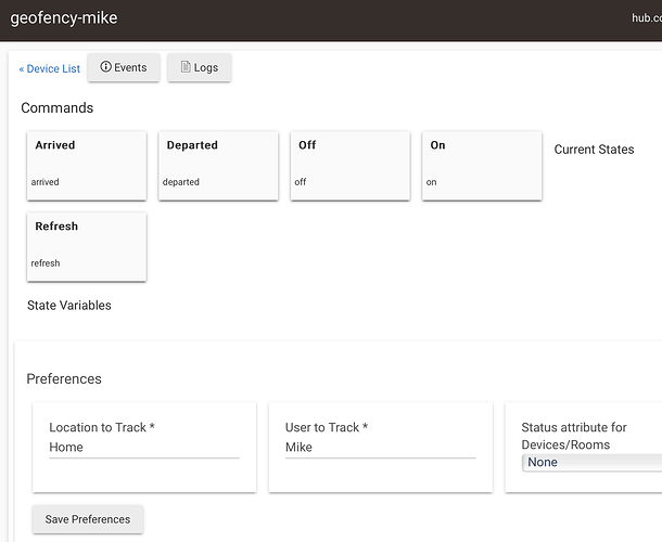

Shortly after making my post looking for help I figured out what my issue was. I went back into the device I created and retyped in both the location and name and hit save. When doing so, I noticed the "Current States" section for the device updated and displayed both a "region" value and a "user" value. It's strange that didn't take the first time when I created the device.
