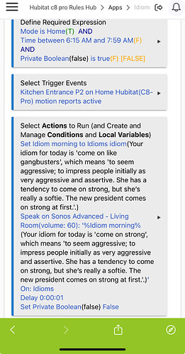

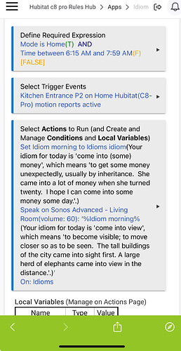

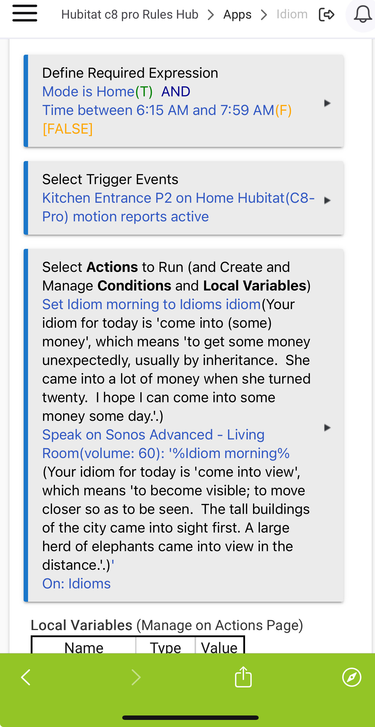

I now have this working in a rule with the below logic. One question remains illusive, is there some logic to limit this action to only run once per day ?
This could be simplified to not even creating or assigning the variable. Just use %value% as the message.
Private boolean. Just an example: set it to True. In the actions, if true, do the actions, once the message is spoken, set the boolean to false. Then another rule to set the boolean to true at 3 am or something.
@KurtSanders, one more observation. Please consider having abbreviations completely written out, or an option to use abbreviations or not. Fine for text message (oooh, an idiom of the day Pushover message to start the day), but doesn't work well with TTS. I tried on Alexa and Siri, and neither of them could pronounce "Rur." or "Euph." in any manner that could be understood.
Wonderful,
Thanks for your help!
I now have working with the below rules and logic (if it might help anyone else)

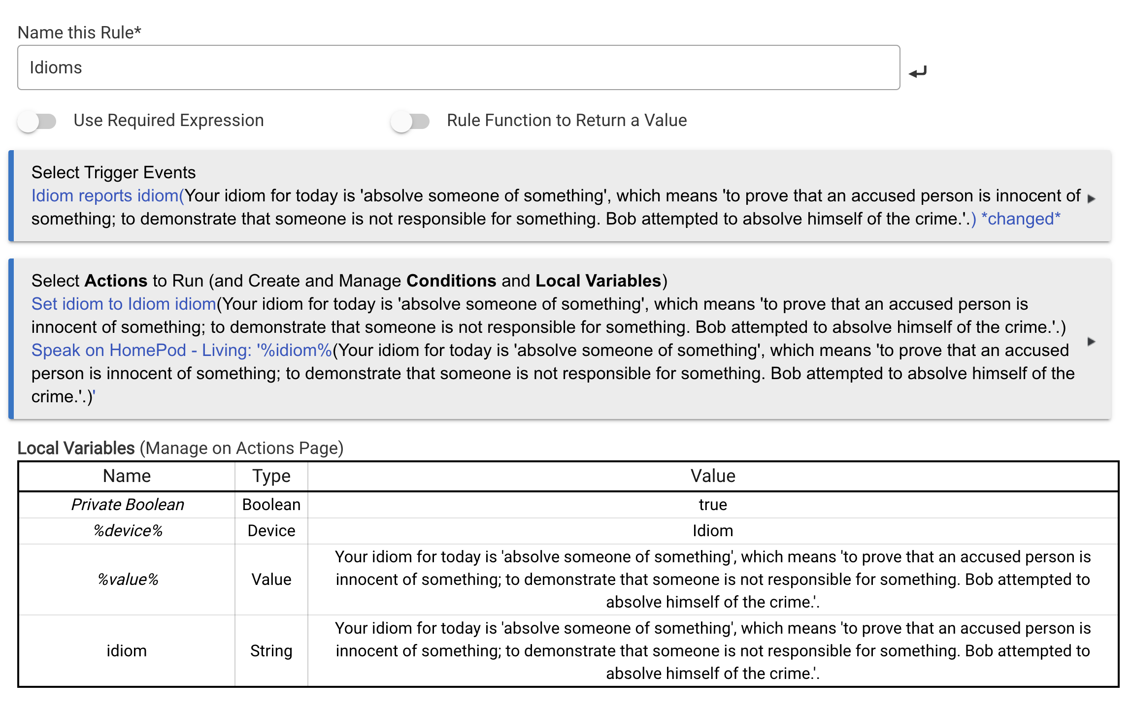

  • @neerav.modi Our granddaughters, after a few weeks, have started using some of these idioms in their everyday communications. It is nice to see them picking up more than what my wife and randomly use, ie "Don't look a gift horse in the mouth".
  • @ThunderboltsRock I have a HE rule when our Theater Projector turns off that sets the idiom device's 'idiom' attribute to a local variable named quote that can be used in HE rule's TTS message as %value%. I also have it play an idiom when we eat our morning breakfast...so many options.
    • RM Example (quote is a local variable)
      • Set quote to Idioms
      • Notify Echo - Theater: '%quote%.
      • I usually end the RM rule with a device command 'refresh' or toggle the switch to 'on' to pre-load the next idiom in the idiom device's attributes so that the next RM rule can fire off faster and eliminate the delay in activating the idiom's device's logic.

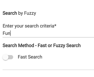

The 'Fun Api Responses' app is now available in HPM.
You will need to turn off 'Fast Search' and then search for 'Fun' as shown below.
