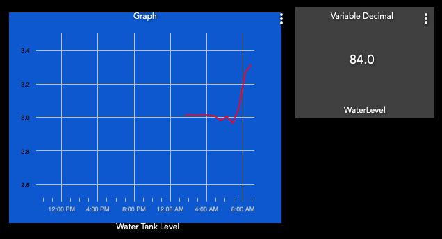

However I am scratching my head over how to use the analog inputs. I want to measure a water tank level via a gauge that puts out an analog voltage level. Typically 2.5 to 7 volts corresponding to level. I set input 2 on the fibaro to analog with internal pullup. The log shows it correctly measure the voltage at 3.08. However I am not sure how to set this value on a tile. What template should I use? How do I get this analog voltage level to be displayed on a dashboard tile?
Any help is appreciated and I apologize if this topic has already been covered.
Interestingly the driver for the input child device still says "Child Digital input". Perhaps that is just a naming thing.
I think the only tile working at the moment is the "Attribute" template with the "voltage" attribute. It just displays the voltage value using numbers. Probably not the best way to display what you want. I will take a look into improving it.
I personally convert the voltage to temperature using an equation and post it as such in the child device but that requires modifying the code...
In the meantime, you could always add a rule in the rule machine to trigger with a change of the voltage attribute of the child and then set the value of a virtual device (e.g. type=virtual dimmer) to a value corresponding to the voltage (e.g. set dimmer "level" = "voltage" X 10: Create a rule local variable, in the rule, set variable to "voltage" X10 then set dimmer level to variable value... ). You can then just use a tile to display that virtual device value (e.g. template "Level Vertical").
I can't find what you see anywhere, can you provide a screen capture?
Hey thanks for the rapid support response. I think a big part of my problem is a misunderstanding of what the child devices do. I was under the impression that the two inputs were always accessed by the Child Digital Input driver, and when I set the input to "Analog" that it would somehow switch the reading method for me. I thought that the two Child Analog Input drivers were for the two temperature sensor inputs. However after more experimentation I have realized that the Child Analog Input drivers are also tied to the two main inputs. So when I change the Input to Analog, I should then be reading the Analog Child device. Daahhh....
I'm still learning this platform so I appreciate your patience. For the display I have made use of the new Variable display tiles. I do bit of simple math on the sensor value then display it as a percentage. I have also set the voltage reading to a Hubigraph tile which was surprisingly simple.Screen Shot 2021-02-05 at 9.13.54 AM

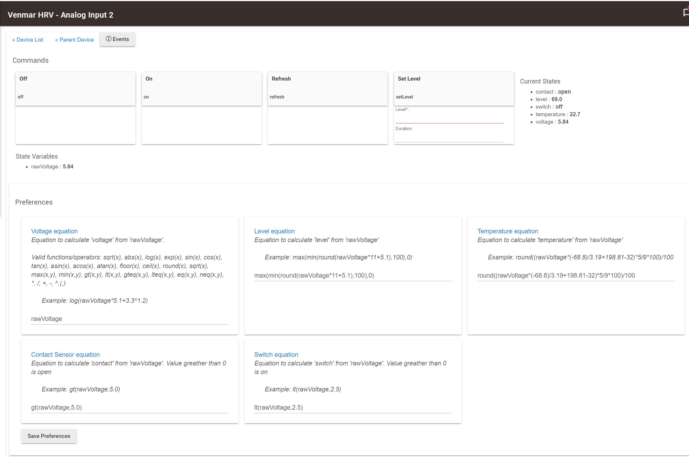

Version 1.7.4 is now available. I had some fun yesterday adding extra "capabilities" to the analog sensor child device such as temperature, contact, switch, level. The values are calculated from the rawVoltage received from the implant using equations entered in the preferences. The resulting values can be used in tiles, rules, etc. Errors in the equations will show-up in the log.
This is a first draft, the switch and level capabilities are not really sensors but actuators. I included them anyway for now. The corresponding actuator commands showing (On, Off, Set Level) are not doing anything.

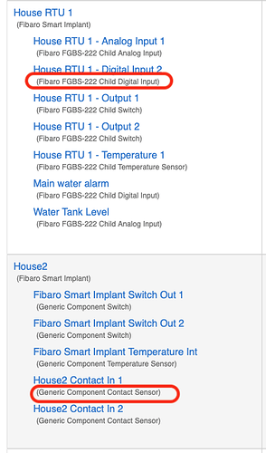

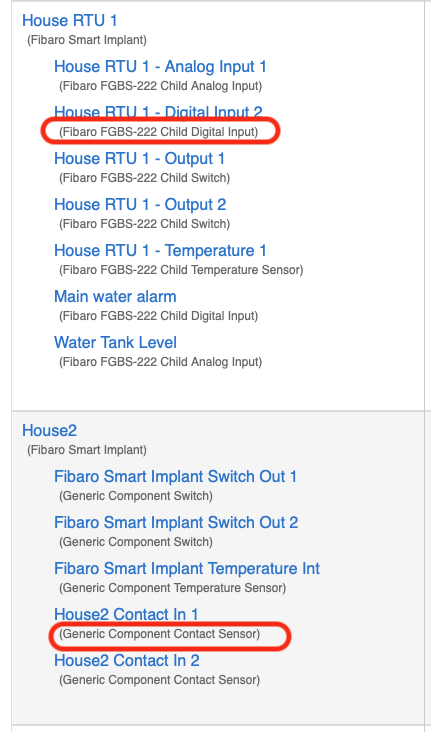

I have just included a third Fibaro 222 implant and all seemd fine. As usual it popped up with the default Fibaro driver. I then tried to swich to the Christi999 driver. I did it the way I did before which was to select at the parent. In the past this should have populated the child devices with the new drivers but it has not. Have tried several times. I hit save then configure. The log is showing it configuring, but the child devices still show the Generic drivers. I have excluded and reincluded but still the same. Has anyone else found this? Am I doing something wrong? Do I need to do this manually now?
The attached image shows the two units with different child drivers.
OK forget all of that. I just hit "Reinstall" and that fixed it. I guess I must have done that with the other ones but forgot. Kind of weird how it take the parent (config) driver without a reinstall but not the children.
