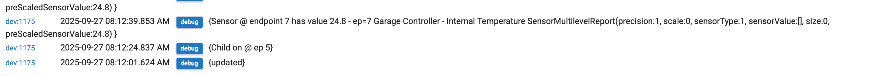

I updated to 2.4.1.153. I don't get any errors when line 443 is executed (temperature conversion, tried default, deg C and deg F)
BTW, I can only test the internal temp. sensor, maybe the problem happens for external ones or for ZWJS?
Correct, I tried it and couldn’t get it working. I have a vague recollection that whoever wrote the HE driver skipped electronics circuit design 101 class and implemented “normally open” and “normally closed” inverted. But it was late, and I decided to revert to what I knew worked.
This is a long shot but if you or someone wants to try the following, it might help (enable the debug log).
Change the following lines (from line 441...)
		case [7,8,9,10,11,12,13]:
			(finalVal,units) = convertTemperature(cmd)
			finalVal = finalVal.toFloat() + settings["${"sensorOffset" + (endpoint-7).toString()}"]
			finalVal = (Math.round(finalVal* 10.0)/10.0).toFloat()
			target?.sendEvent(name: "temperature", value: finalVal, unit: units, descriptionText:"${target} temperature is ${finalVal}${units}" )

@christi999 I hadnt tested the OEM Hubitat driver on 2.4.3.x with ZWJS and it is now working with the Smart Implant, it's just your excellent community driver that isnt.
All I get are this odd message in the logs when I attempt to trigger a relay:
"Child on @ ep 5"
