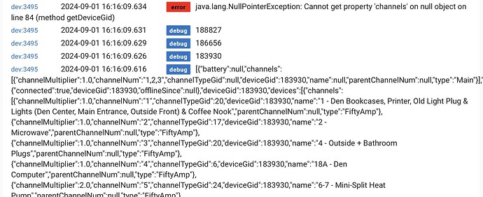

Once the authentication issue got resolved, I noticed the following error, and the child devices were not populating, but did fix that:
To fix it, I updated line 84 like @john18 did above (removed the [0]).
The only issue that remains at this point is that child devices of the main emporia are not populating. This includes the plugs as well as the devices that are under my sub panel (I have 2 Vue 2’s). I wonder if it might be related to the following error:
@ke7lvb, is there any other information that I could provide to help debug this?

- JSON : {"deviceListUsages":{"devices":[{"channelUsages":[{"channelNum":"1,2,3","deviceGid":183930,"name":"Main","nestedDevices":[{"channelUsages":[{"channelNum":"1,2,3","deviceGid":186656,"name":"Main","nestedDevices":[{"channelUsages":[{"channelNum":"1,2,3","deviceGid":189565,"name":"Main","nestedDevices":[],"percentage":null,"usage":null}],"deviceGid":189565},{"channelUsages":[{"channelNum":"1,2,3","deviceGid":320302,"name":"Main","nestedDevices":[],"percentage":0.5470281824140429,"usage":0.004759628183477678}],"deviceGid":320302}],"percentage":83.98040129010761,"usage":0.7307036414032845},{"channelNum":"1","deviceGid":186656,"name":"2A - Plug for Living Room Entertainment Center UPS & Back Door + Inside Garage Door Doorbells","nestedDevices":[{"channelUsages":[{"channelNum":"1,2,3","deviceGid":191133,"name":"Main","nestedDevices":[],"percentage":null,"usage":null}],"deviceGid":191133},{"channelUsages":[{"channelNum":"1,2,3","deviceGid":191135,"name":"Main","nestedDevices":[],"percentage":null,"usage":null}],"deviceGid":191135},{"channelUsages":[{"channelNum":"1,2,3","deviceGid":320310,"name":"Main","nestedDevices":[],"percentage":2.9457394592502126,"usage":0.02563053422504924}],"deviceGid":320310},{"channelUsages":[{"channelNum":"1,2,3","deviceGid":320311,"name":"Main","nestedDevices":[],"percentage":4.19936077675763,"usage":0.0365381465675894}],"deviceGid":320311}],"percentage":3.5209028568929366,"usage":0.030634963622898873},{"channelNum":"2","deviceGid":186656,"name":"8A - Plugs & Lights North Bedrooms","nestedDevices":[],"percentage":5.337366752724333,"usage":0.04643980335659451},{"channelNum":"3","deviceGid":186656,"name":"10A - Basement Game Room Plugs & Lights","nestedDevices":[],"percentage":0.6753273001440817,"usage":0.005875943788952297},{"channelNum":"4","deviceGid":186656,"name":"6B - Walk-in Closet and On-Suite","nestedDevices":[],"percentage":0.839975967118878,"usage":0.00730853256755405},{"channelNum":"5","deviceGid":186656,"name":"10B - Plugs Dining Room + Aquarium + Sunroom (East)","nestedDevices":[],"percentage":3.456425940617338,"usage":0.030073957521650527},{"channelNum":"6","deviceGid":186656,"name":"12A - Dining Room Plugs - North","nestedDevices":[],"percentage":0.0005270339791115252,"usage":0.000004585660960939195},{"channelNum":"7","deviceGid":186656,"name":"4B - Kitchen Refrigerator","nestedDevices":[],"percentage":9.786523351738548,"usage":0.08515139413409763},{"channelNum":"8","deviceGid":186656,"name":"16A - Garage South & Ceiling Plugs","nestedDevices":[],"percentage":0.6343677783703703,"usage":0.005519559784465366},{"channelNum":"9","deviceGid":186656,"name":"16B - Cold Room Plugs (Dehumidifier & Fan)","nestedDevices":[],"percentage":1.8406621151028135,"usage":0.016015385607083637},{"channelNum":"10","deviceGid":186656,"name":"18B - Plugs & Lights South Bedrooms (Including Dimitri's Home Office)","nestedDevices":[{"channelUsages":[{"channelNum":"1,2,3","deviceGid":191130,"name":"Main","nestedDevices":[],"percentage":null,"usage":null}],"deviceGid":191130},{"channelUsages":[{"channelNum":"1,2,3","deviceGid":320255,"name":"Main","nestedDevices":[],"percentage":6.764951297821306,"usage":0.05886104937934108}],"deviceGid":320255}],"percentage":5.284742220414032,"usage":0.0459819234608621},{"channelNum":"11","deviceGid":186656,"name":"20B - Solar Braker Panel (Work Computer, Alexa devices and Battery Chargers)","nestedDevices":[{"channelUsages":[{"channelNum":"1,2,3","deviceGid":191141,"name":"Main","nestedDevices":[],"percentage":null,"usage":null}],"deviceGid":191141},{"channelUsages":[{"channelNum":"1,2,3","deviceGid":320239,"name":"Main","nestedDevices":[],"percentage":1.5226691227957692,"usage":0.01324856580329622}],"deviceGid":320239}],"percentage":2.479464484486878,"usage":0.02157353024887359},{"channelNum":"12","deviceGid":186656,"name":"13A - Cable + Basement South West Plugs + Garage Fridge + CO2 Monitor + Water Shutoff","nestedDevices":[{"channelUsages":[{"channelNum":"1,2,3","deviceGid":188827,"name":"Main","nestedDevices":[],"percentage":null,"usage":null}],"deviceGid":188827},{"channelUsages":[{"channelNum":"1,2,3","deviceGid":320243,"name":"Main","nestedDevices":[],"percentage":6.190839316327777,"usage":0.05386576823033338}],"deviceGid":320243}],"percentage":4.317174458048367,"usage":0.03756322961796544},{"channelNum":"13","deviceGid":186656,"name":"13B - Basement + Lights + Closet + Cold Room Lights + Basement Game Room North Plugs + Air Exchanger","nestedDevices":[{"channelUsages":[{"channelNum":"1,2,3","deviceGid":188837,"name":"Main","nestedDevices":[],"percentage":null,"usage":null}],"deviceGid":188837},{"channelUsages":[{"channelNum":"1,2,3","deviceGid":320270,"name":"Main","nestedDevices":[],"percentage":4.892781126735088,"usage":0.042571515865282336}],"deviceGid":320270}],"percentage":9.92351873114673,"usage":0.08634337489450362},{"channelNum":"14","deviceGid":186656,"name":"15A - Den & Dining Room High Plugs (Cameras)","nestedDevices":[],"percentage":1.7973058606563779,"usage":0.015638147912157906},{"channelNum":"15","deviceGid":186656,"name":"17B - Den East High Plugs + Main Entrance Closet Plug (Security System)","nestedDevices":[],"percentage":1.7471684246957182,"usage":0.015201907950639726},{"channelNum":"16","deviceGid":186656,"name":"6A - Basement Game Room West Plugs (Entertainment Center + 3D Printer)","nestedDevices":[],"percentage":5.275578731869279,"usage":0.04590219301965501}],"deviceGid":186656}],"percentage":31.876943296342414,"usage":0.27735755230532755},{"channelNum":"1","deviceGid":183930,"name":"1 - Den Bookcases, Printer, Old Light Plug & Lights (Den Center, Main Entrance, Outside Front) & Coffee Nook","nestedDevices":[{"channelUsages":[{"channelNum":"1,2,3","deviceGid":189564,"name":"Main","nestedDevices":[],"percentage":null,"usage":null}],"deviceGid":189564},{"channelUsages":[{"channelNum":"1,2,3","deviceGid":320230,"name":"Main","nestedDevices":[],"percentage":2.2333317662116317,"usage":0.019431958277921407}],"deviceGid":320230}],"percentage":2.7151859353266907,"usage":0.023624515000548095},{"channelNum":"2","deviceGid":183930,"name":"2 - Microwave","nestedDevices":[],"percentage":0.0,"usage":0.0},{"channelNum":"3","deviceGid":183930,"name":"4 - Outside + Bathroom Plugs","nestedDevices":[],"percentage":1.1204816857468545,"usage":0.009749179991086324},{"channelNum":"4","deviceGid":183930,"name":"18A - Den Computer","nestedDevices":[],"percentage":0.9169100068955974,"usage":0.007977926642232472},{"channelNum":"5","deviceGid":183930,"name":"6-7 - Mini-Split Heat Pump","nestedDevices":[],"percentage":0.0,"usage":0.0},{"channelNum":"6","deviceGid":183930,"name":"12-13 Oven","nestedDevices":[],"percentage":0.0,"usage":0.0},{"channelNum":"7","deviceGid":183930,"name":"14-15 Dryer","nestedDevices":[],"percentage":0.0,"usage":0.0},{"channelNum":"8","deviceGid":183930,"name":"16 - Garage North-East Plugs","nestedDevices":[],"percentage":0.9096084270323284,"usage":0.007914396450519562},{"channelNum":"9","deviceGid":183930,"name":"21 - Family Room Lights & Plugs + Kitchen Lights + Bathroom Lights + Outside Back Lights","nestedDevices":[],"percentage":3.0604679047533017,"usage":0.026628772999975417},{"channelNum":"10","deviceGid":183930,"name":"32 - Living Room (Subwoofer) + Kitchen (Toaster & Vitamix)","nestedDevices":[],"percentage":0.0,"usage":0.0},{"channelNum":"11","deviceGid":183930,"name":"36 - Washer","nestedDevices":[],"percentage":0.022401316509336675,"usage":0.00019491123278935748},{"channelNum":"12","deviceGid":183930,"name":"2B - Kitchen Fuse Panel (Kitchen Stove, Dish Washer, Insinkerator)","nestedDevices":[],"percentage":0.0,"usage":0.0},{"channelNum":"13","deviceGid":183930,"name":"4A - Kitchen Fuse Panel (Kitchen Stove, Island Plug, Dog Food Plug)","nestedDevices":[],"percentage":0.7590674423102155,"usage":0.006604556963841121},{"channelNum":"14","deviceGid":183930,"name":"34-35 Water Heater","nestedDevices":[],"percentage":0.0,"usage":0.0},{"channelNum":"15","deviceGid":183930,"name":"Rooftop Solar Panels","nestedDevices":[],"percentage":100.0,"usage":-0.5927307423184289},{"channelNum":"16","deviceGid":183930,"name":"EV Charger","nestedDevices":[],"percentage":0.0,"usage":0.0},{"channelNum":"TotalUsage","deviceGid":183930,"name":"TotalUsage","nestedDevices":[],"percentage":100.0,"usage":0.8700882946237565},{"channelNum":"Balance","deviceGid":183930,"name":"Balance","nestedDevices":[],"percentage":4.282144225106413,"usage":0.037258435661558065}],"deviceGid":183930}],"energyUnit":"KilowattHours","instant":"2024-09-01T20:46:06Z","scale":"1H"}}
It looks like you have multiple levels of nested devices, which my code does not check for. It would need additional loops around line 113, which is going to get ugly fast.
Loop through each devices then each channelUsages (the existing code does this much), then it will need to loop through each nestedDevices and each channelUsages (again). Because you have another layer of nesting after this, it would need to repeat again to loop through each nestedDevices and each channelUsages.
During each loop the code retrieves the device name and usage. It then tries to get the child device ID based on the name, or creates the child device if it does not exist. It uses the native Hubitat functions getChildDevice() and addChildDevice(), which is where it looks like the error was probably occurring before. Once it has the child device ID, it sends the usage value.

I have confirmed that it is indeed the problem. When I « un-nest » my sub-panel, then I have access to all devices except my plugs (which are nested under their relevant breaker).
