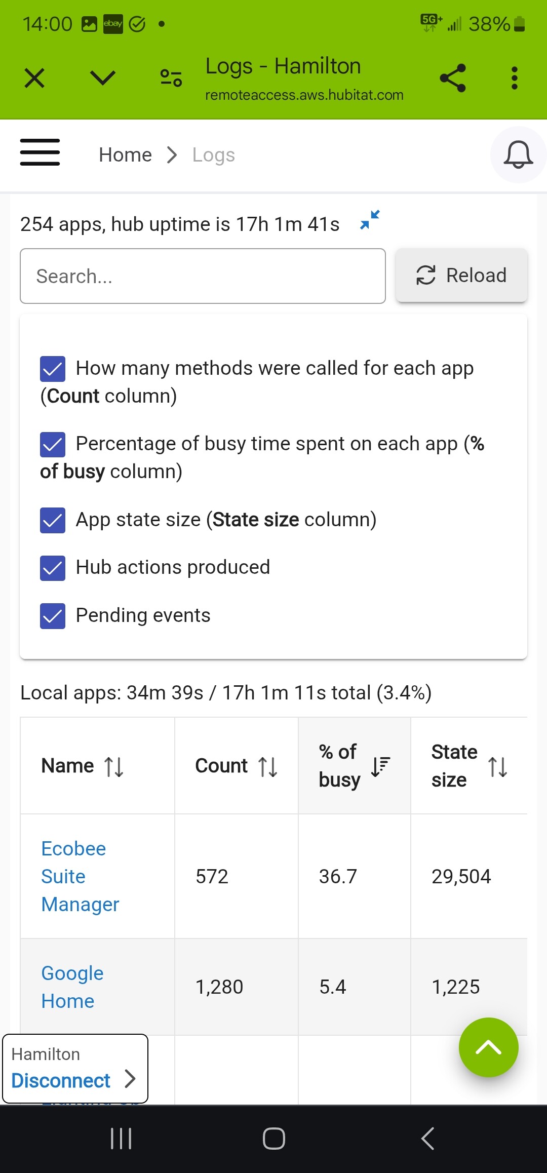

We have a C7 and we've started getting a "hub load is severe" error. It's been happening ever since I installed the Ecobee Suite Manager (ESM). The same day I installed it, I had my first severe error that night. At that point, it was just an error though and didn't cause any other issues. Now I'm starting to have zigbee devices skip commands or commands not being sent. I'm minimally using ESM. It only runs twice per day. Once at night to put our Ecobee's into sleep schedule, and once in the mornings to resume program.
I would love to have someone offer options on how to fix this. I have about 180 devices which are about 30% zigbee, 45% Lutron, and 20% virtual devices. The remaining is a few z-wave devices mixed in (door lock and some remote switches). This setup has run for about three years with minimal issue until installing ESM.
I've gone through and deleted 'disabled' rules, removed unused devices still on the network, and uninstalled unused driver. I've disabled logging for ESM and some of the other devices that report frequently. We have two thermostats with two additional sensors for each unit. I've disabled the four remote sensors from ESM so it only monitors the two thermostats and disabled logging and messaging from ESM as well. I just don't know what else to do.
That's weird that you are getting a severe load because those images you shared show that all of your Apps are only running at 4.4% and your devices at 0.5%. Therefore, even though the Ecobee Suite Manager is responsible for 50% of your busy in apps, that's 50% of 4.4% so hardly a strain on the hub.
The same goes for the devices; the two Ecobees are 10.2% of 0.5% so ~0.05%.
I know not helpful but it is strange.
That's what strange. I won't claim to understand the logs as in depth as you've explained, but from what I could tell, there's really no reason for it to be flagging those errors. Especially with the Suite Manager only running twice per day (I realize it reports more than that throughout the day, but that doesn't seem to be an issue). Any ideas would be appreciated! I've done everything I can think of. The errors are less often, sometimes taking two days to come up rather than every night. They usually come at night as well, not sure if that spurs any ideas.

In my experience, your situation is normal and nothing to be concerned about. The Ecobee factory alert level defaults may just be too low for your installation - I believe there is a command you can use to set the alert level a bit higher.

If this is happening ONLY overnight, I suspect it isn't ESM. Especially since you say it is some time AFTER ESM changes the program...
More than likely it is to do with the nightly database checks and backups that Hubitat does automatically at the time you set under Settings/Backup and Restore. You might want to look in the Previous Logs on your Hubitat for what all was going around backup time.
You could also change the backup time to something during the day, just so that you can watch what goes on when it does backups.
Finally, since a Reboot seems to clear things up, you could get an app to schedule a daily reboot an hour or so after your backups are done...
And, FWIW, pointing the finger at ESM based off of stats that are 8-10 hours AFTER the Alarm event happens, well...ummm...

I don't mean to come across as pointing the finger at ESM, it's just the logical step. This hub has run with the same devices and (mostly) the same rules for over three years and never thrown this error. The day I installed ESM, it started with the error, daily. After removing the sensors and logging in ESM, the error lessened to every other day (still sometimes daily). Changes to ESM seem to directly affect the error rate despite it not being immediate.
I'm not saying ESM is a problem on it's own by any means, it just seems to be a problem combined with my particular setup.
I added the sensors back in for ESM to monitor. After I changed the polling interval to one minute, I restarted the hub. Within 20 minutes of the restart, I had an error of "elevated" load. Within 40 minutes of the restart, the load severe error was back. I changed the interval to 5 minutes last night around 8pm. So far the error has not come back and I've had an uptime of about 17 hours with no errors. It is showing a larger % busy time than the other apps, but that has still not thrown an error. I will continue to monitor.
