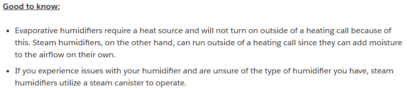

I believe that AprilAire 700 is an evaporative humidifier. If this is not correct, then please disregard the rest.
Ecobee will only trigger an evaporative humidifier when the heat is running and humidity is below the set level. Only a steam humidifier will operate independently. The snapshot below is from the link provided by @JDiGangi.
Yup. My Ecobee controls the Aprilair just fine. The Arilair is setup as a steam type so the furnace fan runs when the humidifier is on.

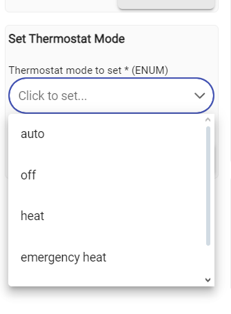

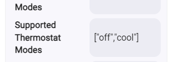

In RM I'm trying to make a rule involving the ecobee thermostat and can't set the mode to anything but "off" or "cool"... how can I get the full list of options in the drop down? I see in the device details this:
I do get the whole list in the device detail page, but not in RM... I assume it's pulling from supportedThermostatModes...
but a quick look at the code and I can't figure out where to 'stuff' the other options (heat/auto)
Thx for the driver(s), working great so far other than this snafu!
