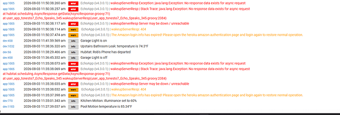

Not sure how to copy or upload logs. I am new to this. This is most current screen shot but someone on forums setup echo speaks to work locally and I was waiting for a fix and said to use hero.. so set that up but apperentally messed up what he set up, but it did break before I went with the forum soultion and he restored my hubitat to a week prior but speak was still broken. He said was a amazon issue. Wait screen shot is from today with the the old...was working version so it shouldnt include hero serve
r, this should be hosted on the hubbitat.
If you are not using Heroku (not Hero), you need to bring up the web page for your Echo Speaks server and use that to log back into Amazon to refresh your Echo Speaks cookie. There is a current issue with something that changed on the Amazon side of things, that is not allowing for automatic cookie refreshes.
Your Echo Speaks server does not get hosted on the Hubitat hub itself. It either runs on Heroku or somewhere else local. It can be running as a docker container somewhere, directly on a device like a Raspberry Pi, etc. There are multiple options, so you need to know how your ES server is configured and what it's access page/URL is, if as you mention above, you are not running it on Heroku.

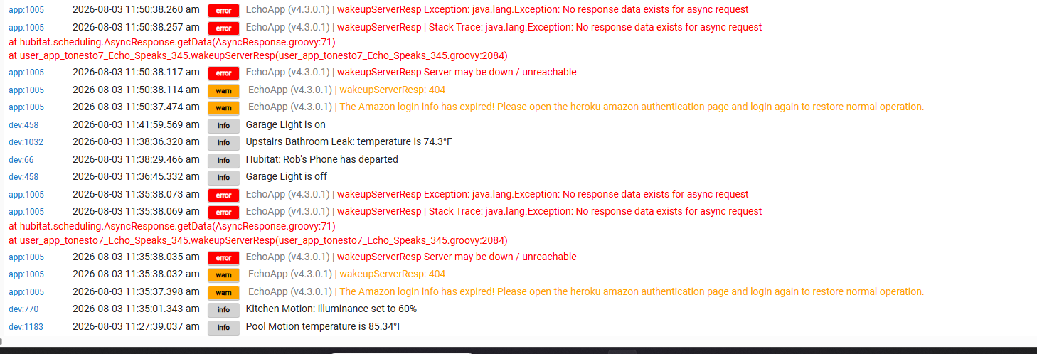

I have already applied a "work around" that allows me to change the update time. I have updated my time to 90 days. This seems to be working well (see screenshots).
However, is there a known fix for my configurations (Windows Docker Server) that allows automatic retrieval of the cookie without needing to log into Amazon/Alexa?
