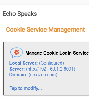

Does the app show the correct IP address for your ES server here?
Yes, it does.

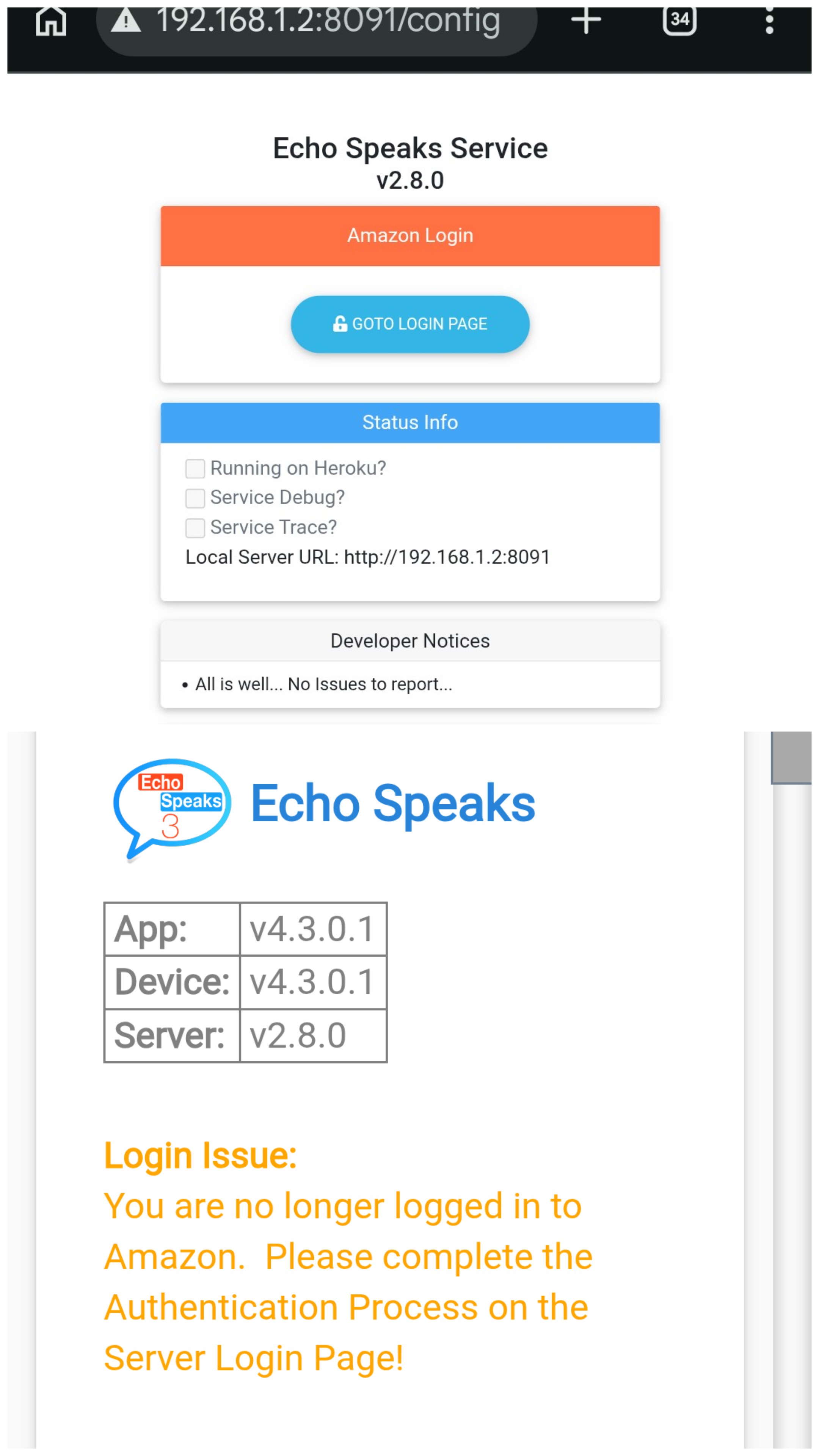

You're showing the ES server. That 192.168.1.2 address is the same as what's configured in the ES app in Hubitat?

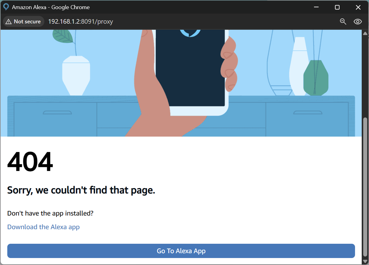

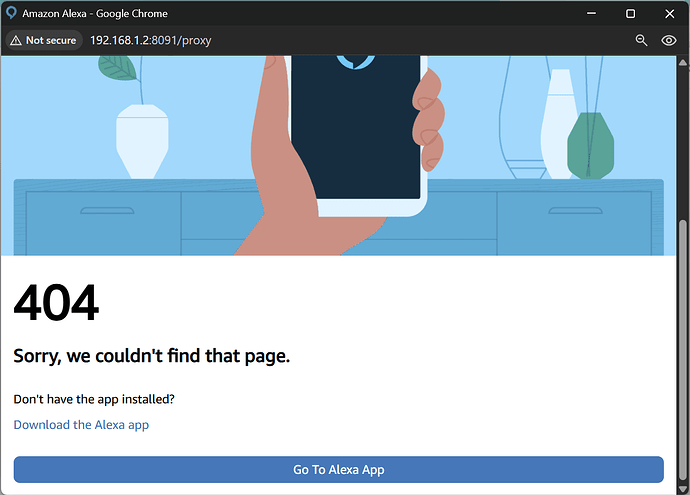

What happens when you click Goto Login Page?
Yes.
Amazon 404 error
The ES page and the ES cookie server UI’s show the correct IP of the cookie server ending in .218 but the logs show loopback IP. There must be something missing/wrong in my Portainer stack config.

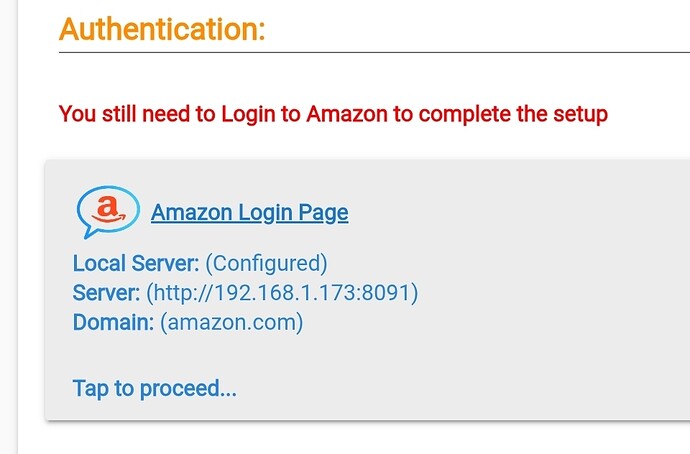

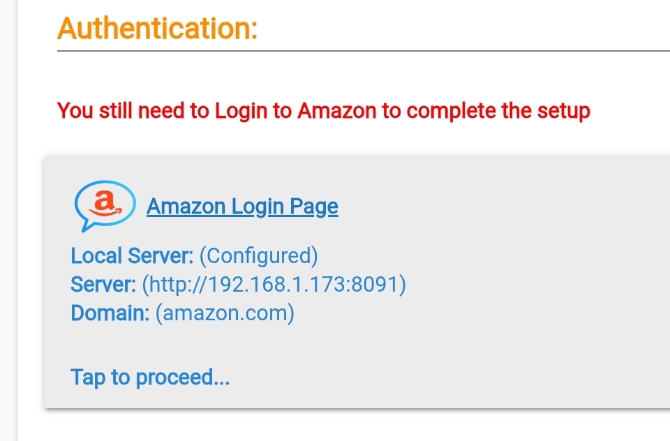

I have similar issues on a longtime running hosted server at 192.168.1.173:8091. But differently than @NewbHub, the Amazon login step completes successfully.
I didn't know how the callback URL is determined. How can I verify it is correct?
I hit Save Settings and go back to the ES app but it does not recognize the Amazon login.

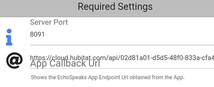

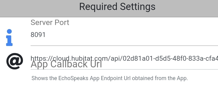

That image isn't showing your callback URL. It should be pointing to your hub. Is it correct on your setup? (Your hub didn't change IP's did it?)
[quote="jkudave, post:2590, topic:68843"]
Don't do this. Just login and leave the window open.
Clear all the cookie data in the app and start over. Do it all from a private/incognito browser window.
[/quote]
Thank you, @jkudave .

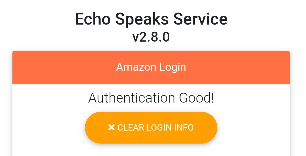

I opened an incognito browser (on an android tablet, trying both Chrome and Opera). Cleared cookies. Went through the steps, leaving the ES app open in a tab, and successfully logged into Amazon in a second incognito tab. But nothing happens after that. I go back to ES and it does not recognize the login. Is there a way to force the handshake so ES knows we are good?
P.S. The login page at the server does show a callback URL but I have no idea if it is valid.
P.P.S. Also tried on a Linux/Chrome browser with the same result. ES does not recognize the Amazon login.

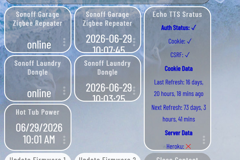

It seems I need to login every few days now. BTW: I never use incognito
This might help

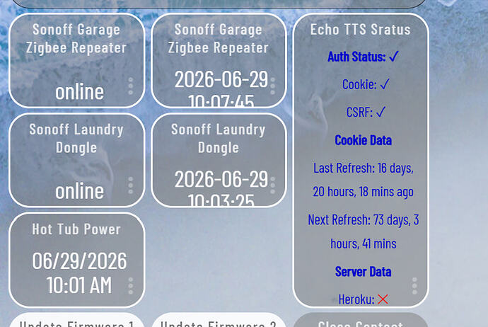

the 90 day change seems to be working for me.. now going on about 2.5 weeks. and still working.
Thank you. With the ES server on the same local LAN as Hubitat it makes more sense to use a local url. :crossed_fingers: It seems to be working now.
I did the 90 day fix but it still logged me off today, 3days it lasted
