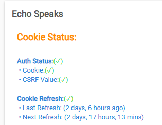

I haven't modified the Echo Speaks V4 apps code since it was last updated 09/11/2025. While I did have the "Auth Status" issue, it appears to be gone as of 11/29:
Last message (and was spammed a lot with): EchoApp (v4.3.0.1) | 400 validCookieResp
Same here, my Auth status now has a check mark.
Same with mine. Auth Status is now Green
Hmm, I hadn’t tried manually refreshing the cookie during this time, in case it somehow resulted in loss of the old cookie info but no new cookie.
But refreshing the cookie manually from the ES Hubitat app page seems to have done the trick.

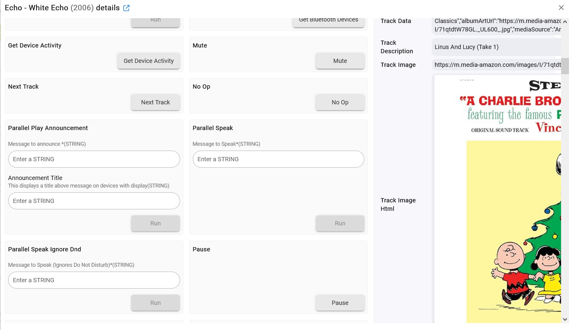

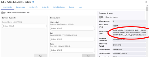

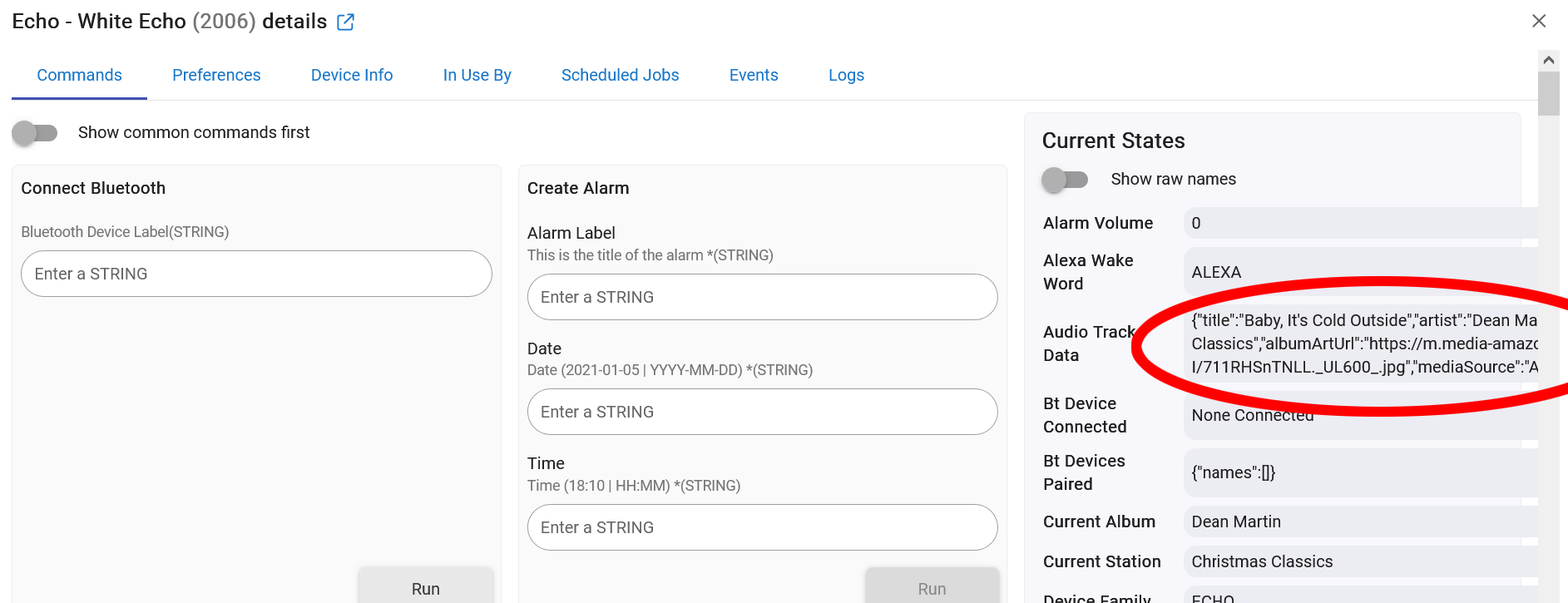

This question is about track data of Amazon music on an Echo. The music starts playing before the HE Echo device track data is updated, by about 2-5 seconds. I am cycling between Amazon playlists, Christmas Classics music and Christian Christmas music, changing playlists every 3 songs. But the next song starts playing, for about 3 seconds, before the track data updates. That messes up my programming to cycle through the above playlists. I'm changing playlists based on when the track data changes (ie the next song starts). Is this track data delay inherent to ES? Suggestions on programming?
Is anyone able to use this app to get the length of the song playing on an echo?

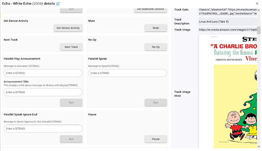

When playing a song on my Echo, when looking at the Echo device, the song information falls off the right of the screen. I have tried to adjust the text and window sizes, but it is still truncated. Any suggestions on how I can get all of the data to fit on my screen?

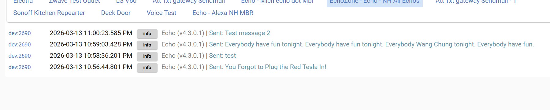

just realized the echo all devices created is no longer working..
no errors but no sounds come out..
each individual device still works fine..
not sure if this is a new issue with hubitat but my feeling is it is something with the echo speaks.
there are no errors in the app or the device logs even with debugging on.
this is going to be a major issue to workaround as i have a lot of warning rules accross 4 hubs and locations that rely on this to give me alerts.
