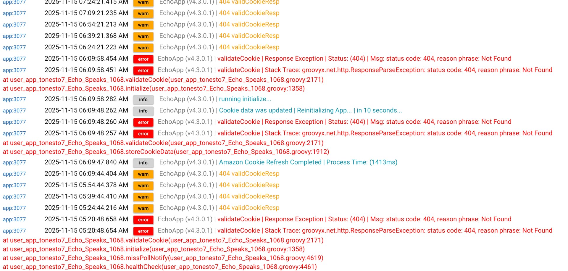

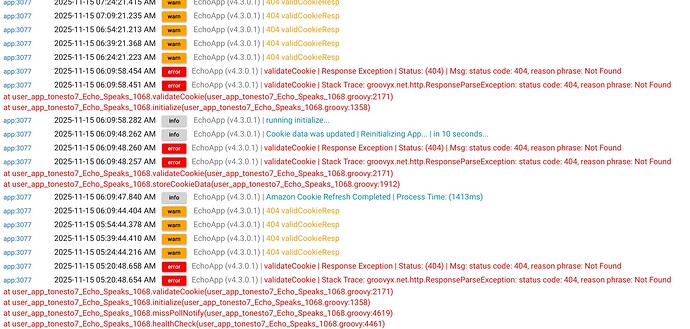

Well I guess I'll speak up. I DID do the Alexa+ upgrade a number of weeks ago. I ALSO have the 404 error - I was about to post a bunch of stuff about it, but I see that many others are seeing it.
AFAIK Echo Speaks is working just fine. Cookies refresh fine too. But my logs have tons of 404 errors like everyone else.
Bottom line: This might not necessarily be related to A+ since folks with it and without it are getting lots of 404 errors.

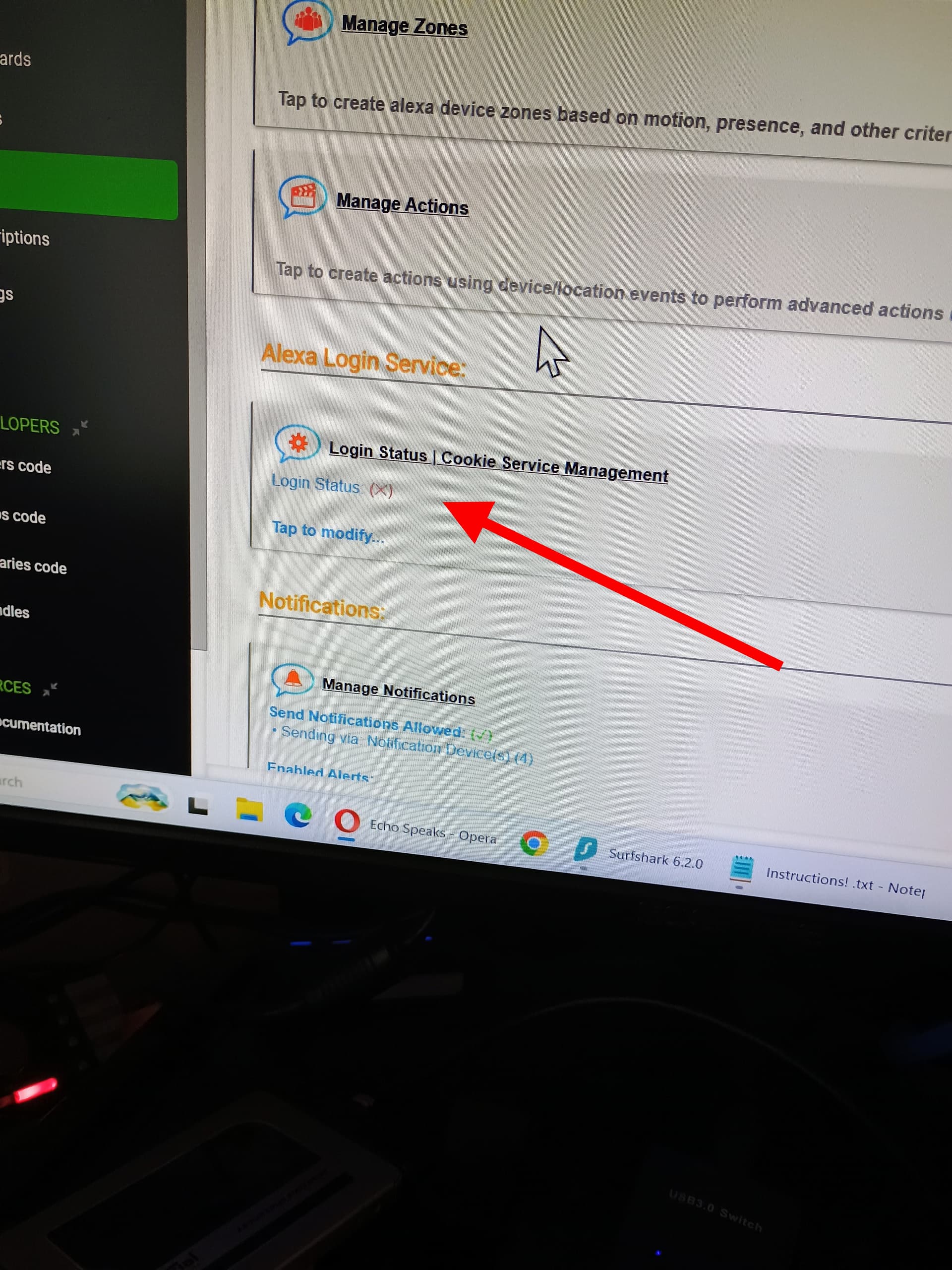

Post a screenshot of what you are seeing under the Alexa Login Service section of the app. The red X by auth status is a known issue of late:
If you see that you should be OK. If you see any other red X, you still have an issue somewhere.
