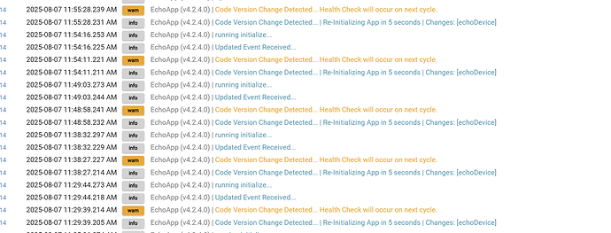

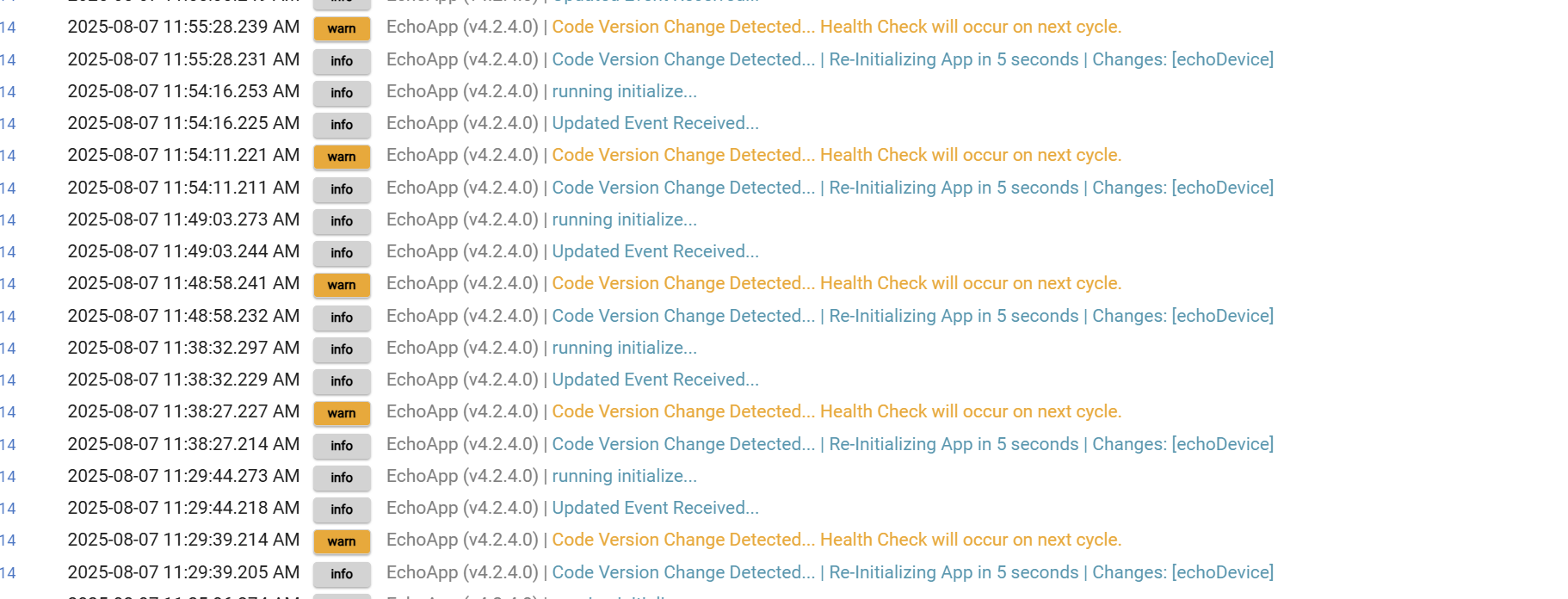

I'm getting this every 15 minutes...but ES is working.

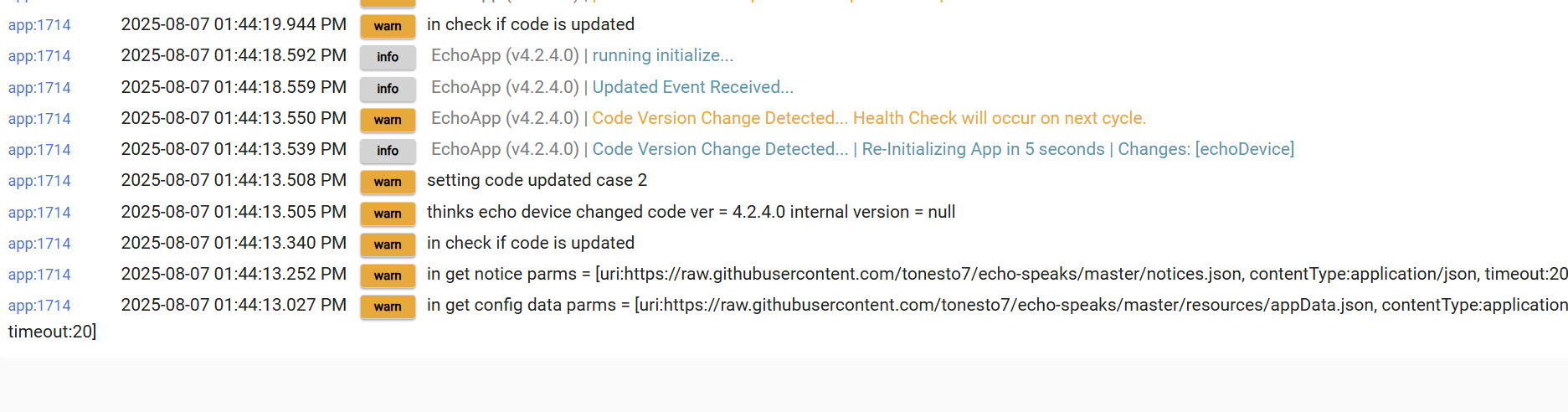

why am i constantly getting this message in the logs.. do i need to go to git hub and update something
i dont see a new version already running what looks like the latest?

Haven't seen that here. Did you manually change anything in the code? If I'm seeing that right, looks like it's complaining about echoDevice.
NOT THAT i know of.. i have put comments in to see which diff it is complaining about.. i will also do a diff between files.

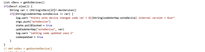

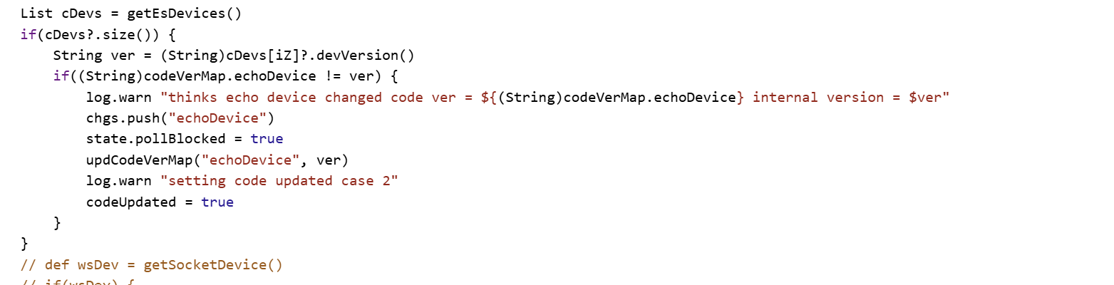

put some debugging in. think internal version is null..
