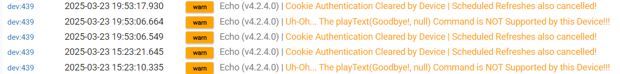

I am getting the same warnings as you:
As you can see, the 'Uh-Oh', warnings are also happening. Here is the portion of my webCoRE piston that's causing the warnings:
Note: The variable, 'EchoGoodbyeText' = Goodbye!
This piston has been running without issue using Echo Speaks for over a year - until about two weeks ago.
@Bruce123 @lflorack1
I am not seeing those errors in my logs and I send text to my Echo devices daily.

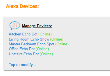

I think you both may need to redo your Echo Speaks cookie setups. The Cookie Authentication Cleared by Device warnings don't seem right. Are your devices showing as online?
Thanks for the response and suggestion.

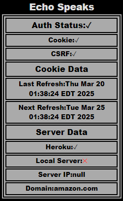

Yes, all (13) of my echoes are online and all other text commands to Alexa are working fine. Also, according to my Echo Speaks Tile (@thebearmay), my Echo Speaks cookie on Heroku is up and running as well.
Thanks again for the response and suggestion.
Where can I find this? I searched, but did not see anything.
Two Links
  1. ES Tile Discussion (@thebearmay)
    [RELEASE] Echo Speaks V4 - :gear: Custom Apps and Drivers - Hubitat
  2. Device Code: https://raw.githubusercontent.com/thebearmay/hubitat/main/esTile.groovy
Here's what it looks like on my dashboard (combined with Tile Builder @garyjmilne ):
As of yesterday (7 April), these errors have disappeared, and the pistons controlling the voice and music output have started working again. This may have had something to do with the changes that are going on in the background for the new 'Alexa+' initiative that's coming.
I also confirm that everything seems to be back to normal today, including track info.
