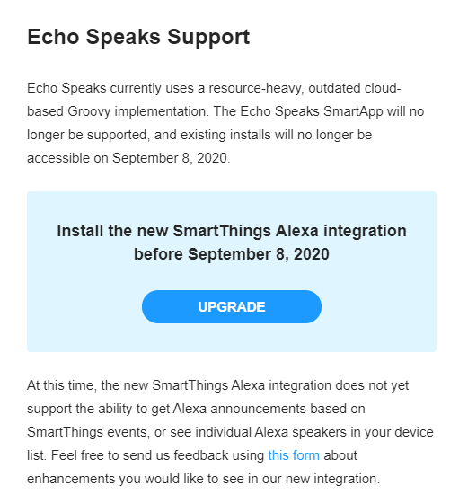

@tonesto7 Tony - is there anything about the ST unwelcoming attitude that would adversely impact your support of ES on Hubitat?
I assume you are talking about their plan to drop the old app and user code and so on? That is a good question.
No, this:
Mm this is painful. Hopefully @tonesto7 does not leave us behind when he revamps the st app
nope i'm not going anywhere.
I think I will even make the new lite version available on hubitat as well for those that just want to make basic announcements and speech without all the load on the hub.
YES PLEASE!!!!!
