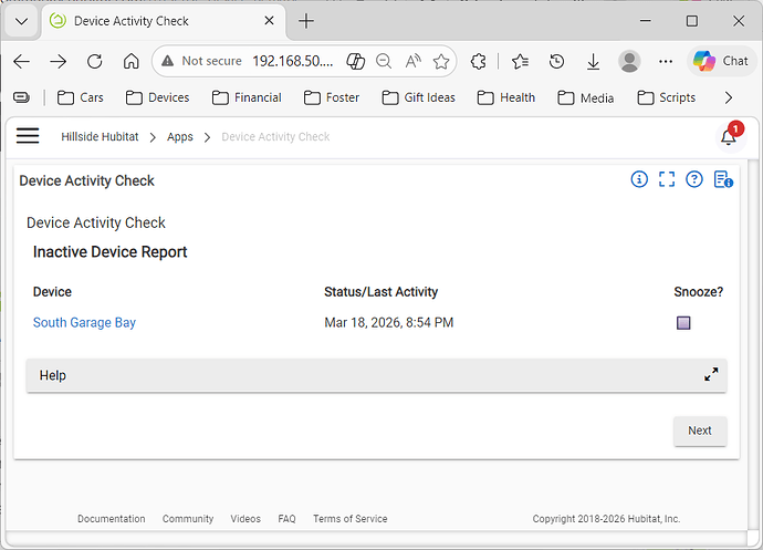

Hi, how can I get the app to stop notifying me of a device that is very much online and sending events to the hub? The device was reconnected two days ago but the app keeps sending notifications of inactivity. I would have thought that once the device started reporting again it would no longer be considered Inactive, or at least provide a way to "reset" it. Snooze seems to just make it notify me over and over again.
Did you just take that screenshot tonight?
The last activity shown in the screenshot was on 3/18.
Adding to this, we'd also need to see your settings for the group that device is a part of and ideally the app as a whole. If you have multiple instances of the app (on the same or different hubs), be sure to check those, too. The app won't send one if it's less than your threshold (though I see now this could be a couple days based on your screenshot, so it's likely it would actually be included...), and a snooze (your device is not snoozed in your screenshot above) would entirely exclude it, so something else must be going on.
Yes you are all correct; I've been looking at date fields all day for work and apparently lost all sense of things. :face_with_open_eyes_and_hand_over_mouth: My apologies and thank you for your quick responses.

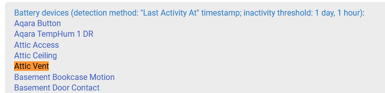

I just finished copying my DAC2 groups to DAC3, and when I ran a report nearly every device looking like this:
All of those devices are only in this group (which also has the "Supplant with Zigbee details" checked"):

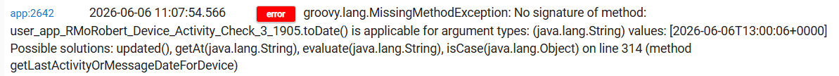

Ah - the logs show lots of errors of this form:
Thanks! Seems to be something wrong with Zigbee data parsing (I didn't test that well, as I disclaimed for the beta release, but no one complained, so I figured it must have been good :smiley: ). I'll see if I can figure out what's going on there. In the meantime, that's the only way I've been able to reproduce this, so I suspect it will work as before if you just disable the option.
Yes, turning that off avoided the errors.
