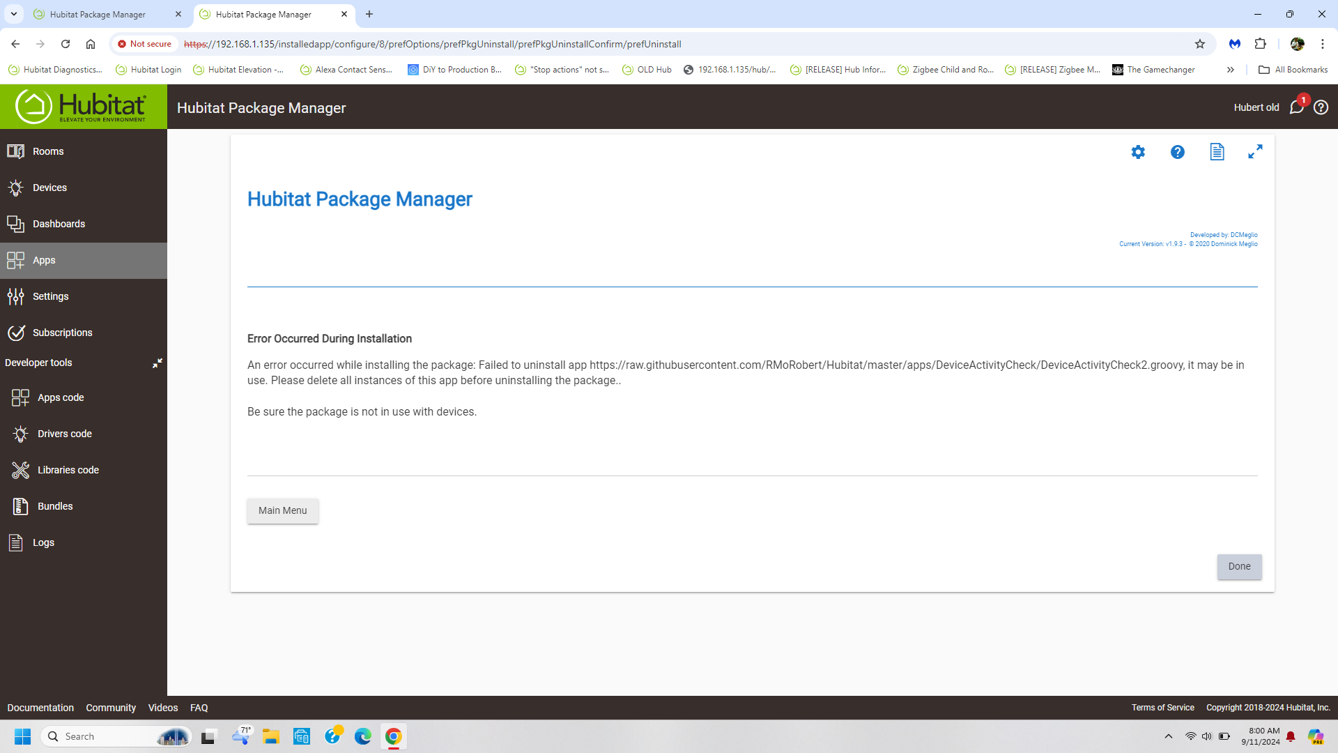

I installed this thru HPM but cannot uninstall thru HPM, what have I missed? Never used it or added any devices. It is on a C7 running 2.3.9.176.
Do you still have an instance of the app installed?
I'm not sure what that means
In your screenshot above, go to the "Apps code" section in the left menu... Is there an entry in there for "Device Activity Check"?
There is an entry for it.
What about under Apps? It's definitely going to be under Apps Code; the question is if you're still using an app with this code.
Yes to both, it is installed and listed in the apps section and is in apps code
In that case, as the HPM message suggests, you would need to remove the installed instance under Apps before HPM will let you use it to remove the app code.
Thanks for the help, got it. I guess I did not understand what installed instance meant. I like your app. I have it installed on a C8 that is hub meshed with the C7. Just added it to the C7 one day by mistake.
