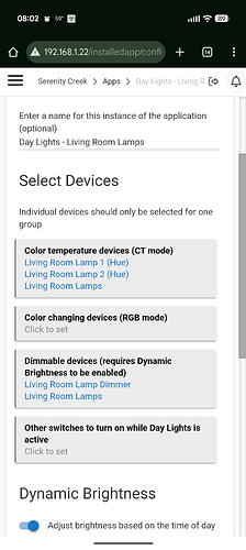

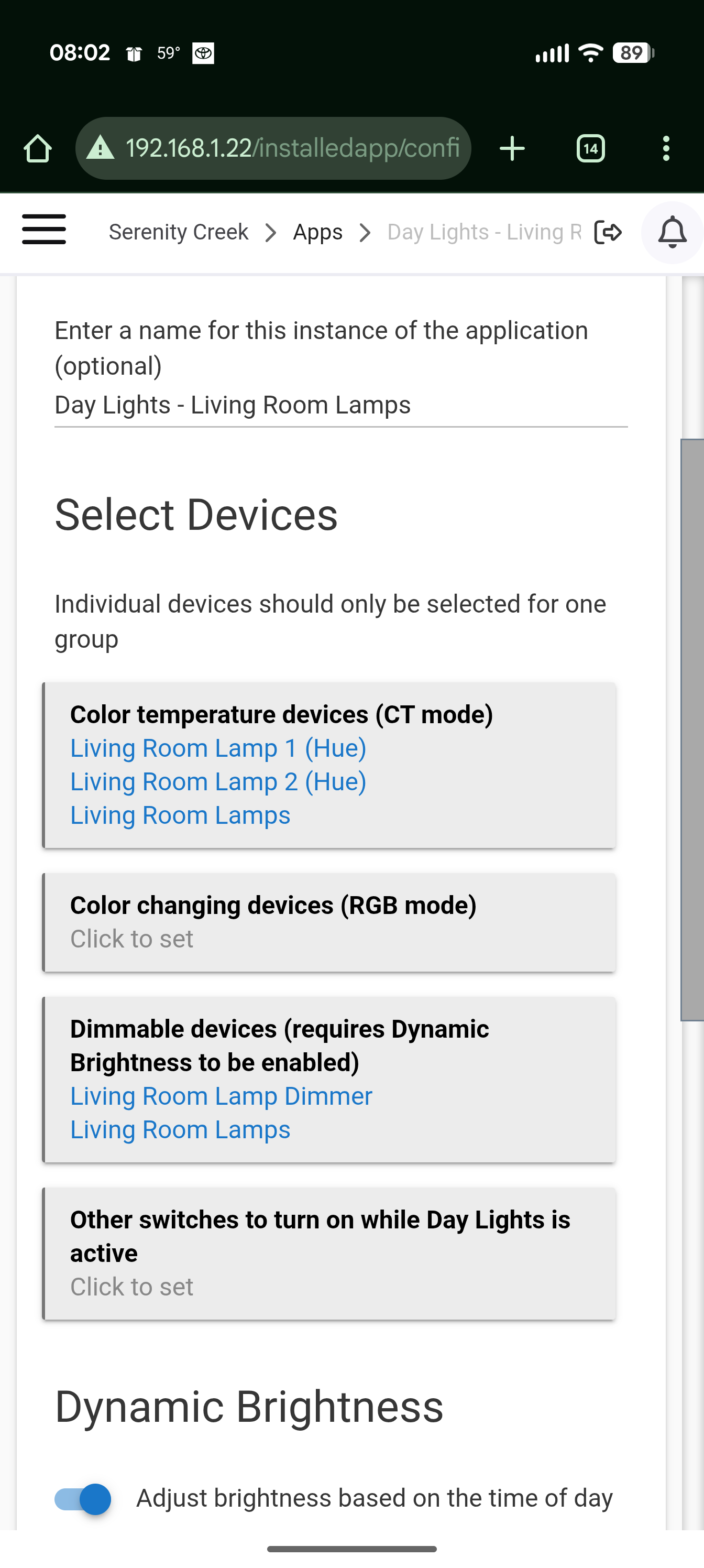

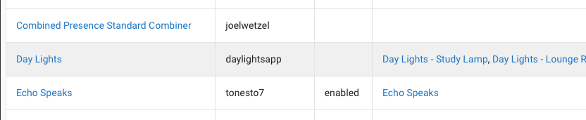

I would love to see Day Lights updated to do the following:
  1. Add device refresh prior to commanding CT or level changes.
  2. Is there a way we can have all our instances of our Day Lights consolidated like Rule Machine, etc?
Thanks!
You have "Living Room Lamps" in both Color temperature devices and Dimmable devices which goes against the guidance that a single device should only be selected in one of the groups.
I also wonder if "Living Room Lamps" is actually a group that contains Living Room Lamp 1 (Hue) and Living Room Lamp 2 (Hue). If that's the case then the guidance is being stomped on mercilessly :smiley: and the actual devices may be receiving some confusing commands.
That's an interesting idea creating a parent/child relationship for Day Lights instances. I took a quick glance at the development docs and it seems doable but would probably result in a whole new app. I might play around with that, but it won't be until after the first of the year.
Correct that Living Room Lamp group contains those two hue bulbs and the dimmer. I will try taking out the group in the dimmable group.
In this setup, the bulbs are receiving each CT command only twice and it is orderly, so nothing confusing. It's just redundant. I actually may remove it because the RM for refreshing off of the variable change is actually occuring before Hubitat passes the commands to the bulbs and that may be what is fixing my loss of sync with the group.
To keep my Inovelli LED bar in sync, I just use [RELEASE] Switch Bindings 2.0. Switch Bindings works really well and I just set the Hue Group as the master allowing for one-way sync. Day Lights sets the Hue color/level and Switch Bindings sets the LED bar.
I would suggest taking your Living Room Lamps group out of both sections and just having the two bulbs in Color temperature devices and the dimmer in Dimmable devices.
I did and I think it is only being reliable because of my hue bulb refresh triggering off of the variable change.

I had used the Group Bulb Dimmer for Google Home and for Day Lights, however if any of the hue bulbs drops its status or doesn't report its status when it turned on, the group shows it as off. Google Home being out of sync has its obvious problems when you tell it turn off. For Day Lights, commands to group device thinks it is off and will not pass it on.
So far my change of not using the group device at all in Day Lights and only having the bulb in the CT and dimmer in the Dimmable with the dimmer in the disable was an improvement, but only with the refreshing of the bulbs when the dimmer state changes, when Day Light CT/level variable changes, or every 30 minutes.
What is nice is Hubitat prioritizes RM over Day Lights so once the variables change, it executes the refresh before Day Light commands the bulb.
I overlooked the fact that your dimmer device is controlling the level of the bulbs in the CT group! So your bulbs are getting a CT and level command from Day Lights, and then your dimmer device is getting another level command from Day Lights which is then (redundantly) passed on to the bulbs. In theory you shouldn't even need the dimmer device specified at all in Day Lights.
You are correct that Day Lights does not send any command to a device that is off. I don't have any Hue bulbs, but it seems unusual that they would drop their status or not report their state.
