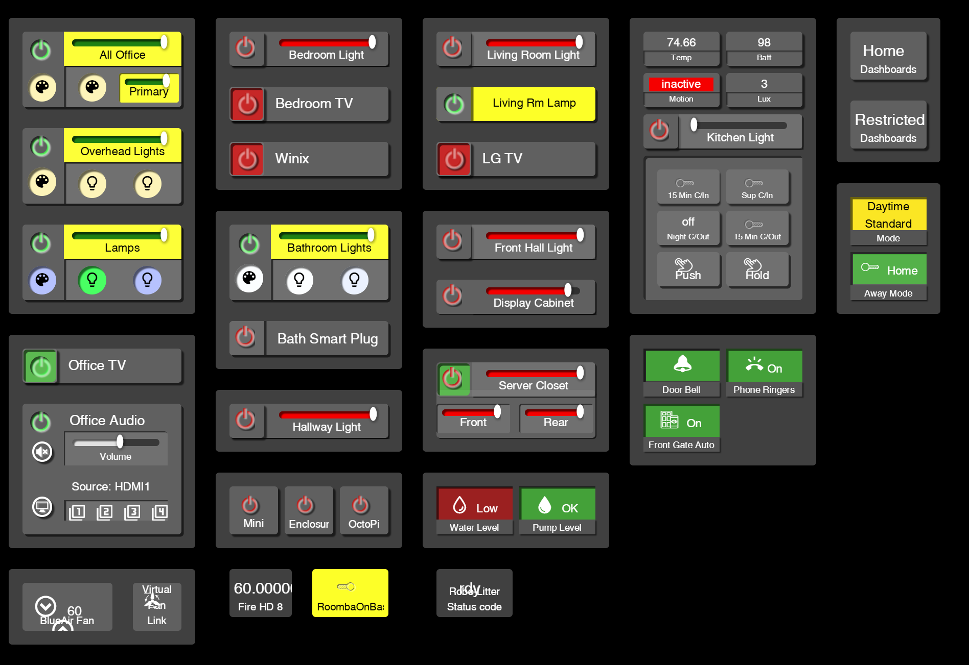

I’m not sure if I understand what you’re asking. But here’s my test dashboard. The grid is 100 x 80. Every tile spans quite a few columns and rows. All of these tiles are overlapping and nested and kind of absurd but of everything I came up with, this was the type of interface that got the spouse to budge on having any of this. So I make the spouse happy. But image with all of those tiles how much work moving just a few devices could be. So the app is designed with the probably not smart assumption that anyone who was likely to find this useful, was also layout out spanning tiles.
I’d say give the GUI a spin because nothing in the GUI is live until you actually save it and the back end logic is the same. Plus the GUI version has undo/redo stacks.
As far as stacks, neither the cli or the gui versions can create original tiles. They create new tiles by copying existing tiles (with new ids and transfered css) but you still have to add completely new tiles via the hubitat gui. So I just add tiles one on top of another and then use the cli or gui to unstack and space them out. From there its easy to resize and arrange them as I need.
You wouldn’t believe the number of dashboards I have that are almost identical but exist so that the flow makes sense to the one who matters. So what I use the CLI the most for is to copy a new cluster of tiles that make up a new device into all of the other dashboards. It inserts the copies in each dashboard and gives them and their CSS a non-conflicting tile-ID. If I’m doing just a few, I’ll use the GUI version because that one will verify the devices are allowed in that dashboard and add them if their not.
Hope that sort of answers your question.
