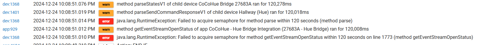

Started getting these in the Logs after today's HE update:

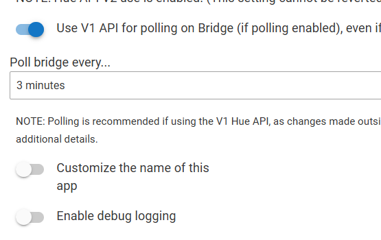

My settings are as follows:

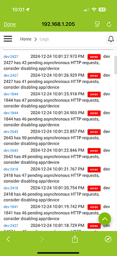

And I found this after my Hue motion sensors stopped working. Forcing a periodic refresh seems to help, but not 100%.
What could this be?
Thanks!
EDIT: some more errors from the Log:

Unfortunately I also started seeing these errors during the last few builds of 2.4.xxx beta, was hoping it would be resolved before release, but doesn't look it was.
@bertabcd1234 is aware of them, hopefully a fix will come soon. Rolling back to 2.3.9.xx was the fix for me.
I think there are platform changes behind the recent appearance of these issues, but I'm trying to figure out what those might be.
In the meantime, I've released an update, CoCoHue 5.2.3, with some minor enhancements that may (or may not) help. There should be no functional differences, mostly internal changes that use a cache fetched from the bridge more than retrieving new data from it every time, especially when adding or searching for new devices and similar operations.
