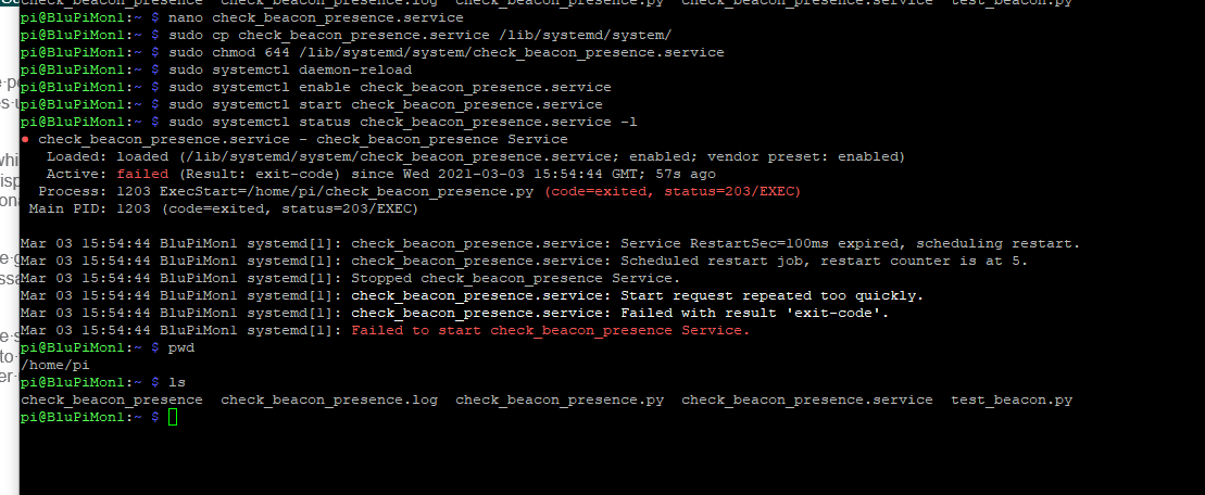

Hi All, im really struggling with getting this last stage to work, i keep getting this error (below) ive created the directory structure, at least i think i have as the service file needs: home/pi/git/BTLE-Presence. and put all the files in it.
I install the service file, but im certain it needs to be in the root not the BTLE -Presence directory, but that shouldnt make any difference for testing it should it?
which directory should i install this file in?
tried installing and running from here still not cigar!

thanks for getting back to me. here's the errors that im getting, from what i can see there's some sort of permission issue, but i don't know what.
I've set up the file system as you told me, home/pi/git/BTLE-Presence. I've written all the files in the BTLE-Presence directory via nano. it all works absolutely perfectly when started manually.
I've written the service directory in the root but tried it in the BLTE-Presence dir as well. running the command you gave above gives the following.
I googled the 2nd red error, and found the problem. the file im trying to execute automatically didnt have the required execute permissions and so i altered the with the command:
sudo chmod a+x filename-or-full-filepath
it all works now thanks.
