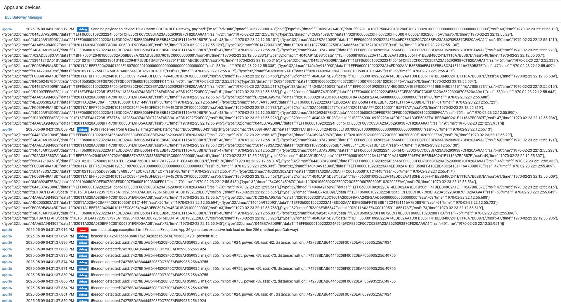

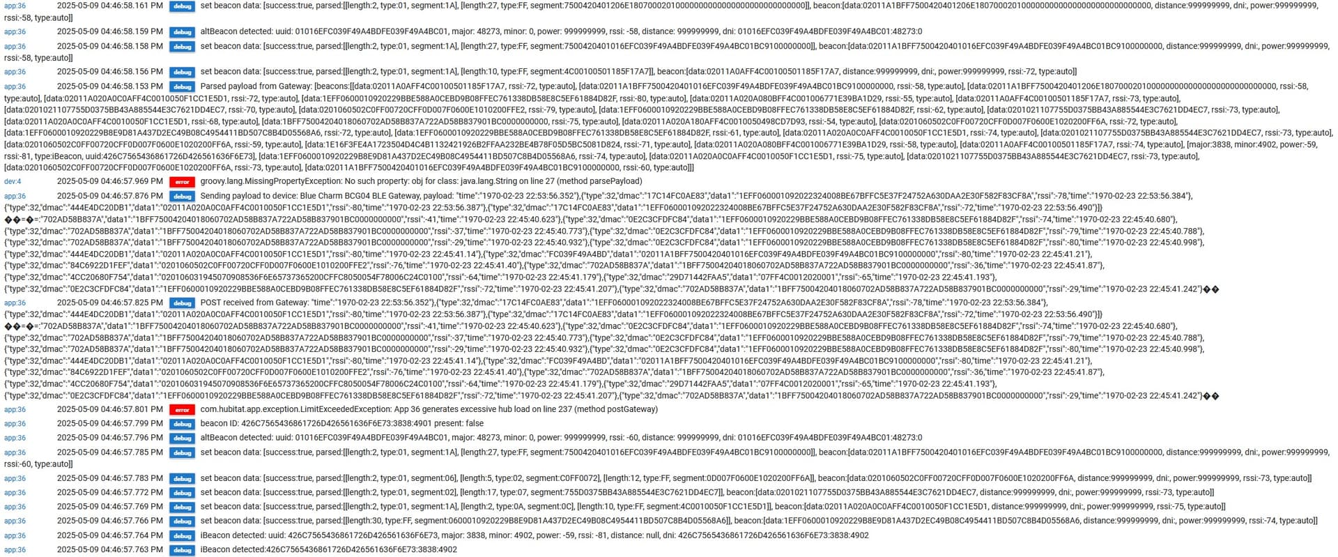

no sooner did i post when i noticed it quit on the new firmware (it may have been dead in my previous screen shot - not sure exactly when it died).
if i reboot it starts working again - but only for 10-15 min before stopping.
log from when it quit...this time with a java error?
  • chris

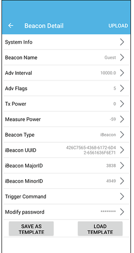

i think i was on the defaults?
looks like my beacons were set to 1022.5ms (adv interval), and my gateways were set to 100ms.
i changed them both to match - both now at 1000ms. that's the max for my gateways - can't set them to 10 seconds.

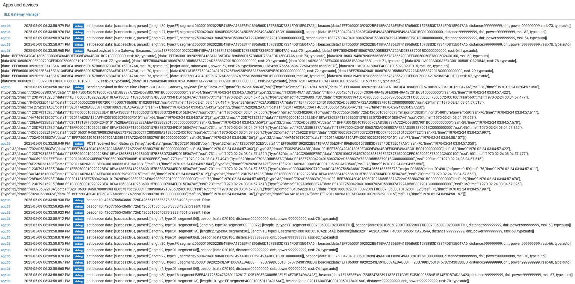

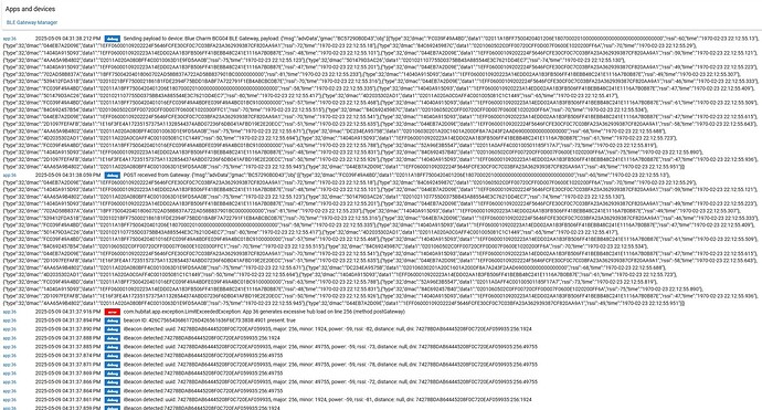

then i tried turning off both my beacons and rebooting the hubitat. the log is still going crazy...so maybe it's picking up other random transmitting devices?
132 debug messages in 1 second with my beacons turned off.
screen shot of a fraction of log with my beacons turned off:

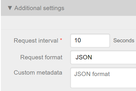

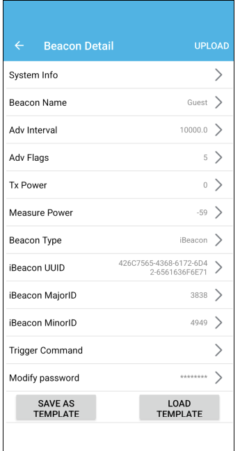

I changed the timing in the tag and the config tool; I have Blue Charm iBeacons and April Brothers gateway.
On the April gateway, you can filter so it only transmits data to the hub for specific devices.
