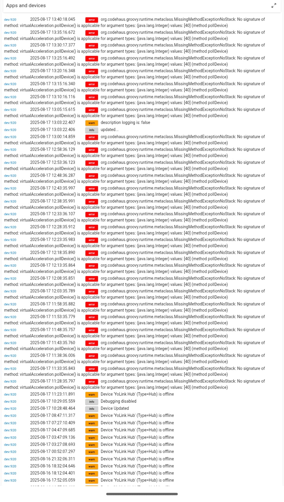

I have just started using Yolink in the past week to use their water leak sensors. I made an update to your interface to have the Yolink names used in Hubitat. I am changing the label to a simpler name that is easy to understand.

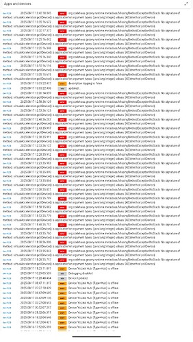

Just after I made the change, the hub started getting an error every time there is an update.
Is this an issue. What can I do to stop the error from occuring?
What does "made an update to your interface" mean? Did you changed the "YoLink LeakSensor Device" driver code, the "YoLink Device Service" app code, or the device's definition created by the YoLink Device Service app? I have never seen a "virtualAcceleration" device created by my code as shown in the log.
Did you create the device by selecting it in the YoLink Device Service app?
What "label" are you referring to? When the device is created by the app, it takes the device driver name and adds the name from the YoLink mobile app, e.g., "YoLink LeakSensor - Leak Sensor" and makes that the device label. You can change the device's label by opening the device's definition on Hubitat and changing the label there.

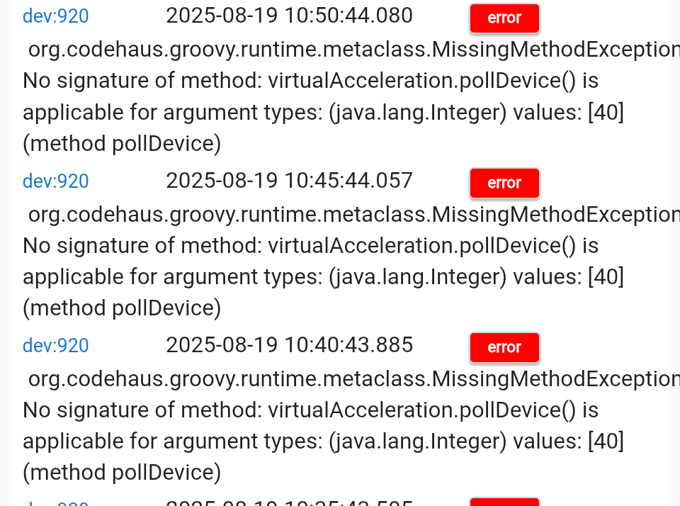

After installing this driver to get my water leak sensors in Hubitat this error message started for the hub device every 5 minutes (the hub scan interval)
It may be related to unlinking the Hubitat device names.
I would suggest the following:
  1. Run the YoLink Device Service app on Hubitat:
  • Uncheck all of the YoLink devices in the selection box.
  • Run the app to completion.
  1. In the Devices list on Hubitat, manually delete any Hubitat devices that are related to YoLink devices (there shouldn't be any).
  2. Run the HPM app and perform a "Repair" on the YoLink Device Service app
  3. REBOOT THE HUBITAT
  4. Run the YoLink Device Service app on Hubitat again:
  • Check all of the YoLink devices you want to install in the selection box.
Look at the logs and see if there are any errors and/or warnings from the YoLink Device Service app. Check that the devices are working.
If you want to change the name of the device, open the device definition on Hubitat and edit the "Device name" and/or "Device label" on the "Device Info" page.
If they are still not working:
  1. Run the YoLink Device Service app on Hubitat again:
  • On the first page, set "Enable Debugging" to "True"
  • Just keep clicking Next to run the app until you get to the "YoLink™ Device Service Diagnostics" page.
  • Set " Enable collection of diagnostic data to local file." to True and click Next.
  • Follow the instructions on the " Diagnostic data has been collected" page to send me the collected diagnostics.
My Hub reports going offline and online at the specified polling interval in the logs and events for the hub device. I am using the recommended 5 mins. Is this normal? Thanks.
