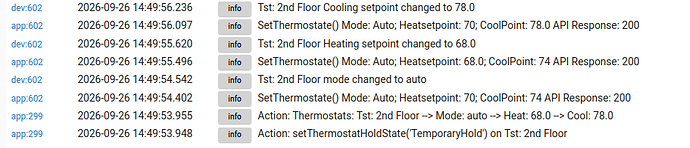

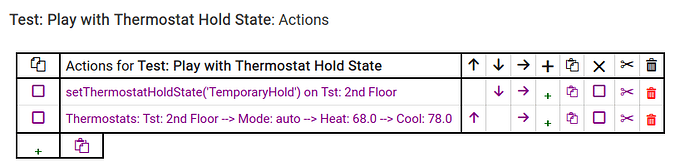

Today I stumbled upon an anomaly, as follows:
If I set Heat- and Cool Setpoints in one Thermostat call, only the Cool Setpoint is actually changed.

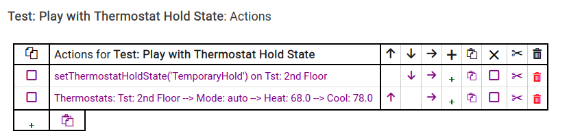

For testing purposes, I created this app:

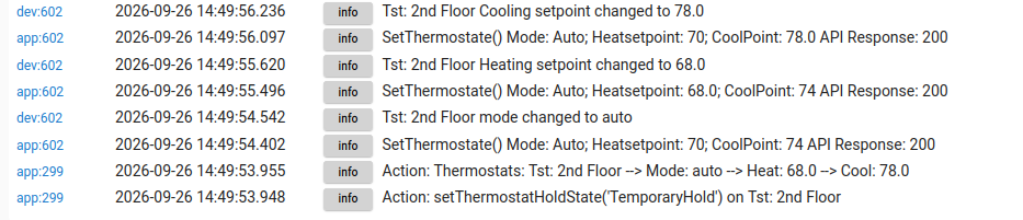

... and this is the log:
After this, the Thermostat Setpoints are at 70/78, not at 68/78 as expected.

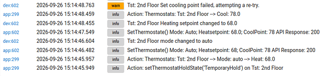

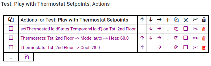

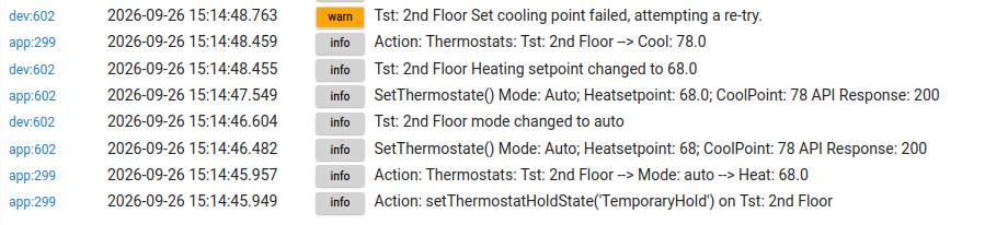

After separating the Setpoint calls
the log shows
and both settings are changed in 80% of the calls.
Any Ideas?
Actually, it's a bug. :slight_smile: I've seen this happen on my own thermostat, but only during cooling season, when I adjust the cooling setpoint. It hasn't been a high priority, as no one else reported it. So, I just took a look at it a couple of times and didn't see anything obvious. It seems to be a race condition. Thanks for the test app and logs. I'll look into this more thoroughly now that someone else is seeing it.

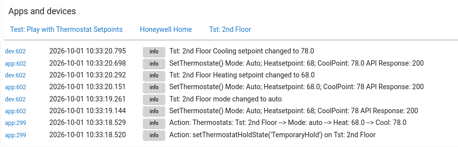

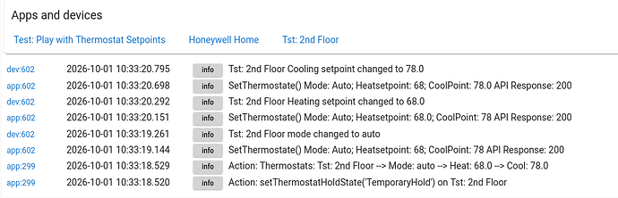

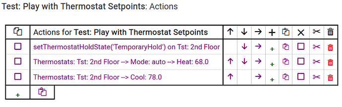

I ran the test:
and this was the result:
So for now, problem solved. I'll keep an eye on it, though.
