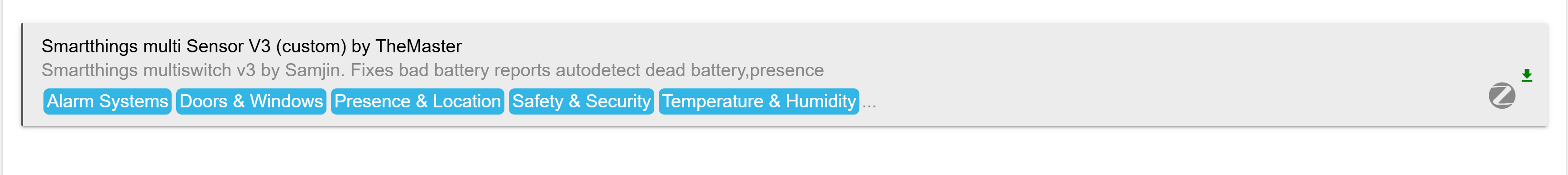

Check HPM and see if someone has already fixed the issue by applying a better curve. I had the similar issue with ST motion sensor- I built a driver with a better voltage curve.

There is one in HPM for this exact issue.

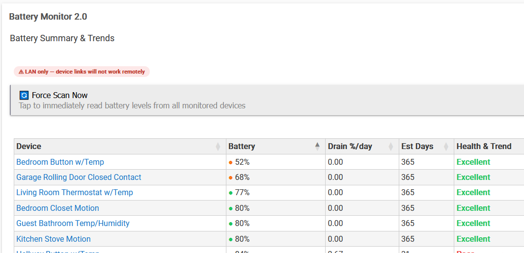

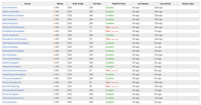

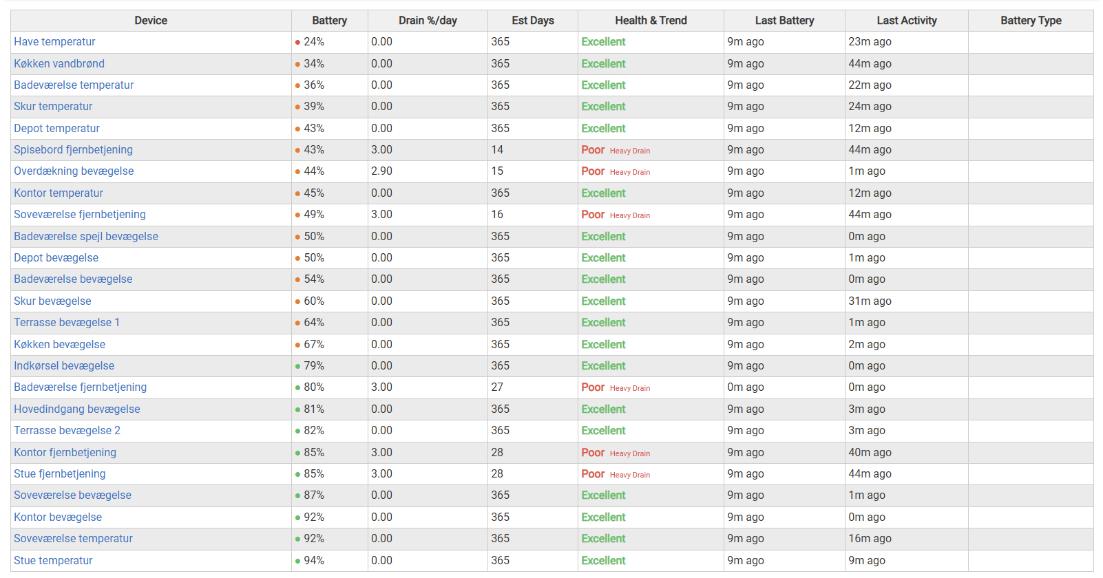

In the screenshot from @jshimota and from my own setup, I can see that it looks like there is an issue in estmating the drain %/day and therefore the Est days gets estimated incorrectly:
A lot of 'Drain %/day' are 0.00 and therefore 'Est days' ends up at 365.
I haven't reviewed the code or data yet, so I haven't identified the technical root cause of this.
If the battery drain pr. day is so low that it can't be measued (even 0.01% is a very low so it should be), maybe a fallback method for the estimation could be done over a week or 10 days? Estimation over a week/10 days would also be a more 'stable' period of estimation, because daily variances are evened out.

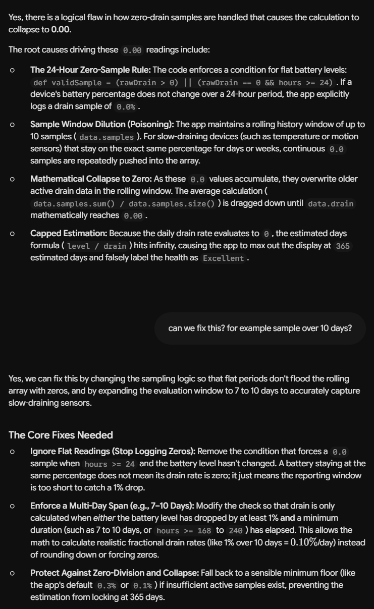

I used Gemini to examine the code and it sure looks like my issue is that the devices use very little power and therefore the 'short' sample period wont catch the low drain (which ends upin 0.00 drain %/day and off estimation of power):
I changed the sample window to be over 7 days to catch these lower power consuming devices. In 7 days I will have a good estimation :slight_smile:

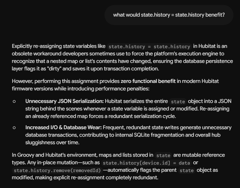

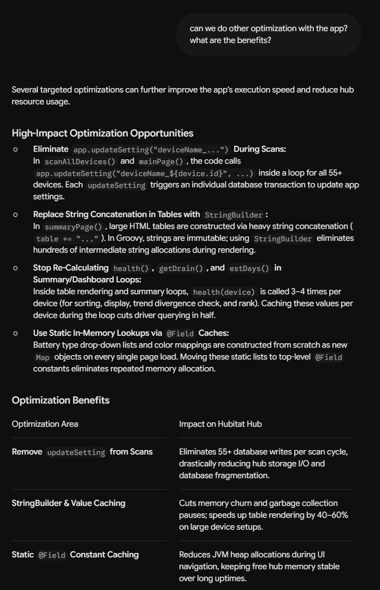

It also identified some other elements that can be optimized in the code for example the unneccessary reassigning of state variables:
and when futher asked about optimizations:

The samples array isn't a straight time-based average, it's a rolling window of the last 10 valid readings (FIFO, oldest drops off as new ones come in). So widening the window from 24h to 7 days makes it more likely a slow drainer logs a real drop instead of a 0, but if a device barely moves in 7 days either, or the driver just doesn't push battery events often, you can still see strings of 0s while it builds up real samples.
Also worth noting:
Gemini's read of the code itself was accurate, but it only had the app code to go on. It had no visibility into what device or driver is actually generating these readings, so it concluded "app flaw" without the one input that would confirm or rule that out. A 0.00 sample is a true reflection of what the driver reported, not necessarily a bug in how the app processes it.

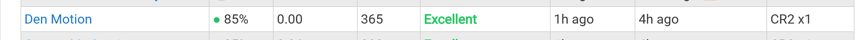

Actually, good timing, I just pulled up one of my own devices showing this exact pattern: a motion sensor at 85% with 0.00 drain and Excellent health. Confirms what we're talking about. It dropped from 100% to 85% at some point (a real sample), then sat flat long enough that those zeros pushed the older real sample out of the 10-sample window. Same mechanism, not app-specific to your device.
Good real-world case for why the 7-day window should help. Let me know how yours looks once it's run a while.

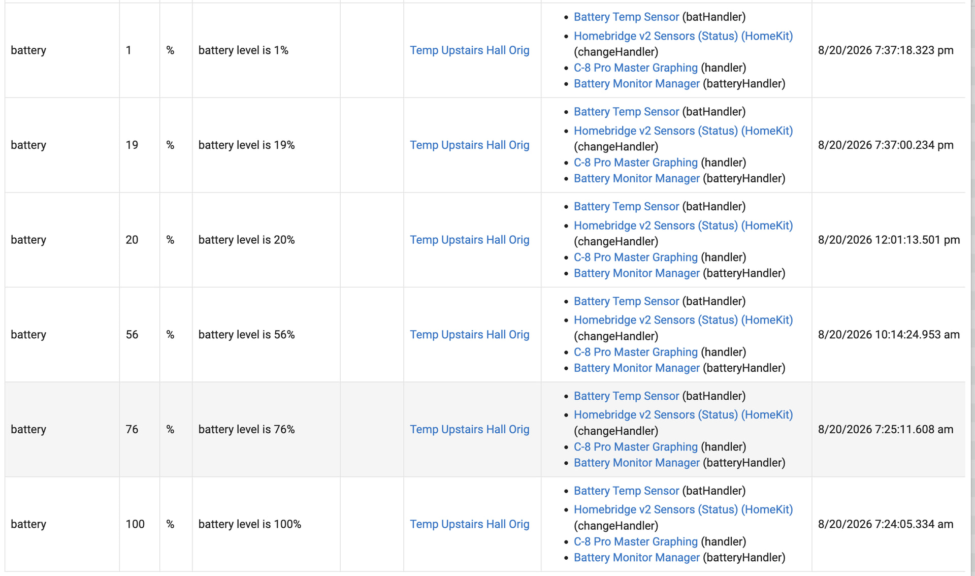

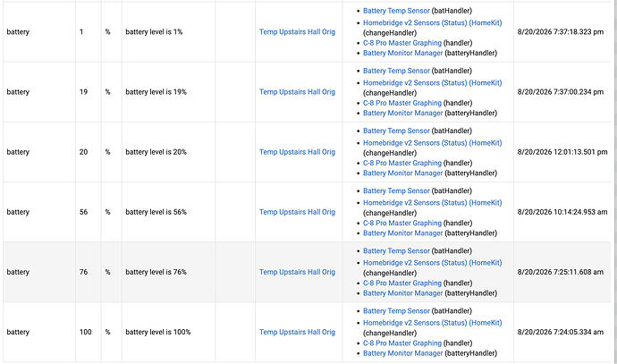

Could a separate/additional handling be added to the code for devices that are defined to use rechargeables? Here is a sensor with a LIR battery that died in a manner that appears textbook to me - sharp, precipitous drop at EOL 12 hours from 100% to 1%. "they’ll report as good right up until they’re not" as you said. If would be awesome if Battery Monitor can pick up that sudden drop and notify us urgently.
Agreed. The crux of it is that every battery needs the type assigned correctly so the app can apply the right scaling and detection logic. This has to be a deliberate, user-owned step, since there's no reliable way for the app to infer chemistry on its own.
Accuracy matters here more than usual though. If a device gets mis-assigned (say, a normal alkaline tagged as Li-Ion), you could get a false urgent alert. Just as important, if an actual Li-Ion device gets tagged as something else, a real cliff drop could go undetected entirely. So if something looks off, the type assignment is the first thing to check and reassign.
We also need to land on whether this urgent alert should bypass Notification Snooze. Since the whole point is catching a battery that's about to die with little warning, I'm inclined to say it should bypass snooze by default, but curious what others think given that changes expected behavior for anyone currently relying on snooze to go quiet.
