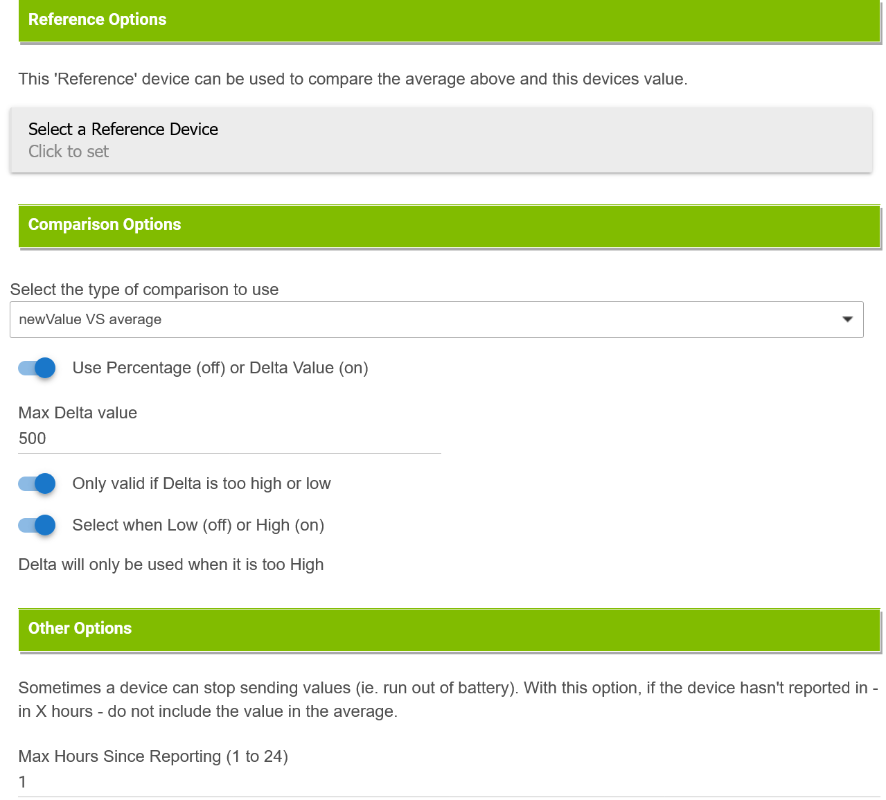

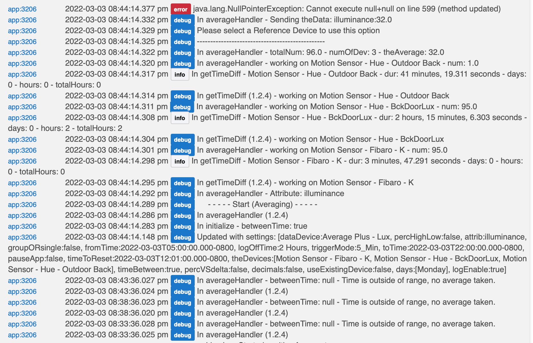

I'm also seeing this error in the logs. I'm not using a reference device. I just need to average several devices. I'm not seeing the "please select a reference device to use this option" in the app. It's only in the log. I'm not sure what high/low setpoints are being referred to in the post above.
app:3572022-03-03 23:35:46.166 errorjava.lang.ArithmeticException: Division undefined on line 448 (method averageHandler)
app:3572022-03-03 23:35:46.107 infoIn getTimeDiff - vAVE - Lumin - Night - Greenhouse - dur: 15 minutes, 0.047 seconds - days: 0 - hours: 0 - totalHours: 0
app:3572022-03-03 23:35:46.044 debugIn getTimeDiff (1.2.4) - working on vAVE - Lumin - Night - Greenhouse
app:3572022-03-03 23:35:46.036 debugIn averageHandler - Attribute: illuminance
app:3572022-03-03 23:35:46.034 debug     - - - - - Start (Averaging) - - - - -
app:3572022-03-03 23:35:46.030 debugIn averageHandler (1.2.4)
app:3572022-03-03 23:20:46.149 errorjava.lang.NullPointerException: Cannot invoke method minus() on null object on line 538 (method averageHandler)
app:3572022-03-03 23:20:46.100 debugIn averageHandler - percentage 3 - newValue VS average - newValue: null - theAverage: null
app:3572022-03-03 23:20:46.098 debugPlease select a Reference Device to use this option

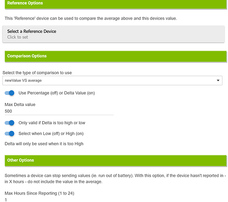

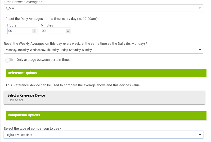

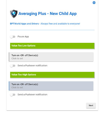

I'm really perplexed. I went to make a new averaging child, and the option to use follow me isn't showing up:
From that last post, that screenshot is after I select "Notification Options".
That section in the child code (line 219) seems to open actionsConfig instead of notificationOptions. I did try to see if switching that href would fix it, but found it was giving me "Unexpected Error" if I clicked on the button in the child app's setup screen.
I clearly know just enough to be dangerous... :confused:
Me Too! :rofl:

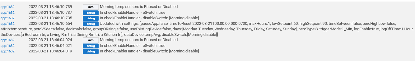

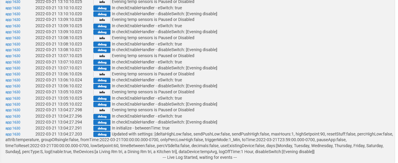

My question is that when the children are disabled, the apps are still logging that they are disabled or paused, and I cannot turn that log off.
here is a screenshot of one of the disabled children with debug turned on:
IS this the correct method to use to stop the children from updating the virtual temperature device?

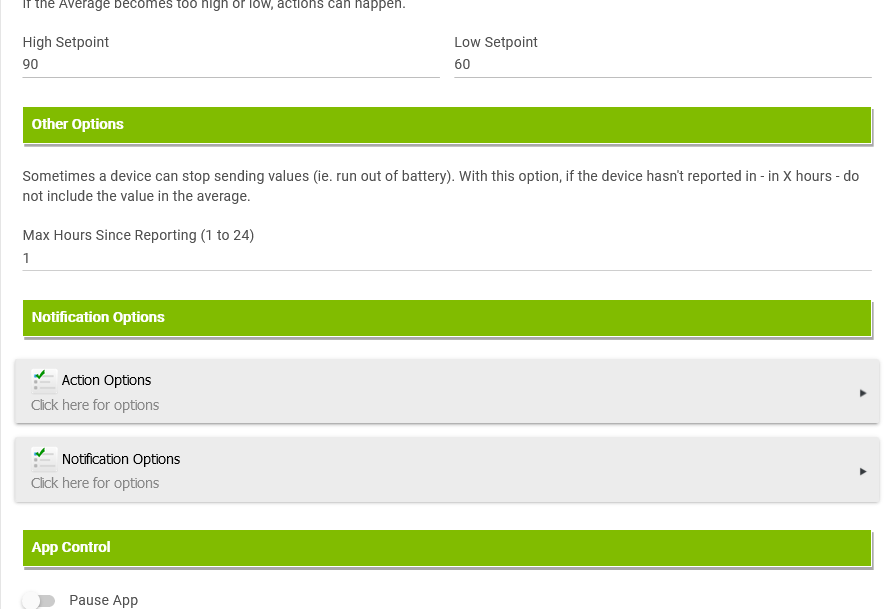

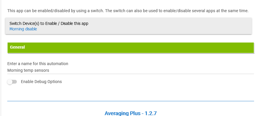

here are some screenshots of one of my 4 children:
I just wanted to stop the log entries so my log doesn't fill up.
Other than this, it is working great!
Nothing to worry about, but I updated the app to get rid of all logging.

Trying the new version 1.2.8 and the log is still updating with the disabled children.
I did open each child and clicked done, just to refresh the app, but it still is logging.
Is there something else I need to do?
Yup, show me. :grin: Need a new log.
Here ya go.
version 1.2.8
New version available...
1.2.9 - 03/22/22 - More logging
After updating, please turn the 'debug logging' on and then off. You shouldn't see anything in the log. If you do, post the log (not a debug log, because we don't want to see that stuff!).
Thank you! Looks great!

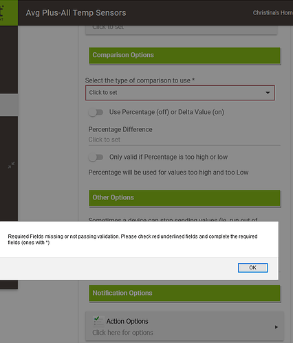

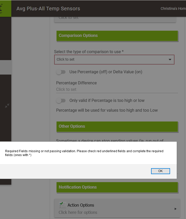

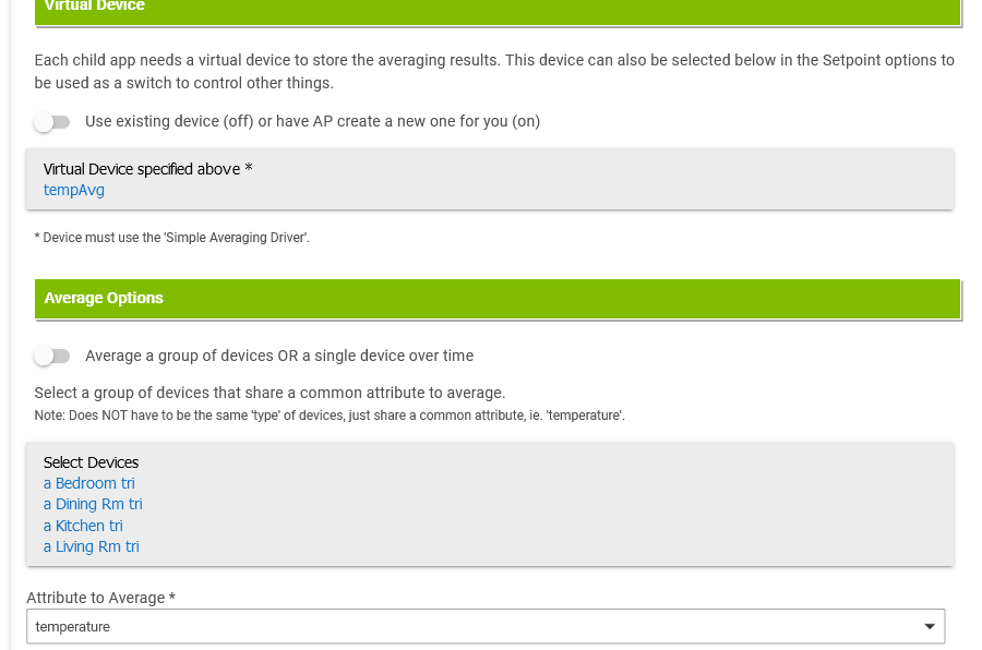

My Average Plus is having problems - I did updates on HPM over the last day or so due to a number of apps/drivers getting updates.
I opened the Child and got:
Required Field Missing ...
There is a comparison field that is set to required - but my previously create child had no such value. I have no reference device, so I have no comparison necessary. If I just randomly choose something, I get the wrong average on my tile.
@bptworld Can you take a look please? I think changing this to be required only if a reference device is there is all that might be needed....
Logs, screenshots available upon request...
You're going to have to show me something. (I shouldn't have to ask)
Thank you for your attention:
In the image, you can see that the comparison field is flagged red as it is Required.
I modified your line 178 of the Averaging Plus Child, changing the field from 'required:true' to 'required:false' and my problem dissipated.
