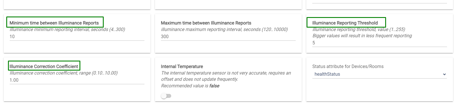

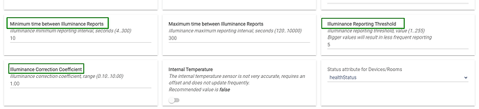

I have pushed some quick fixes in the dev.branch version 1.6.1 - please update manually.
For your sensor lumi.sen_ill.mgl01 (GZCGQ01LM) you can configure these parameters :
Note, that the old XIAOMI illuminance sensor reporting periods are actually not configurable in the firmware! What I have implemented is a software filtering in the driver. So the XIAOMI sensor still sends the illuminance updates over the air. But don't worry, these updates can not affect your Zigbee network, they are probably 20 times less frequent than a spammy Tuya radar..
The newer Aqara T1 Model GZCGQ11LM is fully configurable - the settings in the driver effectively stop the frequent lux updates!
However, the new T1 model is almost twice as expensive as the old one.

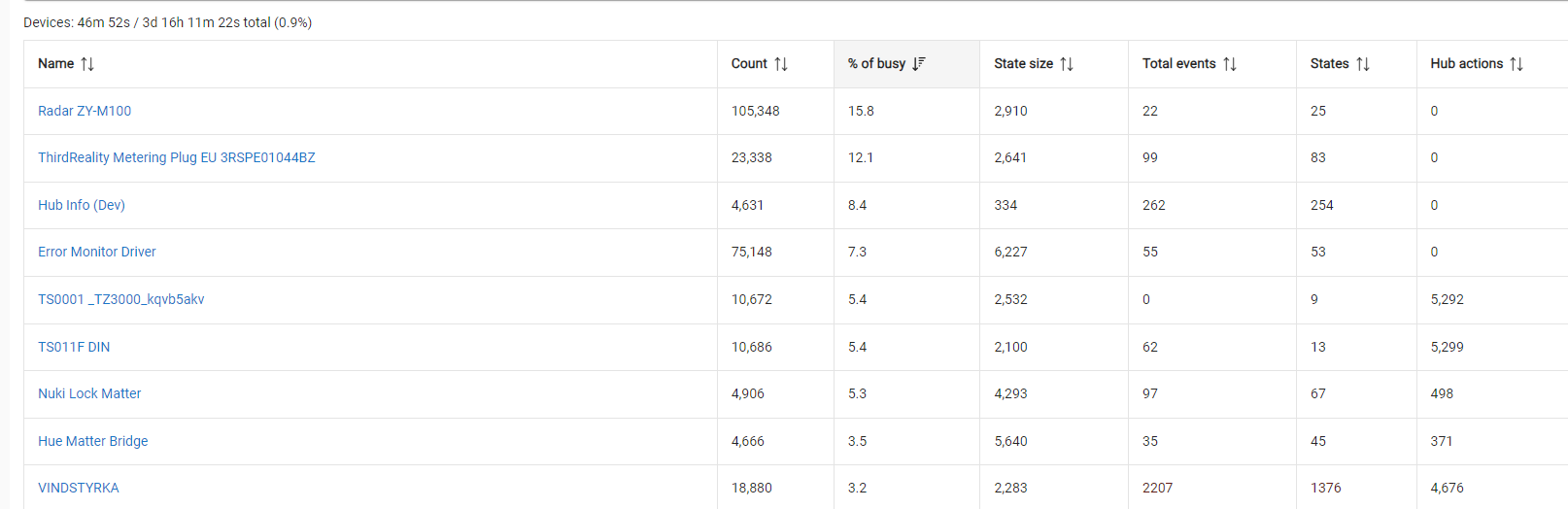

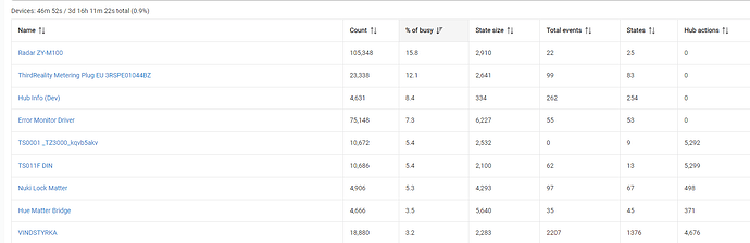

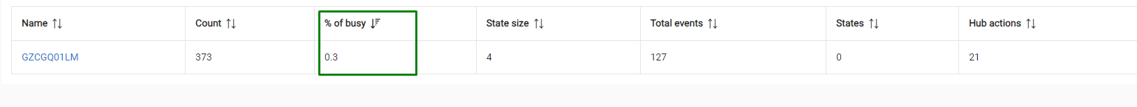

You shouln't worry for this illuminance sensor overloading your hub.
See the GZCGQ01LM stats, compared to the top 10 chatty devices below:
