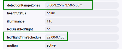

  • FP300: detection range zones
    • Detection Range Zones — configurable between 0.0 m and 6.0 m
    • 0.25 m resolution
    • Up to 24 independent distance zones
    • Each zone can be enabled or disabled individually

    • LED Disabled at Night — Enable/Disable
      Prevents visible light when the room should remain dark.
    • LED Night Time Schedule — Start/End time
      LED automatically re-enabled outside the defined quiet period.

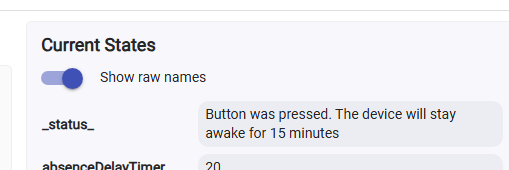

Before saving any Advanced Options on the FP300, press the sensor’s button once to wake it so the changes can be applied successfully.

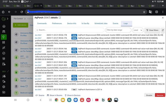

Are you still seeing the “Unprocessed ZDO command: clusterId:0002” debug messages continuously, or do they stop after the device has been paired for a few minutes?

These ZDO messages are typically handled by Hubitat at the system level, not by the driver, and they should stop or become infrequent once the pairing process completes.
@woodsy you can try pairing the FP300 device once again to your hub, at a closer distance. Do not delete the device, just pair it for a second time.
It seems to pair, repeatedly.

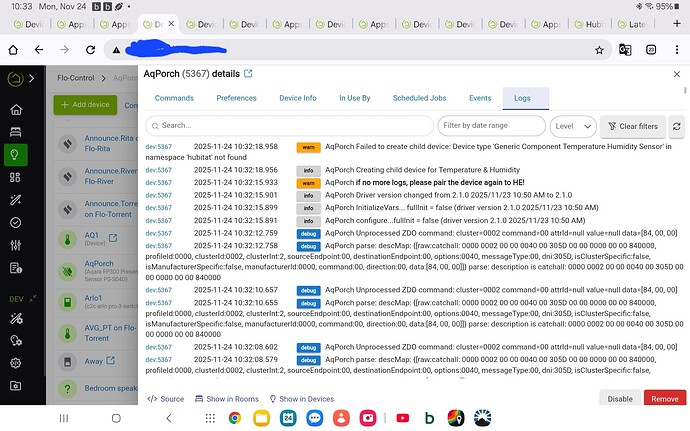

C8P 2.4.1.176 firmware.
This HE platform version was released on May 22 ... The current release version is 2.4.3.158
Probably this is the reason for this error :
and could be the reason for the strange ZDO messages as well.
My advice will be to update your hub to the latest HE platform official release version.

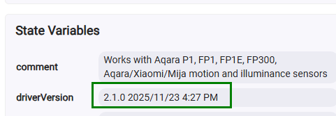

It seems I didn’t successfully push the most recent version to GitHub yesterday… :frowning:
Please update the driver code once more — either manually, or by running an HPM “Repair”.
The timestamp in the State Variables should be '2025/11/23 4:27 PM'

When you briefly press the button on the device, the status attribute should display this prompt for one minute:
When the device is successfully paired and awake, clicking on the ping() button should update the RTT (round-trip time) attribute after one or two seconds.
