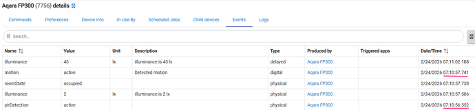

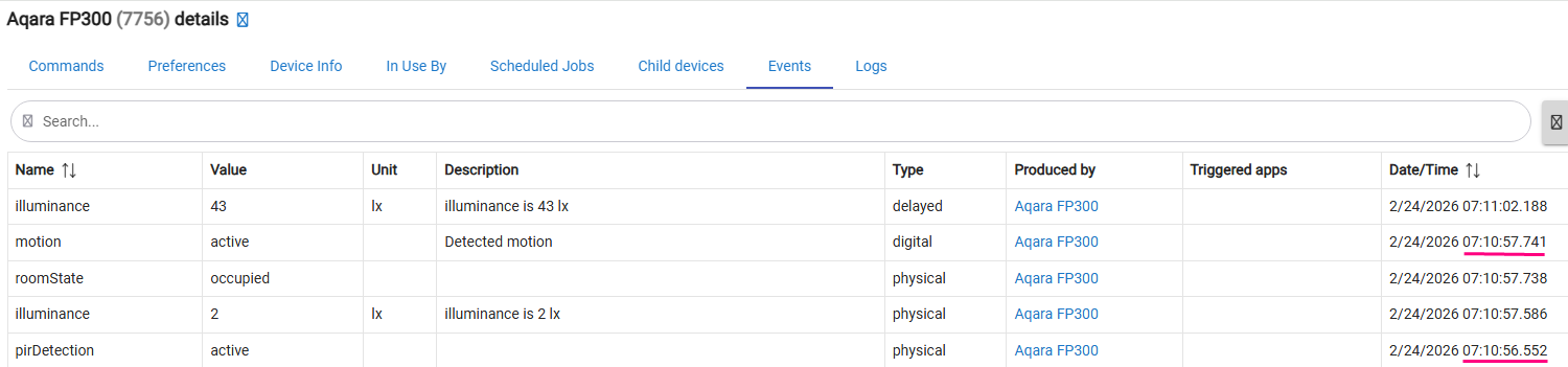

It is interesting that you bring this observation up today. :sunglasses: I recently received my second FP300 sensor and decided to try pairing it directly to one of my Hubitat hubs via Zigbee. My original FP300 is paired directly to an Aqara M3 hub via Zigbee, and then to Home Assistant via the M3’s Matter Bridge functionality, and finally to Hubitat via HADB.
So, during some testing today I believe I may have found the same issue you mentioned above, but I am not 100% certain. From my quick testing, it appears that the pirDetection sensor is not being used by the driver to trigger the standard “motion” attribute. Only the roomState (mmWave) sensor seems to be controlling the Hubitat standard “motion” attribute. Again, this is my hypothesis, as I do not know if the FP300 is sending three unique events (PIR motion, mmWave Occupancy, and combined “Motion”) OR just two unique events (PIR Motion and mmWave Occupancy.) If the latter, then the driver would have to perform the proper logic to combine PIR and mmWave to properly report Hubitat’s “motion” capability.

Hi Dan,
You are correct. In the latest version of this driver (2.1.1, released on 2025/12/30), the pirDetection sensor is not used to trigger the standard “motion” attribute. As a result, the 'motion active' event is delayed by nearly one second.... :frowning:
I will review the code as soon as I have time this week and will update the driver.
