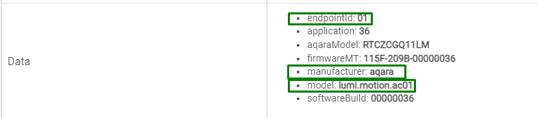

I added the Zigbee device, selected the right driver, and added the device again. The logs are below. It was awesome to see "present
" in one of the lines, but "unknown device null
", empty commands array and UNSUPPORTED attribute
are worrying. Also, I don't see motion
as one of the state attributes; it only has powerSource
(which is wrong, BTW, it shows "battery").
