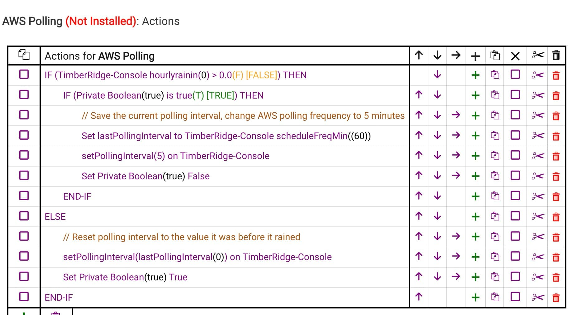

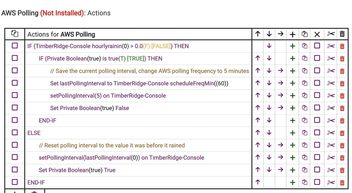

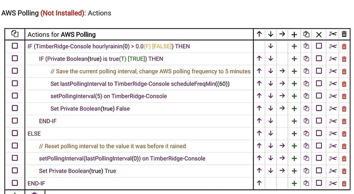

Example Rule Machine:
Thanks! Downloaded the update. Now I feel silly...I don't know how to change the polling frequency in a rule.
Ha...Here is an example rule with a polling change:

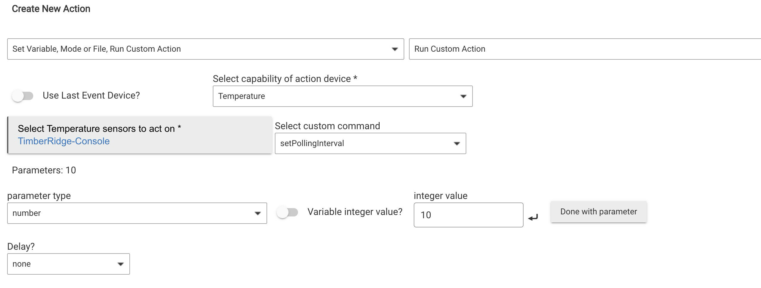

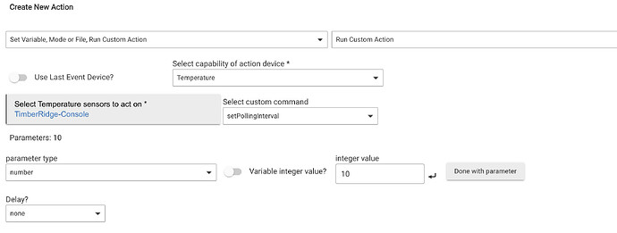

Thanks Kurt. What action category is that under? I've looked everywhere and don't see anything I can use.
The action is Run Custom Action
