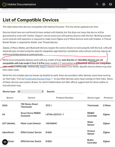

According to the Hubitat docs, those plugs are supported on V8 devices:
Ummm, you may want to read the docs again…
There've been a whole raft of updates to these drivers, mostly chasing efficiencies that weren't the problem of the driver in the first place. But positive changes nonetheless.
