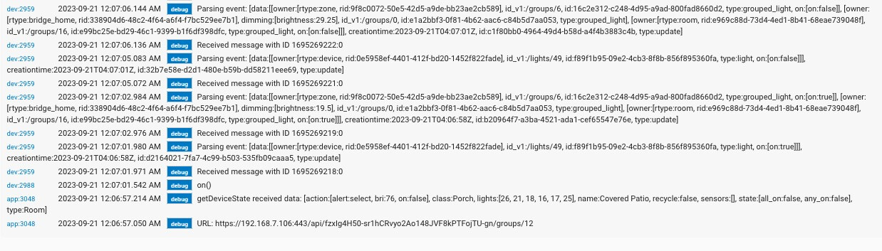

Now, on to the next issue. Every now and then the Hue lights associated with one or both of my bridges just decide they want to be off and will turn themselves off no matter how or how often they are turned back on. I can turn them on via a rule, via the Hue Smart Switch or via the iConnectHue app and they will stay on for no more than 10 seconds and then turn off again.
When I look at the events for the lights, they point at the Hue bridge device as being responsible.
I've turned on both verbose and debug logging for the hub and below is what I'm seeing. I tried it twice because one set of logs seemed to indicate a problem with connection where the other does not.
I can gain relief from the issue if I reboot the hubitat hub but the issue will start again after the reboot cycle completes.
Power Cycling the Hue bridges also does not help.
This issue usually happens at night, and usually after I have run some relatively complicated scenes (I craft all my scenes as hubitat rules and then invoke them via virtual switch so I can change/control everything as needed). I've been using most of the scenes for many months now and they are definitely not running at the time the lights start misbehaving.
By the next morning things seem to be OK again.
My wife is sure I'm messing with her as she'll turn on some lights with the wall-mounted hue switch and then they turn off once she's entered the room.
While this issue is going on today, it is affecting ONLY hub bridge 1, lights on the 2nd bridge are working normally.

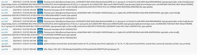

This is my unfiltered log where I am turning on a single light using a hubitat dashboard where the light subsequently turns off again after about 3 seconds. Pretty much all of my rules have logging enabled for exactly this kind of issue and I don't see anything interfering with the Hue light.
If anybody can make this make sense I'd appreciate it. I really do not know what I'm looking at here:
I can provide any logging needed to help fix this.

The way the system is supposed to work, is that the code never commands anything on/off based on parsed data from the hue hub. It can be the hue hub has an automation that is turning it off, or that some other automation in the HE is turning it off. It's possible my code is doing it, but I cannot foresee what that might be, because I should never be sending on/off event to the hue hub based on status change received by the hue hub.
Thank you @armand. So what I did last night was applied the new HE update to 2.3.6.135 and applied your update (1.4.6 I think?) Removed the built-in app/device moved all Hue devices over to the advanced app. Everything seems to be working right now. I'll monitor and report any issues.
This might just be a placebo effect on me, but it seems like the light status updates take longer to show. ie; If I turn on a Hue bulb with the iPhone Hue app, it won't show that status change in HE for a while. Probably a config/setting on my end. But with one less app/device driver talking to my actual Hue Smart Hub, I could tune the timings more aggressively.
Make sure to turn on the watchdog. When off, the watchdog checks the connection every minute? And when turned on, it checks every 10 seconds. When a connection is reset, the hub device issues a full refresh to make sure everything is in sync.
The hue hub is only capable of a limited number of requests per second, so you want to make sure you aren’t outpacing the hub. As for hue initiated state changes, make sure debug logging is turned off (this is a cpu hog) and watch the logs for on/off events. For groups, hue only sends on/off — no color change events, so I have to query the group to get that. This can result in a lag. For lights, more data is sent but still not everything, so I have to query the lights and groups to update their states here too, which can cause a lag, if the attribute you want is not one the hue provides in the event stream. If you have refresh turned on, don’t be too aggressive — this is just a safety net to try and keep things in-sync in case any messages failed to process. I use 10 minutes.
If you have not done so, you may want to reboot your hub to drop any erroneously running code from working memory that does not automatically get cleaned up by updating drivers and apps.
To narrow this down, watch the logs and see from turning on a light to the log caching it was turned on, how long did it take. If you have rules interacting with the integration — like reconnecting, or forcing a refresh, this can slow things down. Now that the watchdog timer is working correctly you should trust it to do its job naturally. Sending alert messages when the system goes offline and doesn’t go back online within a tolerance of 20 seconds would impact performance much but if doing it immediately, and if you have network issues that cause frequent drops, then this can overload the HE hub
