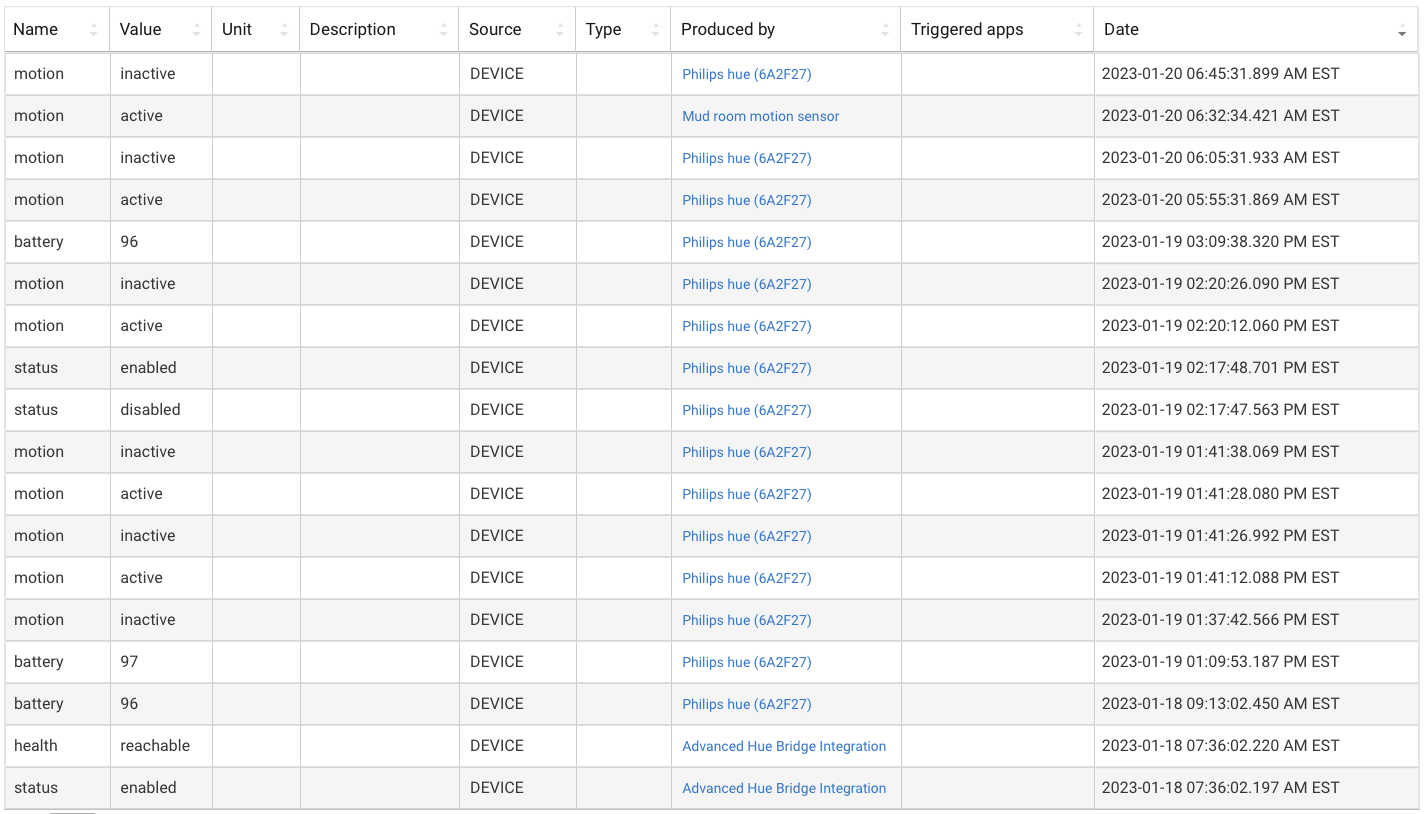

@armand When I compare to the app it does appear that my original assumption was correct regarding the sensitivity levels.
However, since installing this latest update the motion sensor is not apparently firing. I am in the process of moving all devices from my legacy homeseer. So I have the hue plugin in homeseer and it is working fine. Also in the app I see the motion sensor activating. Yet in Hubitat I get nothing - log below - during this time it triggered multiple times in Homeseer. Incidentally I did try testing with Homeseer disabled in case that was causing an issue.
I only just installed this integration two days ago, before updating to the version with the sensitivity adjustment yesterday. I initially moved the sensitivity to 0 - but when I noticed it wasn't working this morning I returned it to 1 - the default.
Happy to do more testing? Thanks.

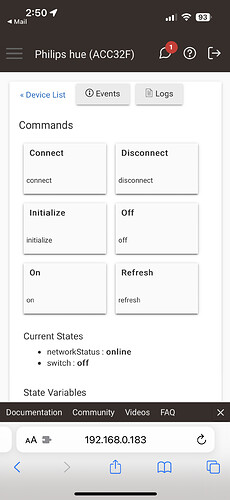

Please go to your bridge device and issue a refresh, then press the connect button. it may have lost connection with the event stream.
@armand When you say press the connect button. Are you referring to the setup button on the back for the motion sensor or the button on the top of the hue hub? Thanks.
The connect button in the HE device for you hue hub
Got it. That solved my problem. Thanks.

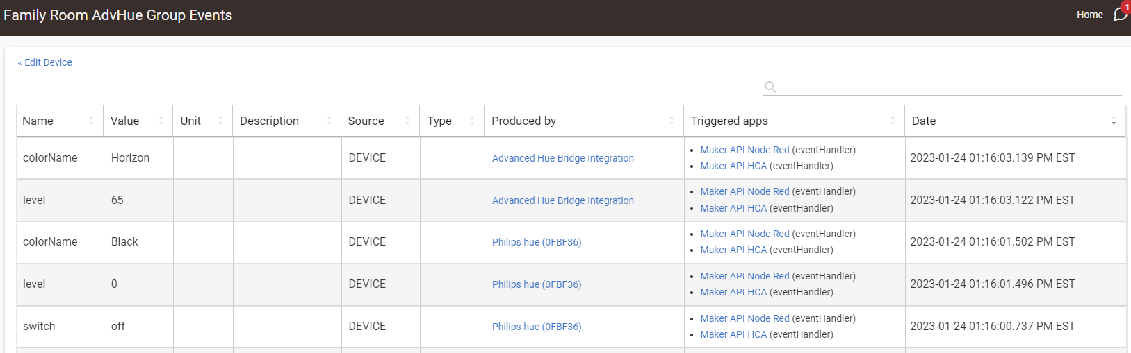

Hi there -
I've found this integration really excellent but I'm running into a particular issue. I'm using Maker API to communicate the state of my hue groups to another application. This integration seems to update group state faster than the native hue integration which is great. However, when a group is turned off, the events sent via Maker API cause the group to show as off and then immediately back on. I think the issue is that after an Off, a level is sent even though the group is off. That comes across as the device being on, so in my receiving app, the device turns back on immediately.
If you look at the events, you can see that when the device is turned off, it reports a level of zero, but then follows that with a level of 65 - which was the level when it was on. I think this is the reason the device appears to go back on.
What is commanding the group to turn off? In Hubitat, setting a level to any value other than 0 turns on the device, so I follow this logic to be compliant with capture/restore state actions and the mirror me apps.
Certainly possible there is a bug in my code, but this would be a huge issue and I have not heard anyone complaining, and I don’t have this behavior for any of my groups. As such, I suspect the issue is in whatever’s turning off the group is also sending a level set command which is why my code turns the group back on.
If anyone else is experiencing this behavior, please speak up.

I've got a light that occasionally fails to turn on, or fails to turn off. From the device page I can turn it on an off several times and re-create it. Rebooted the hub too just to see but didn't make a difference. It's definitely a breakdown between HE and Hue. I can toggle it all day long from the hue app without any failure.
When I go back to the parent app, it's showing offline. If I hit connect, it's shows connected. Auto refresh is still set to 1hr.
Not sure if that connected state matters or not. I ran out of time and didn't get to retest the light after connecting it in the parent device.
Thank you for the feedback. The connected state has always been a bit of a challenge. I have to use a Hubitat provided method to subscribe to the event stream. Coupled with this is a support method that informs me when the stream state changes. There is no way for me to query if the stream is connected or not. What happens if that the event stream interface falsely reports many times over that the connection stopped, and if I reconnect it, Inwill have two connections open. When a refresh is issued, the stream does a best effort attempt at trying to determine if the stream is online or not, and reconnect it if offline.
