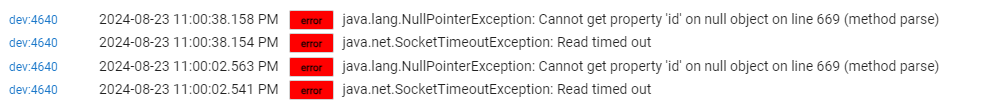

Noted these errors showing in logs periodically:
I checked which log.info was there, and all that should not be very chatty at all. Basically notifying if prefs are saved, if mode is changed, and if the websocket connection is lost or reconnected. All of those should be a much rarer event. If you could let me know what you see more logging so (without debug/trace enabled).
I am aware of some "error" there, and still am still trying to track it down. My adjustment will do a callback URL when it sees a device update. It does this to try to detect what changed. The line 669 would imply that "device.update" is not for the Occupancy. Do you have the trace for the reply? I'm thinking the reply is null, which I can test for, but would need to know what contents it are. I do not have all devices to test with, so am missing some other device cases.

I'll turn on trace logging to see if I can provide more info on the error. Thanks
Sure.... I can add a info switch login then as well. For that one it may not auto turn off, but can be a on or off manually.
PM'd trace logging for the "out of bounds" error. Haven't been able to reproduce the line 669 error yet. I'm using 2 of the abode "multi-sensors" I'm suspect that this may be the culprit. Still trying to recreate.
