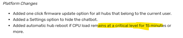

Release 2.4.3.133 Added automatic hub reboot on CPU load Question
In the 2.4.3.133 release im curious about the automatic hub reboot if CPU load remains at a critical level for 15 minutes or more Platform Change.
Is this a single reboot or triggered everytime the condition is met?
Is this disableable?
My concern is, is it possible to get stuck in a ~15min reboot loop if a device/app is misbehaving due to the cpu load trigger? ie Can 1 or more spammy or dying devices cause the cpu on the hub to spike and stay spiked and keep a hub in a reboot loop?
I'll add a disable endpoint.
I'd put it as "extremely unlikely". There are other mechanisms to limit the load that a single app or device can create on the hub, although they're not ironclad.
One, no. A dozen, maybe.
