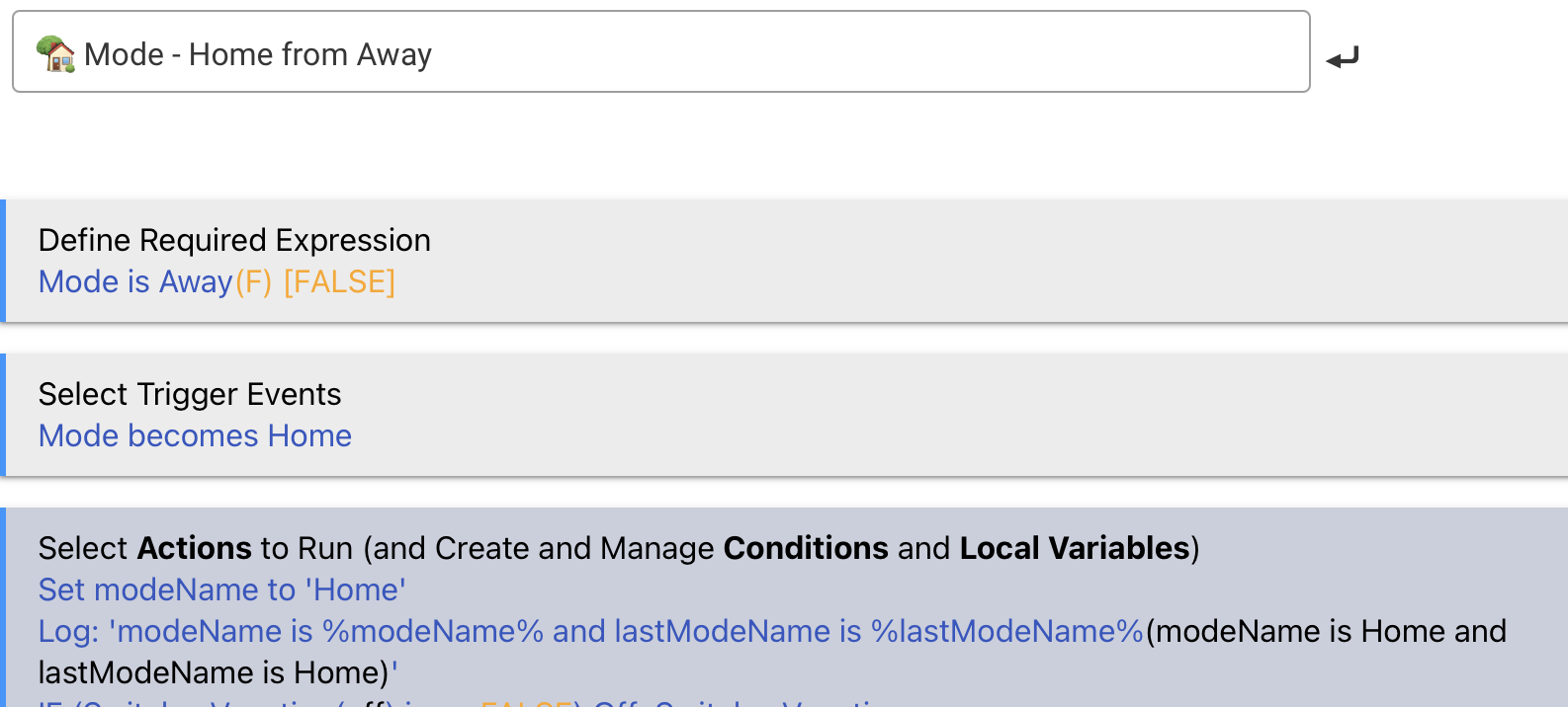

I have several rules of the type shown below where the Mode is one thing and then becomes another. In the example Mode was Away and then changed to Home. And then things happen. Up through 2.4.1.154 this worked great.
Since updating to 2.4.1.255, these rules no longer execute. As far as I can tell the Required Expression is true, but as soon as the Mode changes it becomes false and the actions do not run. There's nothing in the logs so this is guesswork. I've tried "Update Rule" and "Done" but that makes no difference.
For now I've reverted to 2.4.1.254. I'm wondering if this is an intended change or not. If it is, there are a number of other ways I can get the same result and I can make those changes. If not and this was not intended I'll hang tight until it gets addressed.
@bravenel made some changes to address another issue that was related to required expressions. I wonder if that's why your results changed?
OK, this is broken. I will dig into it to find out why....
Fix for this is coming today, in Release 2.4.1.156.

Fix for this released: Release 2.4.1 Available - #7 by bcopeland

Thanks, @bravenel ! That works a whole lot better now!
