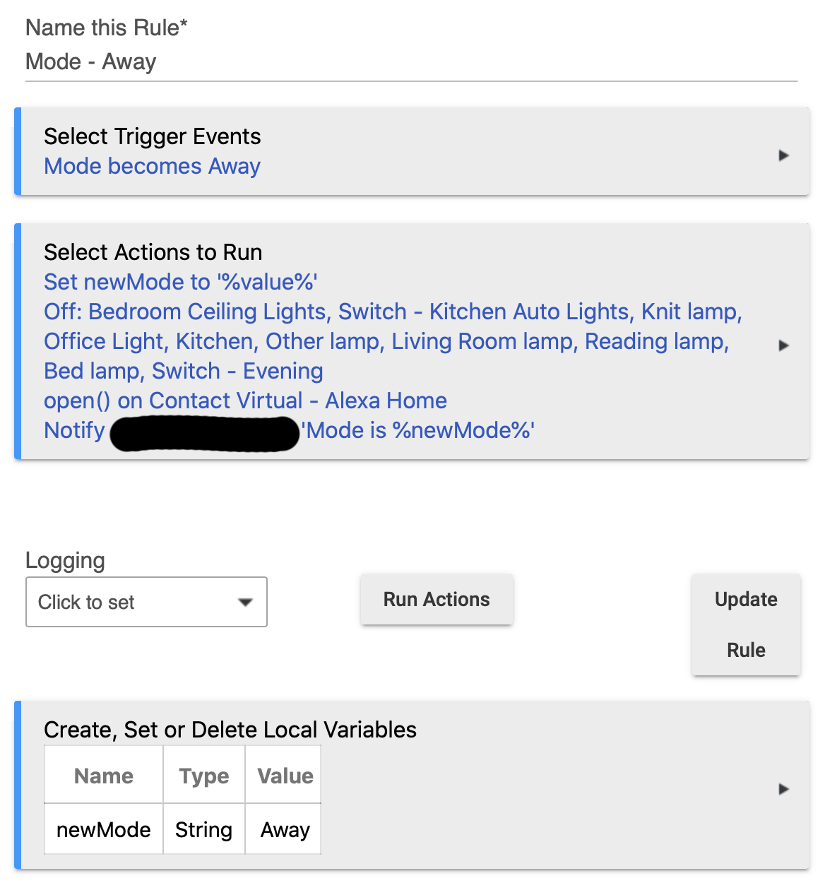

It doesn't have to be a global variable. A local variable works if you only need the mode in the rule that's sending the notification. Here's an example of one of my rules. Note %value% is whatever triggered the rule.
Thanks all. Turns out I had a variable already set. So I've switched to it.
