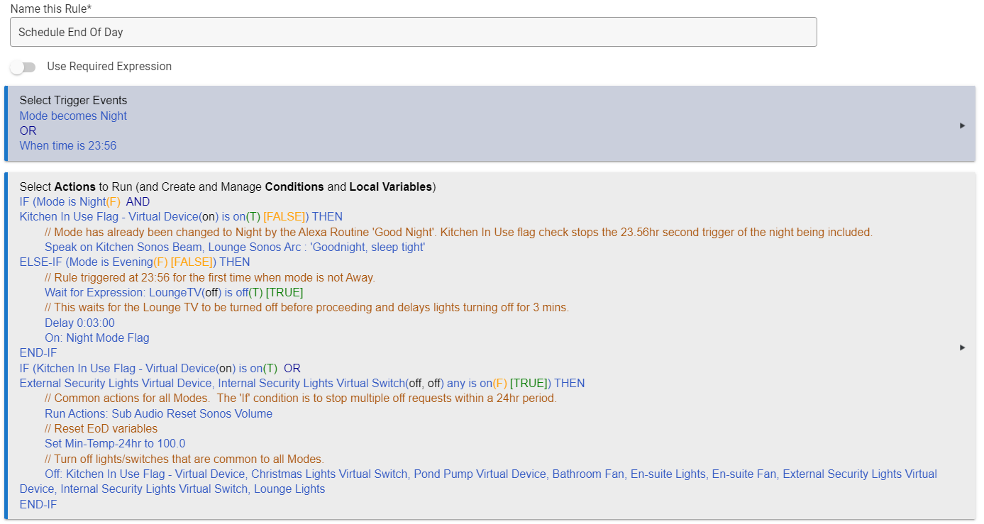

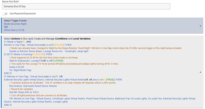

I have a similar problem with my End of Day (EoD) Rule. I've created Groups for different Zones within my house Living Area, Sleeping Area, and Outside. My EoD rule is normally triggered by an Alexa command "Goodnight" but also at midnight, this rule also changes the Mode to Night:
Here is my EoD Rule:
