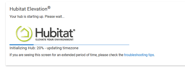

I noticed some of my scheduled morning rules hadn't run and then when I pressed some scene buttons in the home nothing happened. Something was a amiss. I then went into the Hubitat iphone app and it couldn't reach the hub. So at my PC browser I entered the hub IP address and got this screen below where it was stuck.
I tried a few power rebooting cycles but it always returned to this page and stuck at 20%.

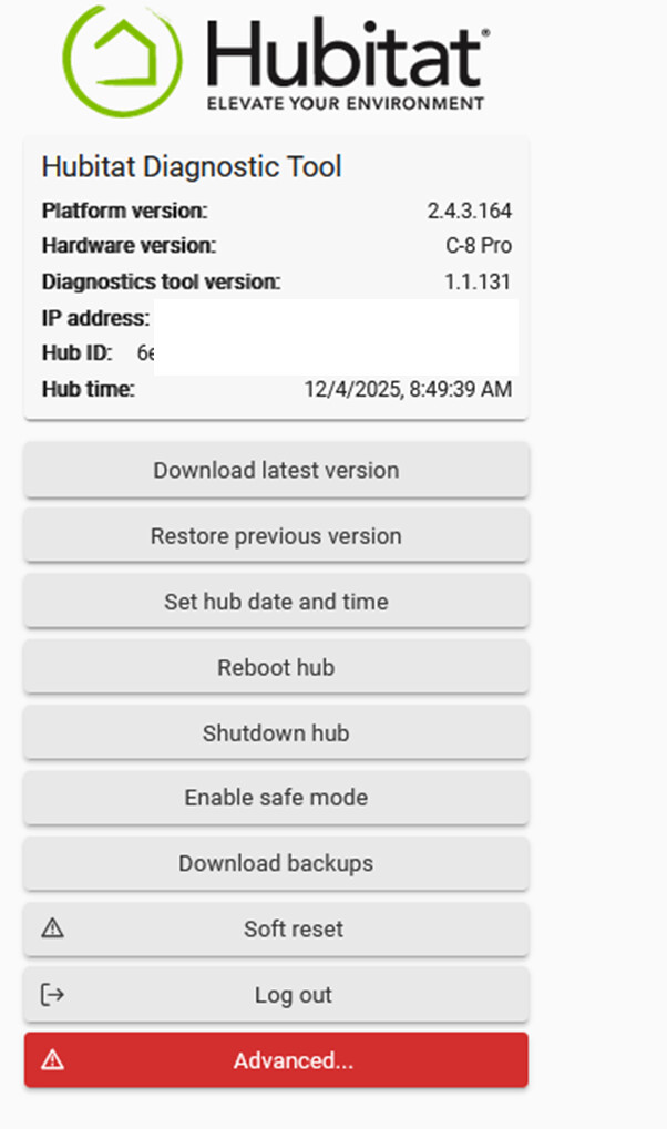

So then I entered 10.x.x.xxx:8081 and then entered my MAC address to get to the diagnostic tool
From here I was able to download to my PC the most recent backup "Download backups".
The after a reboot I entered the diagnostic tool again and selected the "Soft reset" option. It has some extra confirming steps after the button press but then reboots.

The unit comes back looking like a new virgin unit but all the Zwave and radio related stuff is still in the database. It went through an automatic system software update so I had to roll this back (via :8081 diagnostic screen) to n-1 rev to match my backup revision.

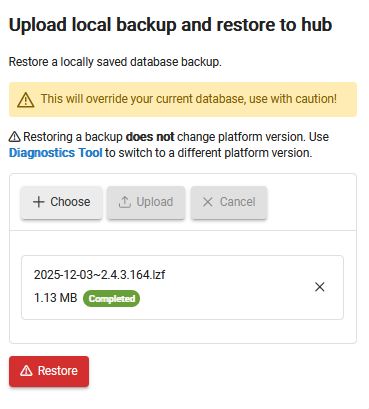

Then navigate to settings, then "Backup and Restore". Here you use the Upload local backup and restore to hub section. You'll be prompted to locate ("+ Choose" button) the backup file on your PC, it will upload to the hub and then you press "Restore" button.
After another reboot you should see your familiar friend again. Test a few devices, run a few rules and ensure everything is working ok.
