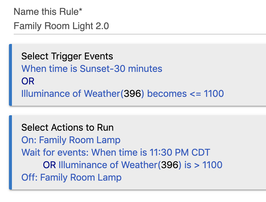

Here is my rule that turns on my lights either at a certain time or when the light level gets below a certain threshold. One issue I noticed is if I manually turn the light off, it will just get kicked back on the next time the rule is checked. Anyway I can incorporate a simple override, for example if I am watching TV and want the lights off?

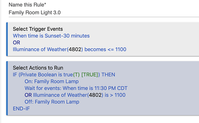

Here is what I have now, I'd love some feedback;

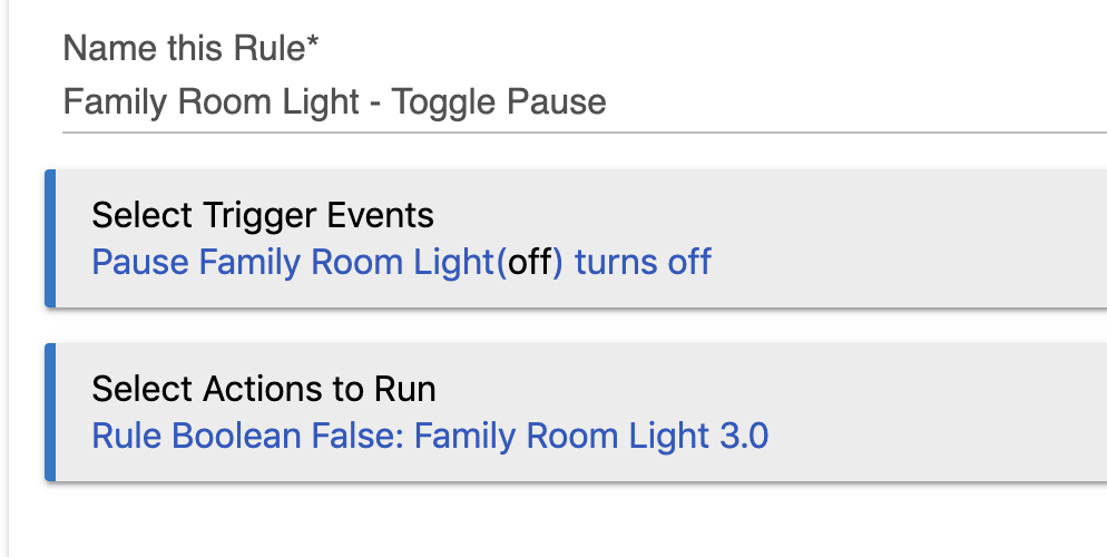

Then I created a new vswitch and the following app.
Edit - This switch was a one time action, how can I set to toggle the Boolean between true/false?
Change your trigger from "Pause Family Room Light turns off" to "Pause Family Room Light *changed*", then modify your rule actions to something like :

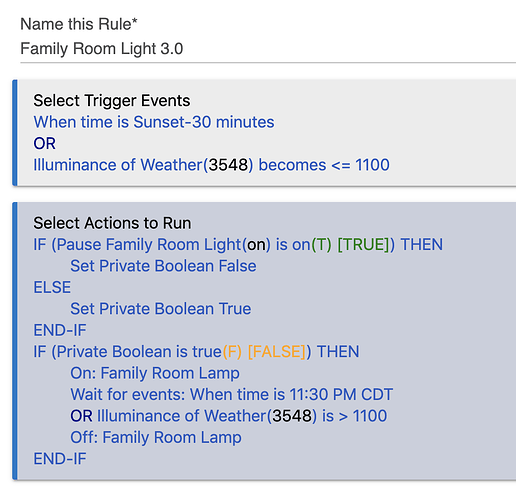

I cleaned up the order, and still have it in one rule (preferred if it works), but I still seem to have an issue with the private boolean.
Here you can see my virtual switch is on, which should set the private boolean to "true", but in the following IF statement the boolean is showing as "false". Is my logic incorrect?
I would still split this rule up into two separate rules as I suggested above: one with "Pause Family Room light *changed*" as a trigger with everything between your first IF...END-IF as the actions, and the second exactly how you have it now without that part (i.e., keep your triggers the same and get rid of everything before IF (Private Boolean is True)).
The issue right now is that nothing toggles the Private Boolean when your "Pause Family Room Light" switch changes. Adding it as a trigger to this rule would make it incredibly messy (you really want two completely different sets of actions to run when this virtual switch is changed versus when your "real" lighting automation runs, so it doesn't make sense to combine them and there's no good way to distinguish that I can see if you mix triggers).

Looks almost right! However, I'd switch around one of your True and False settings/comparisons. Right now, you're turning on/off the lights only when the PB is True, but you're setting the PB to be True when your virtual "pause" switch is on--likely the opposite of what you want. The solution I'd recommend is to change your second rule (Family Room Light 3.0) to check for IF (Private Boolean is false) on the first line (so check for "false" instead of "true"), though technically switching around your other rule would work too.
