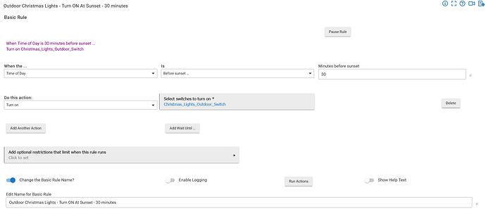

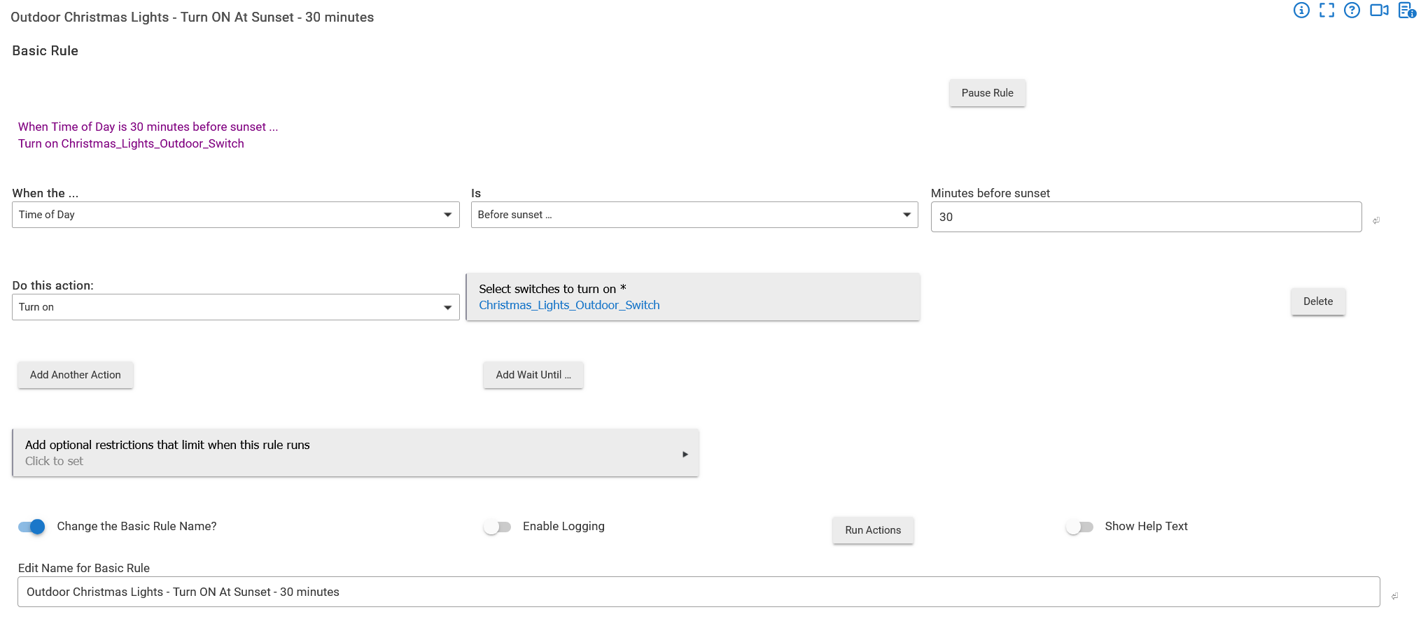

I've accomplished this with Basic Rules, Echo Speaks, RM and webcore. I have not tried Schedule Manager. Lots of options here. I use Basic Rules and webcore. I do it this way so that I will always have a set, timed option. But I can always use Alexa to turn them on and off at will. Honestly, I could just use webcore for all of it. But that is probably more than you want to take on.
Example:
Thanks, but the Simple Run you created is missing a critical component. The rule should not run unless the Christmas Season (vSwitch) is on. I figured out how to add this to a Simple Run and all is good now.
