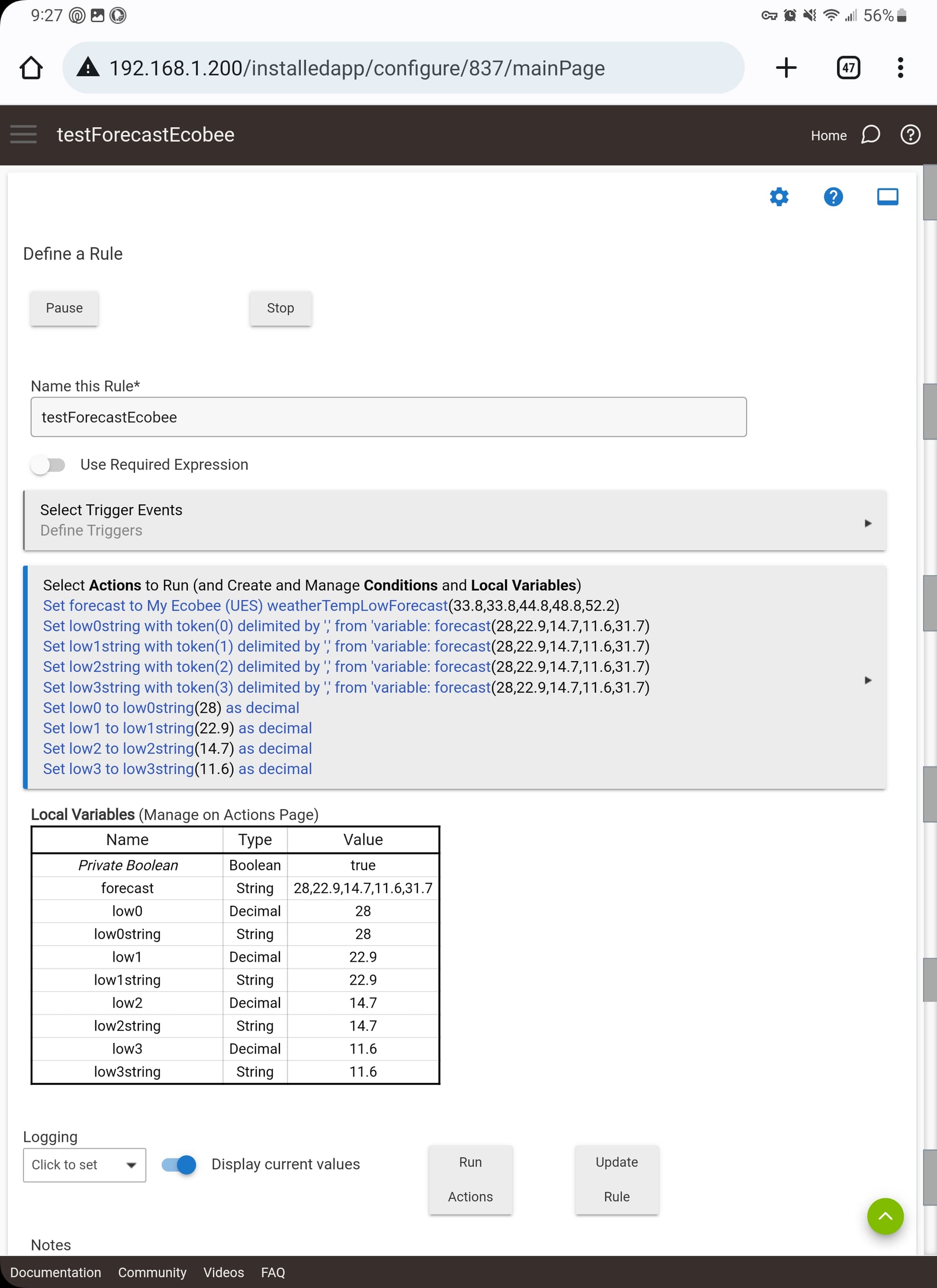

I've only attempted something like this once, but it looks like this. My string is just numbers and commas.
weatherTempLowForecast is an attribute (string csv) from my Ecobee thermostat.
Screenshot_20230502_213052_Chrome
First step was to create a string variable (forecast) and then set the value of the variable equal to the device attribute (first action in the rule).
Then each separate value was stored as its own string and finally stored as decimal-type variable.
How were you able to do this? When I create a local variable I can only enter a facsimile of the string not a link to the actual string I need
You can't really "link" your local variable to the device attribute. You have to use a rule action to read the attribute and then write that value into the variable. The first action in my rule uses the "set variable" command. I can post a screenshot of creating that action later, if needed.
