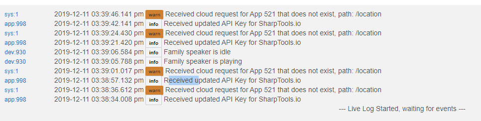

I always get this error after sharptools receive cloud request see below
Hey @wisam.arrakee - I just saw this post, but I believe we got you taken care of in the other thread. :smiley: Feel free to reach out to support@sharptools.io if there's anything else we can help with.
That's correct Josh, I have no issues anymore :slight_smile: thanks for your help.
